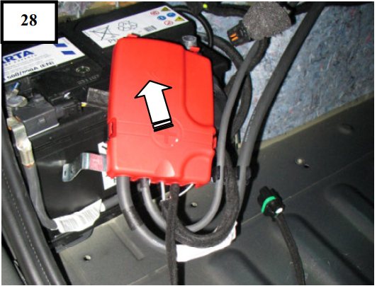

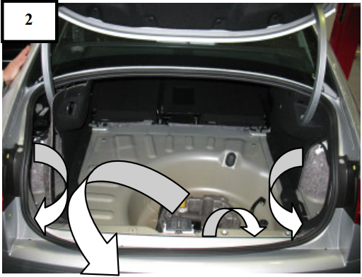

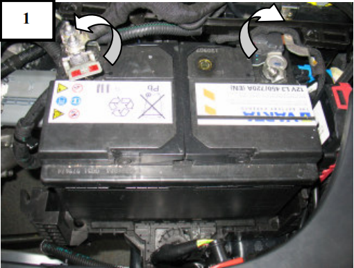

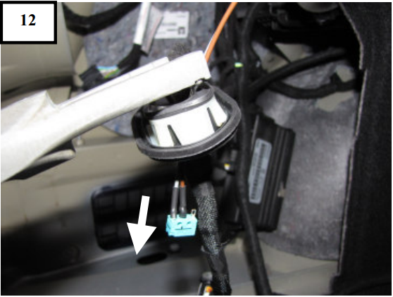

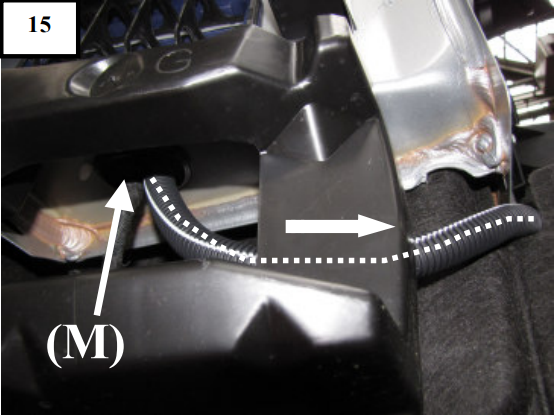

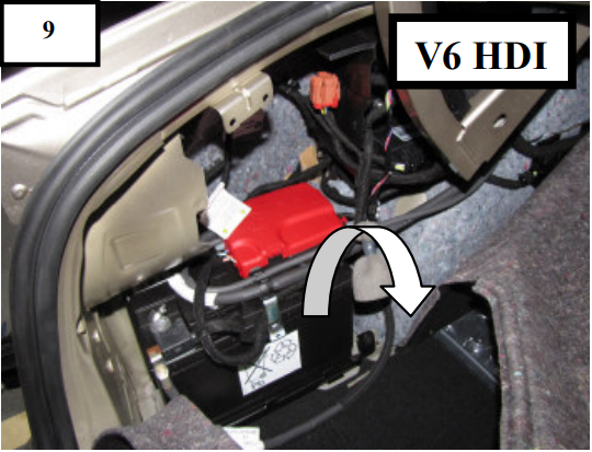

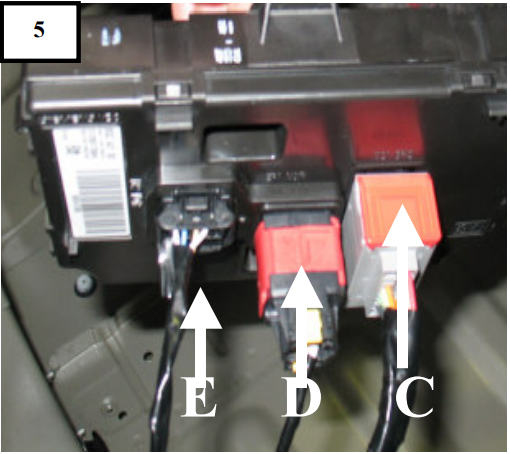

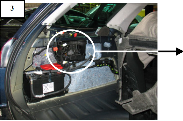

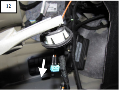

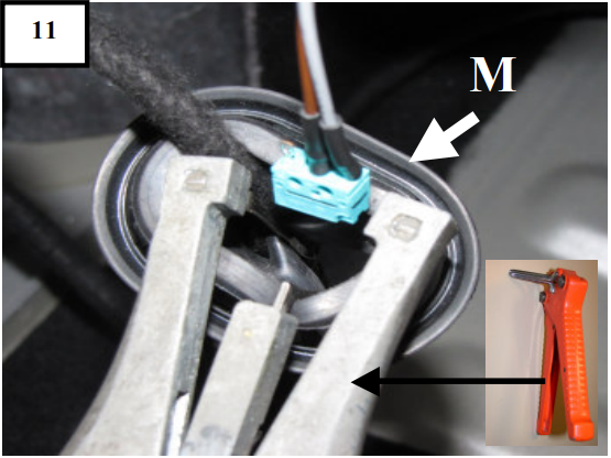

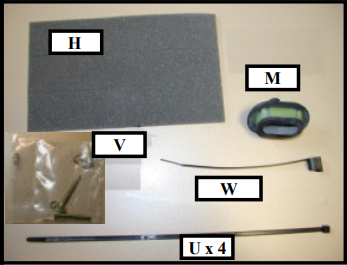

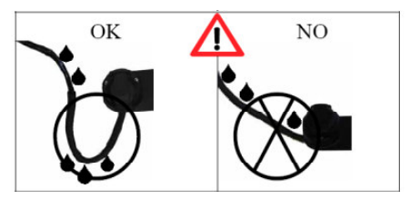

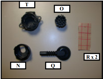

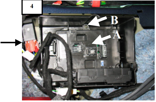

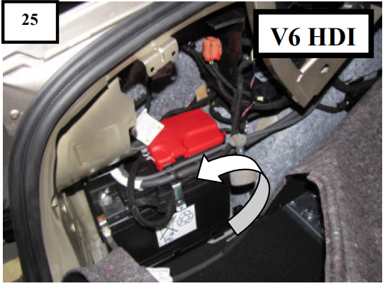

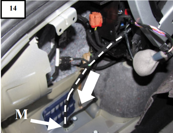

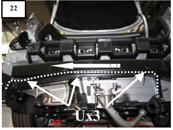

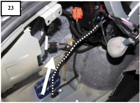

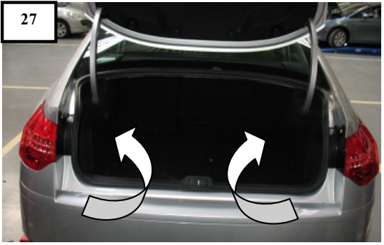

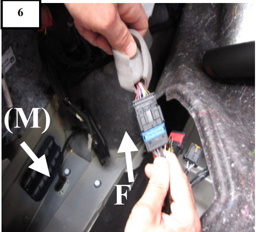

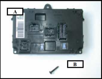

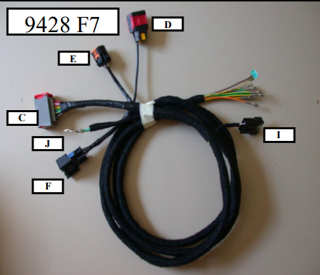

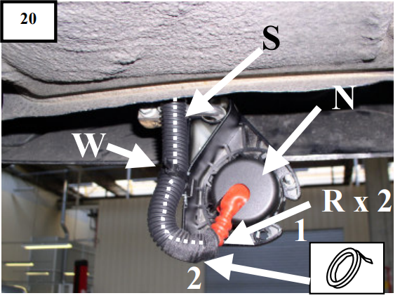

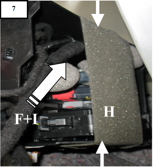

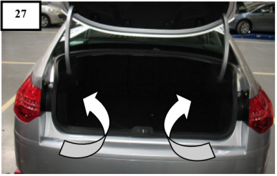

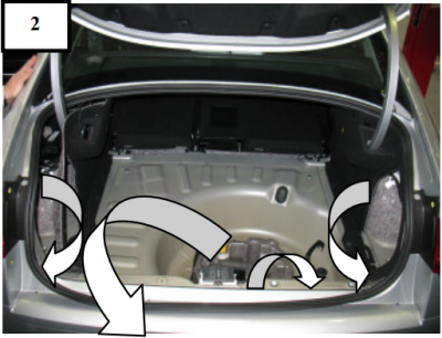

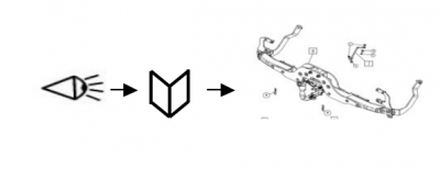

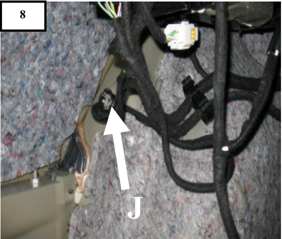

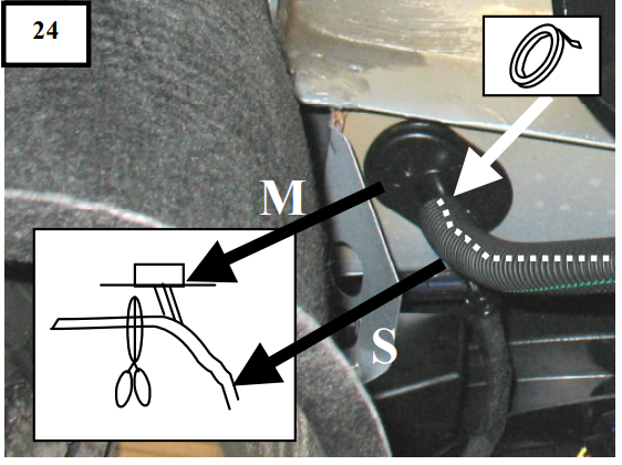

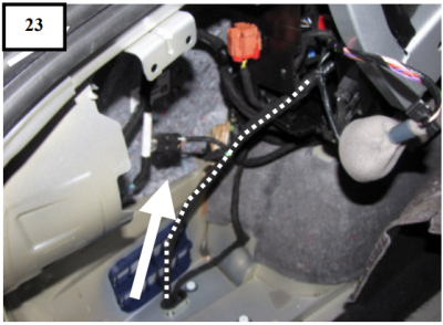

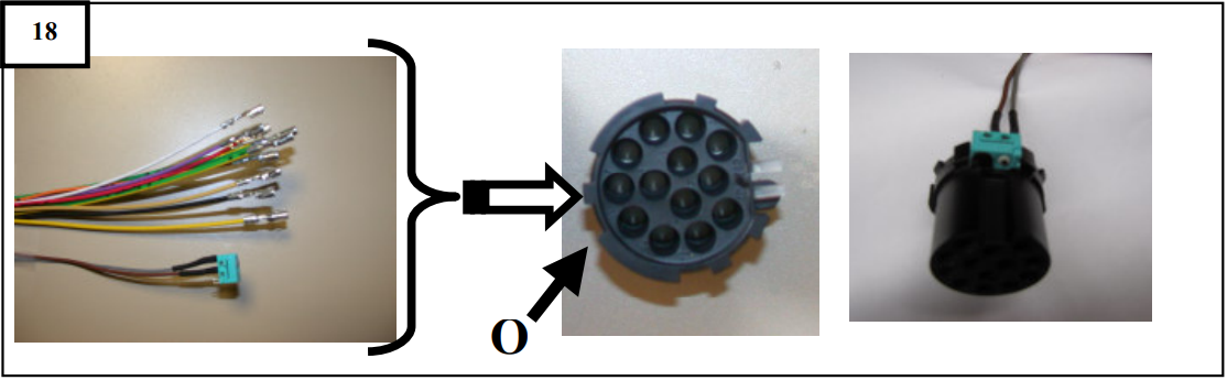

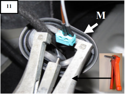

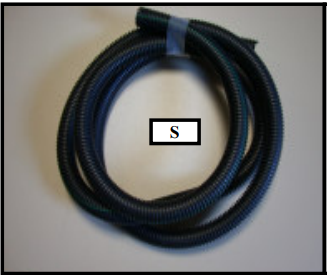

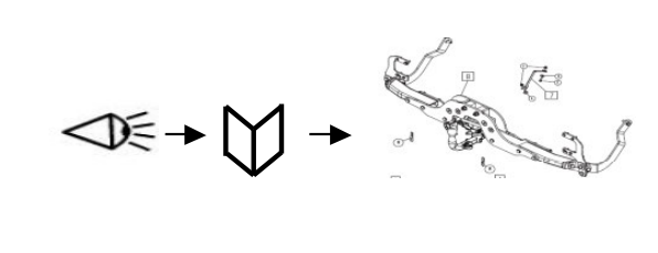

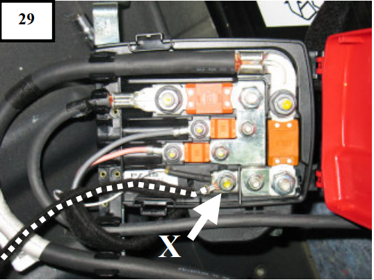

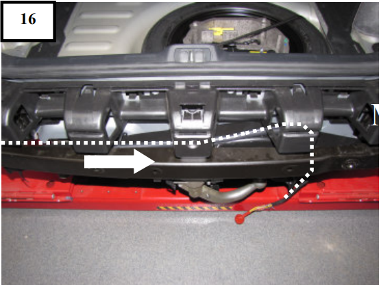

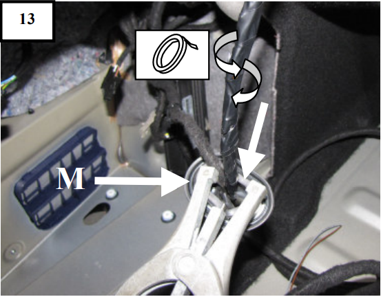

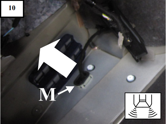

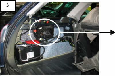

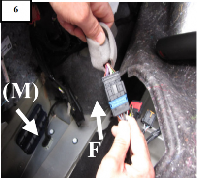

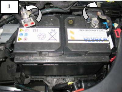

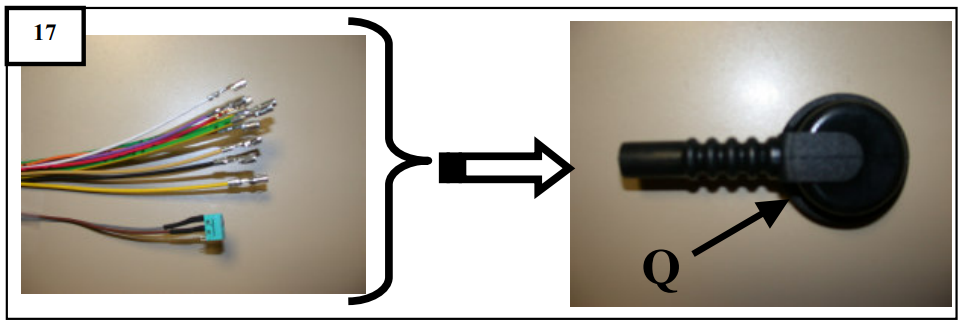

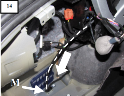

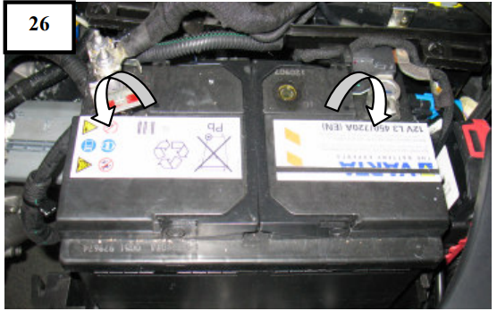

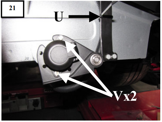

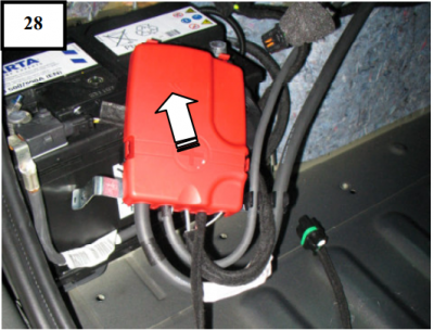

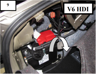

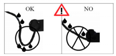

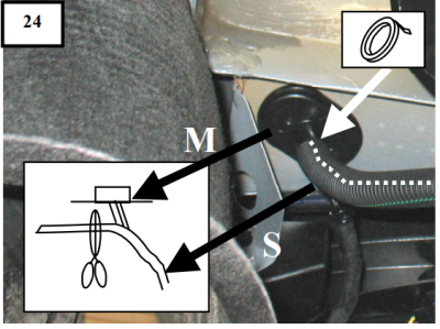

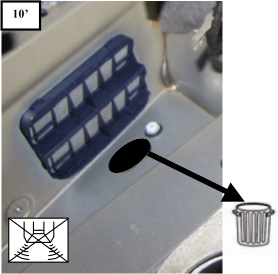

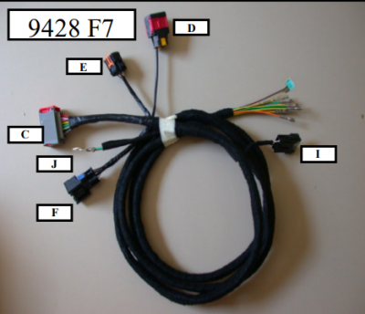

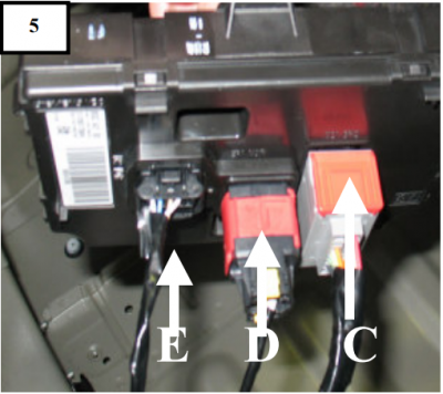

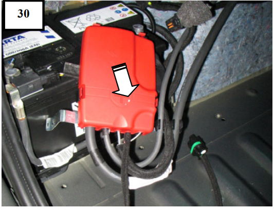

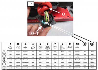

I think I'll replicate the Citroen fitting instructions here for reference (there is only a visual guide - nothing else - as it may benefit Avi (or confuse him more) :shock:
Note: 9, 25, 28, 29 & 30 are for V6 Engines only that have the battery in the rear. I have included these for completeness only.

These are just the instructions for the Citroen units Avi. I just posted hem up so you could see how their official unit is plumbed in. I’m sure you’ll fit your other unit ok.

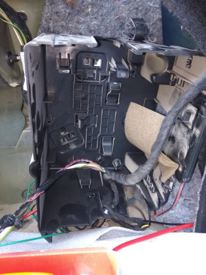

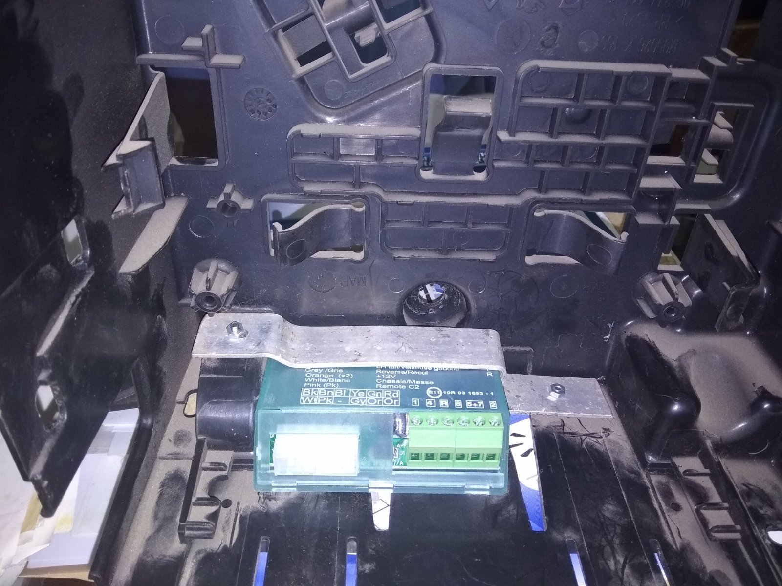

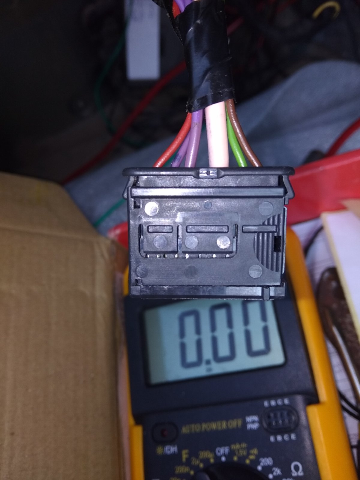

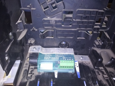

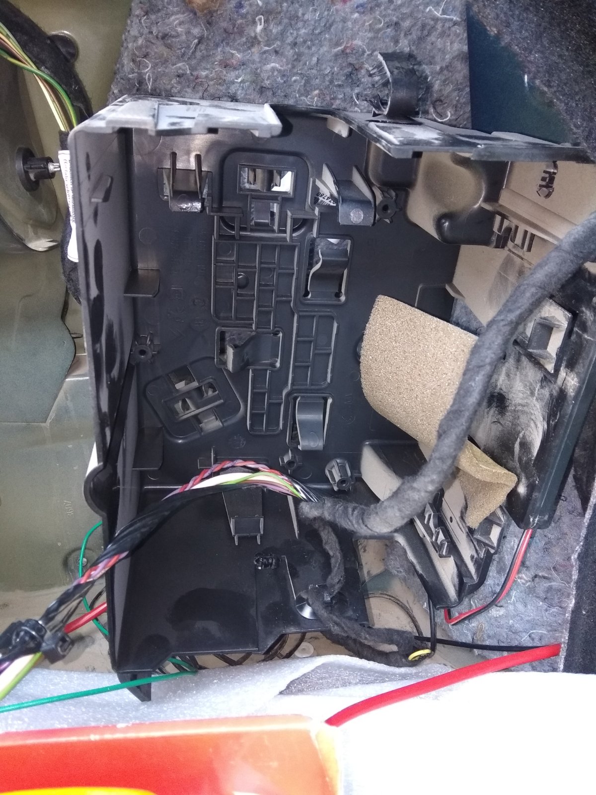

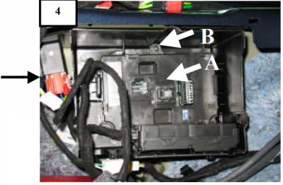

Well, the plot thickens. after the quest for the connector, I've finally started to install & connect the Ryder Smart Logic, I've discovered today two things: first, there is some sort of "box" made of plastic, on the left hand side. my assumption that it's the "house" for the BSR, if installed. picture of it attached. the second thing that I've found, is another loom with a connector. my second assumption - I hope that Marc will check it - is that is the loom that connects to the BSR. as you can see, there is a thick white/pinkish wire that carries a steady +12V (even with the ignition off) that I guess is for the fridge. there are two other wrapped wires that I guess are the CANBUS that delivers the data to BSR, telling it which lamp to turn on.
In my case, it's no longer relevant, since I'm installing the Ryder, but I hope it might help someone in the future.
Avi
atr
Posts: 314
Joined: 09 Oct 2010, 05:02
x 6
Re: Is it the socket / connector for the tow bar?
Unread post by atr »
Here is how I've installed the Ryder Smart Logig in the "box" that I've mentioned earlier.

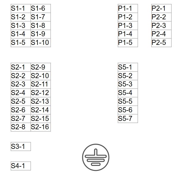

Hi all.

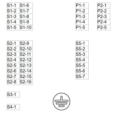

Can someone help with connections the wiring?

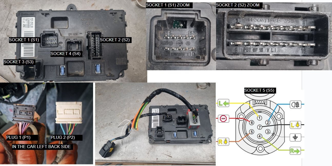

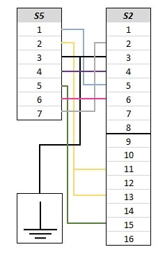

I have towbar module and cut off plugs.
Can someone explain how the original wiring is designed? I drawed sockets and plugs, please write connections between them.
Thanks

Unread post by panoramix »
If someone want to create own wires, below draws how to connect sockets and plugs. Works for me, only not working disabling reversing sensors.
