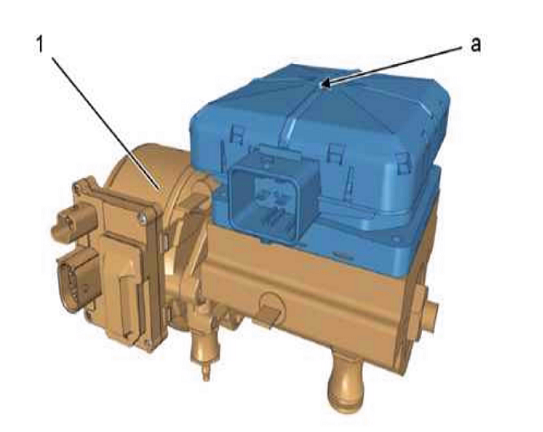

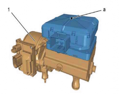

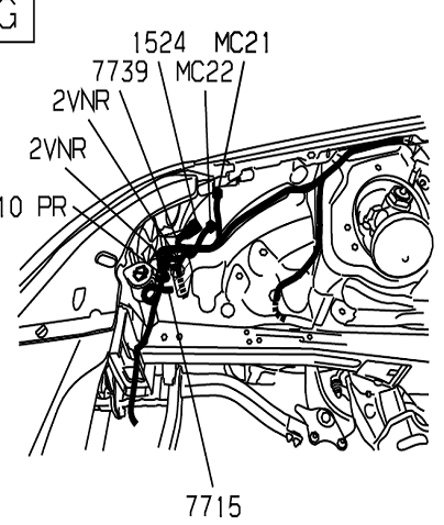

This one's a bit awkward with the additional suspension ECU - but from what I can see, the CAN wiring is only on the Suspension ECU part on top of the BHI unit, which has a 32 Pin black connector.
The other 2 sockets are the power for the pump motor:
(1) Is the Integrated Hydraulic Block (BHI)
'a' is the suspension ECU (but you also have another one that deals with the 4 height sensors and the variable power steering) - but ignore that for now.

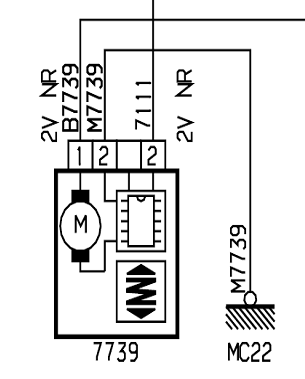

This is for the Electric Pump Motor Command which should be one of the 2 connectors on the left. This is a 2 pin black connector and should be the (7739): central electronic block motor.
B7739 in Pin 1 is the Battery Positive that goes to a relay
M7730 in Pin 2 is the Earth
7111 in Pin 2 also is the Electric Pump Motor Command:- so is this the paired wire you are talking about?
7739 should be on the unit according to the location:
ActivaV6uk
- Posts: 650
- Joined: 20 Nov 2003, 16:51
Re: C5 X7 rear suspension fun.
Yep 7111 is damaged (frayed internally) it looks like there should be a green cable on pin 1 too. The power cable b7839 and m7739 need to be pushed away from the pump body/to th wing and they almost always kick the pump in.
We did a long drive yesterday, with these held in place the back didn't drop. I need to get the tank out I think and repair the cabling in this area.

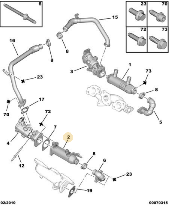

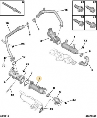

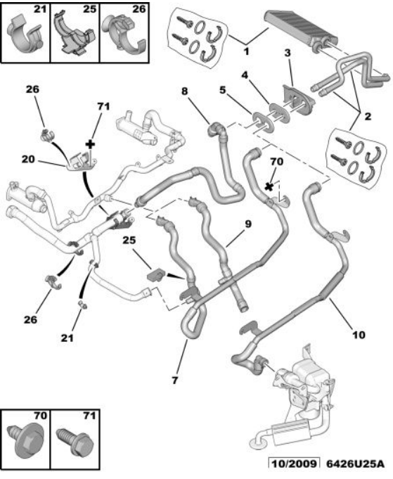

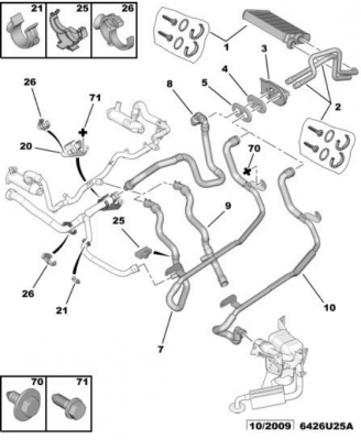

The greyed out part upper left that is very long and I believe between the 2 turbos or heads
- x 6960
Right, those are part of the Exhaust Gas Cooling circuit:
15 Part 1618K4 (Gas Recycling Tubes)
16 Part 1618K5 (Ditto)
17 is the EGR Flange Seal Part 1618L0
18 is the Tube Collar 1618Q4
If you want prices shout..
