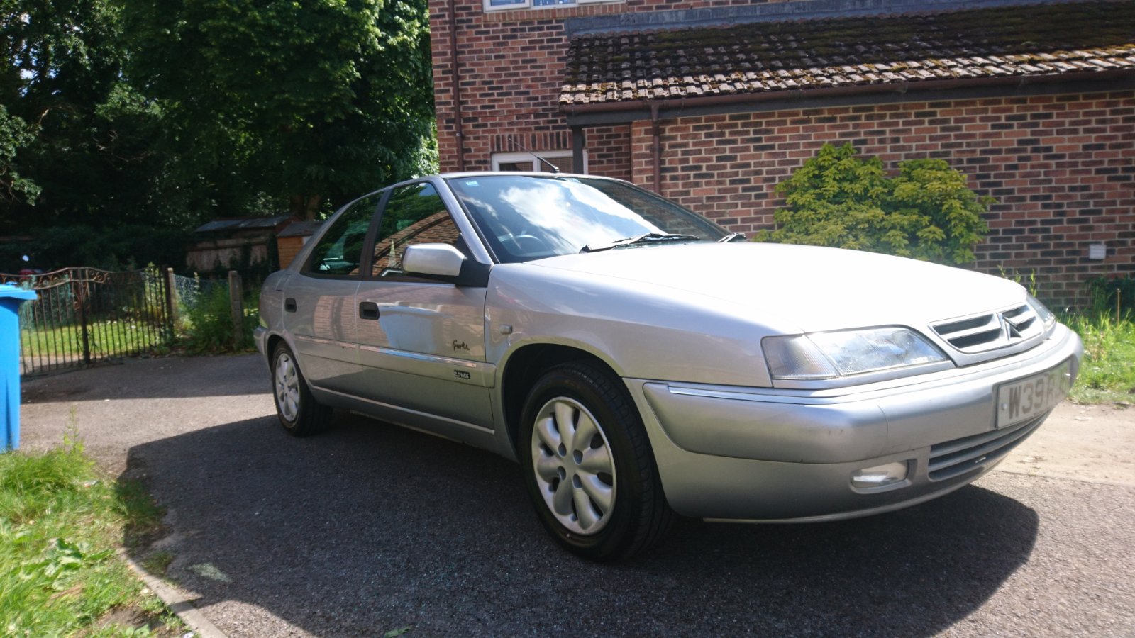

Better late than never but as promised pictures :)
She has now had all new spheres, complete LHM ( black stuff :shock: ) removed and Hydraflush replaced.
Also treated her to a new set of boots all round and gave her a quick clean up.
She does scrub up well :lol:

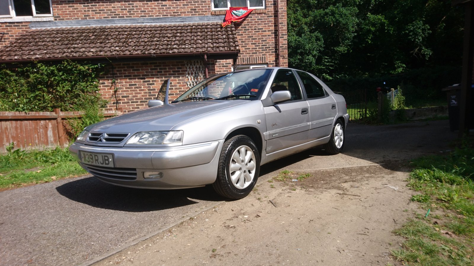

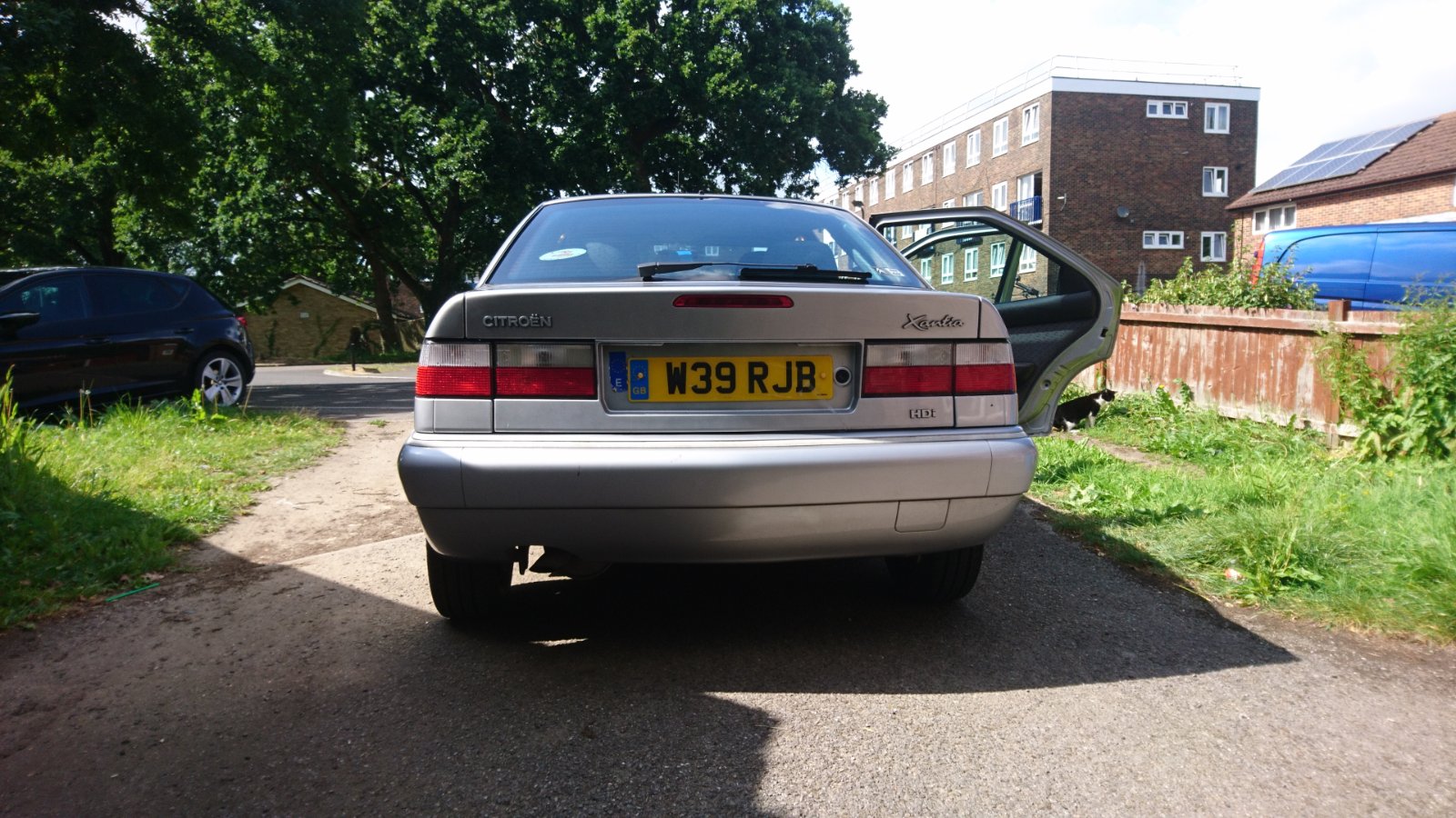

I am convinced the ride height at the front is wrong, the photos are at an angle but to me the rear is pretty close but the front i think is about 1" to high, have thought it was not right from when i got it but looking at the pics i am even more convinced.
Years back CitroJim gave me advice on the getting the ride height somewhere close by if i remember correctly setting the car on high with the engine running ( over a pit that i had access to ) and loosening a bolt on the rear height corrector and letting it settle to its lowest position. This is where i get confused as i think he said set the in car lever to low and then do the bolt back up but not 70% sure. Think it was then with engine still running set lever to normal and car should be pretty close to normal ride height but is front and rear ride height controlled by rear corrector alone or have i got it totally wrong, as i think i can get access to the pit if needed

Front and rear ride height independent.
If I recall correctly you do need a pit, and do a set of citroebics, let the car settle at normal height then push down and lift up the end you are adjusting, let it settle again then mark the clamp and arb so you have a reference and can put it back if it all goes horribly wrong, loosen the clamp bolt for the corrector enough for the clamp to be moved slightly but with resistance. Move the clamp very slightly - a millimeter can make a fair difference.
Tighten the bolt and do the citroebics and lift/drop again then check the height and repeat until correct.

The old brain seems to recall the lay mans way to check the correct height is 2 fingers at the rear and 3 fingers at the front clearance from top of tyre to wheel arch, and the front is maybe just a tad over 3 fingers and the rear bang on 2 fingers .
Will keep an eye on it but think it is pretty close so can probably live with that and the more Citrobics the more she moves up and down as one, still a little slow on rear movement but low to high is pretty much both ends same time, will need to keep lubricating rear corrector and keep up with the citrobics:)

Nice motor! going by the photos I'd say the heights look about right - the front wheelarch gap is bigger than the rear.

Yes i concur that maybe the ride height is pretty close, the photos were taken on my driveway and it is on a slope so makes the front look even higher than it really is, i will try and take a few pics of it on level ground just for comparison.

Measure the height of a Xantia with the engine running, as the action of the anti-sink valves can cause the height to be wrong after the engine is switched off.
