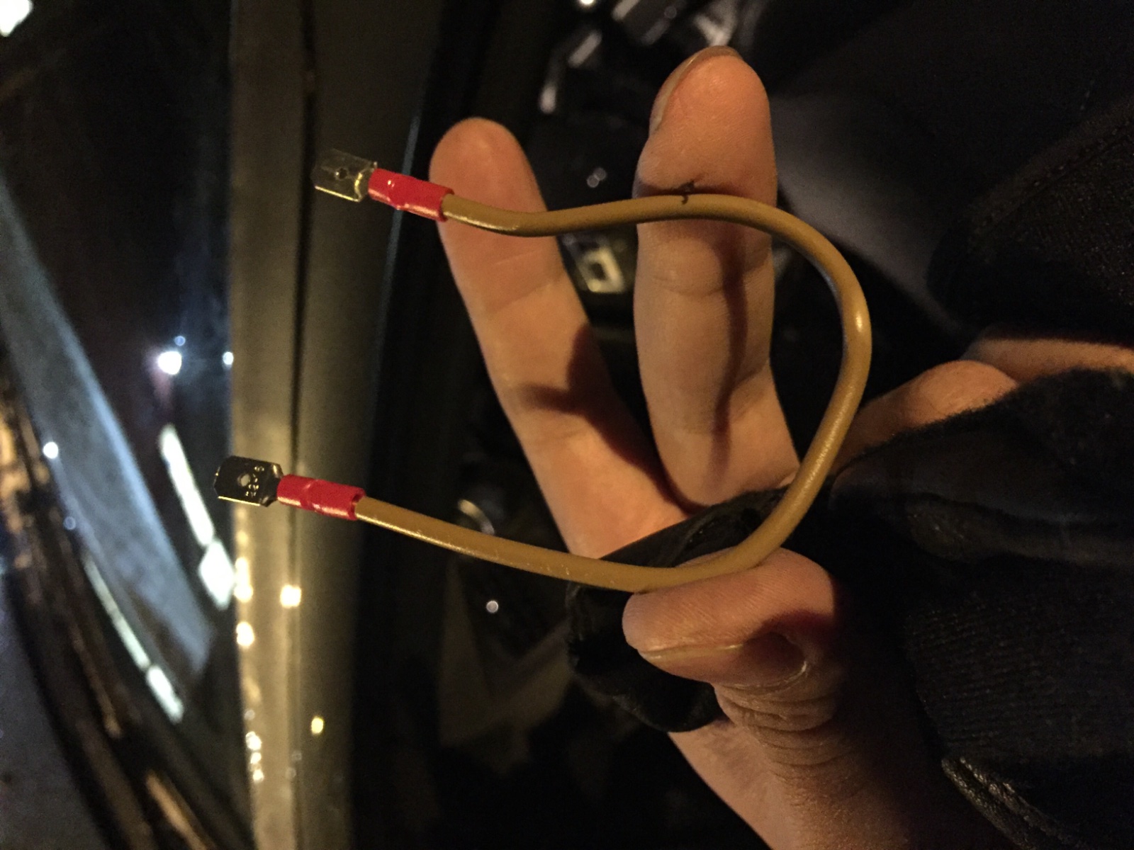

Ok guys, tried to jump cable between these two point as Paul recomnended. And the fan is working on full speed! Thats a good sign.
But what know? Should I buy a Brand new ressistor? With ort number 6441AJ?

ImageIt worked!!!
I made that jumper, and then let the fan blow on full speed for 30 minutes, after that I gave it a try with my old ressistor. And everything worked just fine! You guys saved me this winter! Thanks
