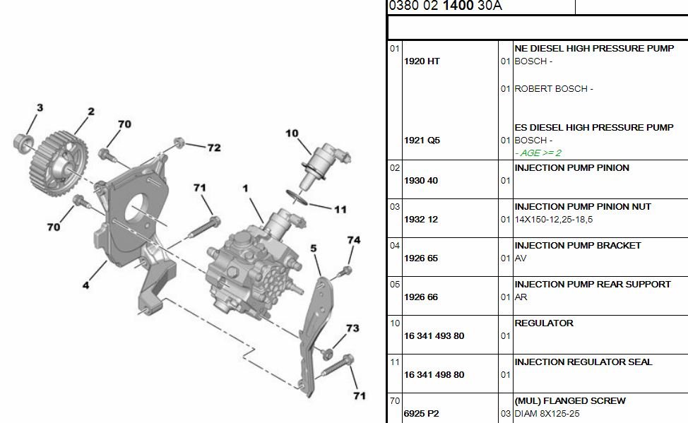

"Where is the stop solenoid ?"
I'm guessing it's this, #10 on the diag. Just unplug.

Still non the wiser, where is it located, got it injection pump? I have had my fill,of this van now, I can’t spend any more money on it,after the Xmas and new year holiday, I will be looking to offload
Cheers Rich :wink:
x 1751
Re: And so it continues....
On the injection pump.

Chris , not possible to disconnect stop solenoid. Intercooler pipes in the way.
Cheers Rich :wink:
