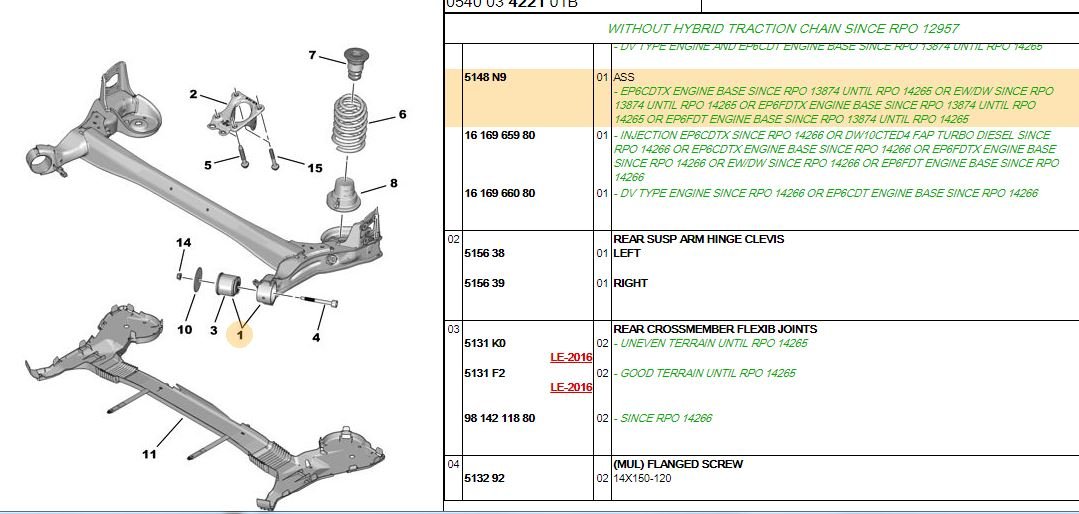

RichardW wrote: 09 Oct 2018, 12:39 Diagram of the rear suspension:
You can see that later cars have a different cross member / torsion bar (the 10 digit part number at the bottom) - possibly this is a bit less stiff so modifying roll characteristics. You can see there are different flexible joints however - and again there is a revised part. It also directs you to LE-2016, and under the part numbers for the earlier type of flexible joint it says:
5131 F2 Propose :
- 98 142 118 80(2)
5131 K0 Propose :
- 98 142 118 80(2) It is imperative that both dampers are replaced
So, it would appear there are different grades of flexi joints; one of which says replace the dampers. If you post up the VIN I can see which is fitted to yours, and then you will know whether dampers are recommended or not - although there is also a recommendation on dampers that the later type is fitted. There are 3 types of damper, so again VIN will confirm which required. Parts prices for all these:

That sounds as a very interesting option to try: replacing flexi joints. I already planned to change dampers, so can you have a look what's recommended for my vehicle?
Thanks,
Bart
x 6950
Re: DS5 suspension
Bart - Airbag Recall for this vehicle! Not sure if I've mentioned it in another post anywhere, as we have so many posts to get through, but you know now anyway:
Airbag Takata - Information - Ref: NT7, Launch date: 24/02/2025
Dear Customer, We confirm that your vehicle is equipped with Takata airbags, but it is not included in any measure already launched. We will provide further information as soon as it is time to proceed with the recall process for your vehicle. The Takata airbags recall is being implemented according to a staggered approach, to ensure safety first and service of all customers in the fastest and most efficient way: oldest vehicles are planned to be serviced first. We will send a dedicated safety notice for your vehicle in due time, providing all instructions needed. While we are operating a continuous monitoring of the behavior of Takata airbags, you are also invited to verify again on this webpage, to retrieve the most recent information in the fastest way.
Back to the Suspension:
5131F2 is the correct rear bushings.
