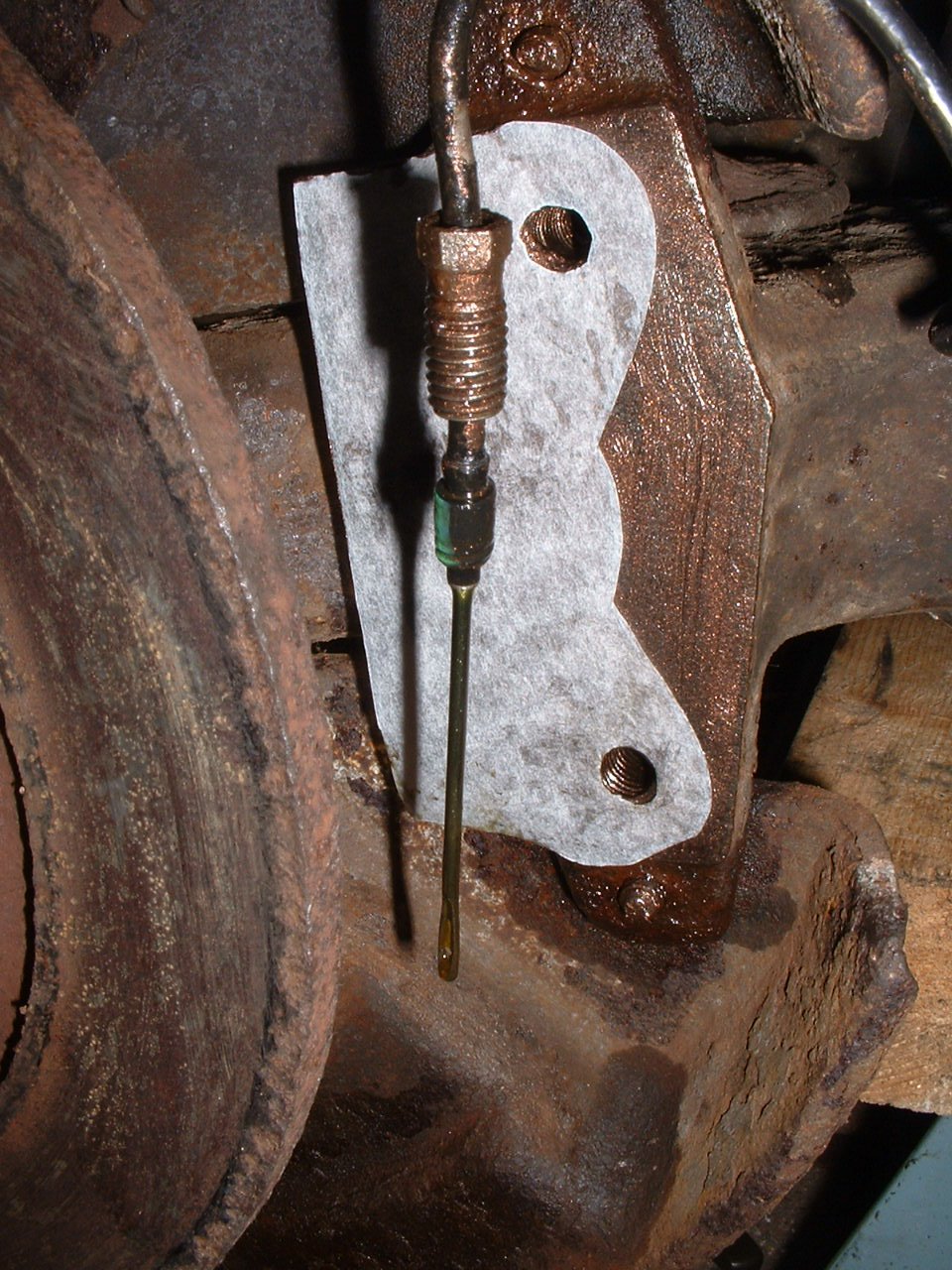

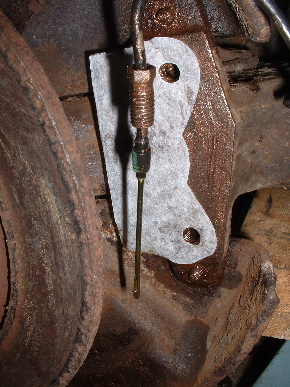

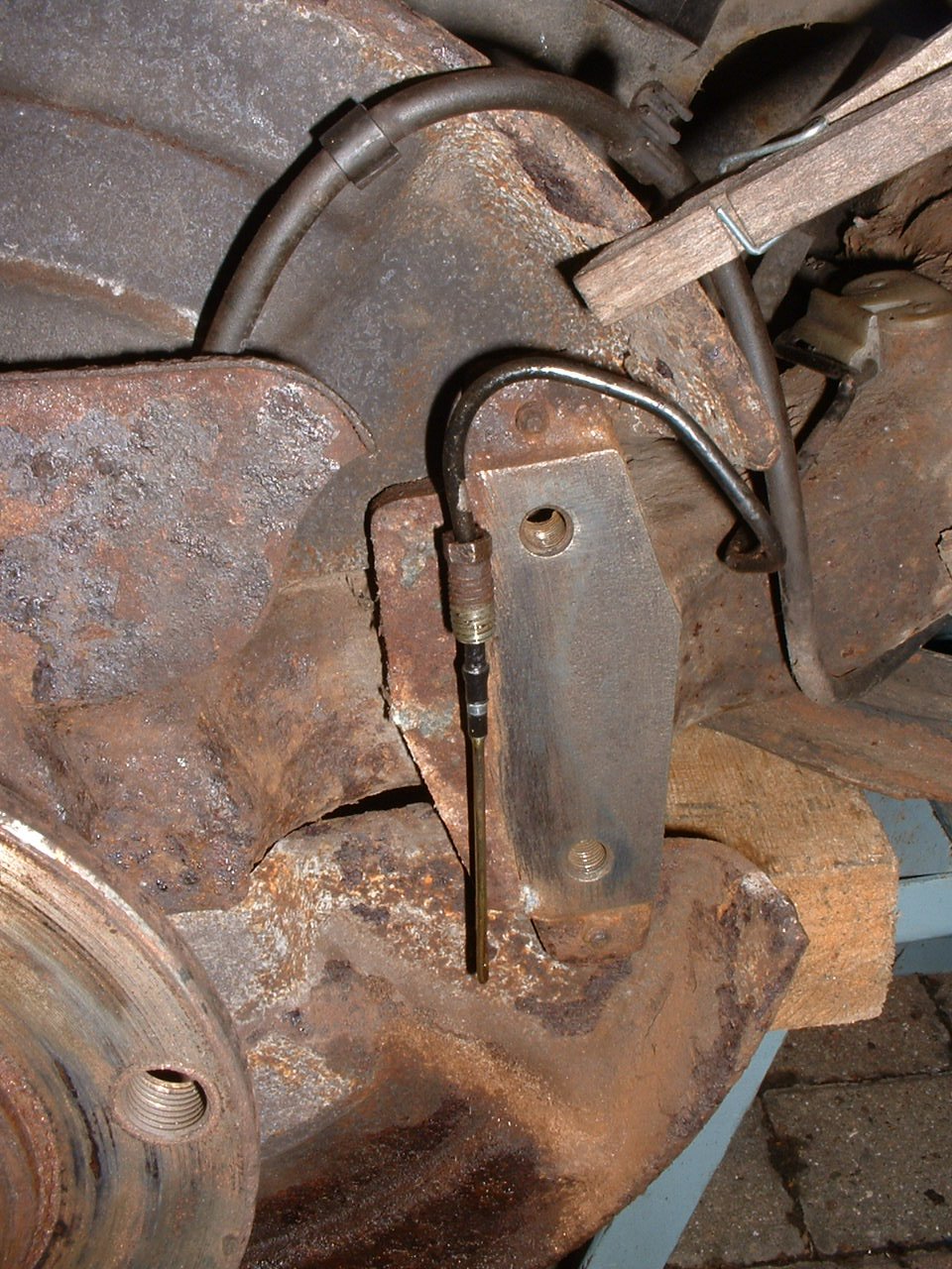

SUMMARY of WANTED CALIPER thread when I suspected the caliper was siezed after the telecoms with the MOT tester
If you don't like sucking eggs you can skip the next bit
The bleeding went like this so far:
REAR sat on weighted wheels
SUSPENSION LOW - HIGH - LOW - HIGH
Engine running in HIGH with brake pedal pressure applied with a length of wood whilst bleeding the brakes.
It was fiddly aligning the hole to get the bleed tube on AND the 8mm spanner with enough swing to open and close the bleed nipple as the hole (wheel) rotates when changing suspension height settings JUST enough to ruin the access for the 'spanner swing'. Plenty of air from the caliper that was stripped which was to be expected but there was also a second splurge of air from the same side that I think was the problem all along
The NSR was next with less air from the caliper that wasn't stripped but again more air splurges than expected. They seem to have run clear within 0.5 Ltr each side .
A further confirmation that the brakes are more reactive was further tested by jacking each rear wheel clear of the ground and with an assistant operating the brakes I used the torque wrench on the wheel nuts to feel the on/off of the brakes being operated and also spinning the wheel by hand as fast as possible to see how quickly it stopped to sense the brakes were coming on quickly and releasing with the brake lever.
Thanks for all the responses to this thread hopefully I'll get the easier front brakes bled tomorrow for my peace of mind (OSF then NSF) basically for confidence because I missed the extra air hiding in the rear brake lines and hopefully get the MOT re-test sorted ....I'm pretty sure prior to a test drive on route to the MOT re-test that the car will now pass
If she passes that will be an indicator to me that she MAY have just needed a re-bleed due to the unknown length of time that the car may have been run with damaged pipework
Edit to re-post photosSkull wrote: 16 Dec 2018, 17:33 Well I've finished at the rear for now, the OSR caliper was stripped, the pistons cleaned up with a cloth as good as new and I soaked the seals overnight - reassembled today without any problem and then refitted after cleaning the face and I used copper-ease on both metal surfaces with the grease proof paper 'gasket' on both sides. Whilst working in the OSR area I also removed the backplate bolts and greased them up and cleaned up the brake line and re-greased it.
