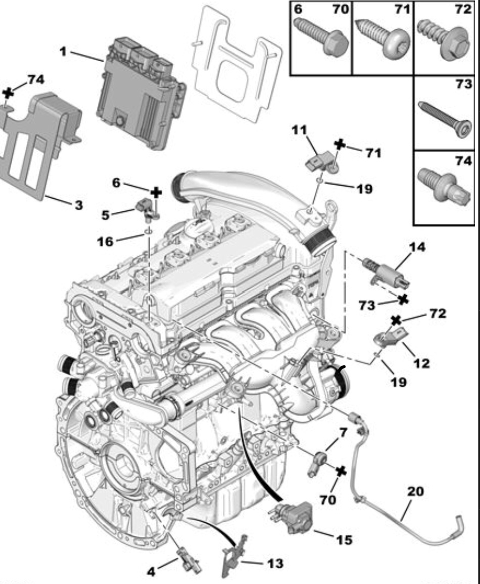

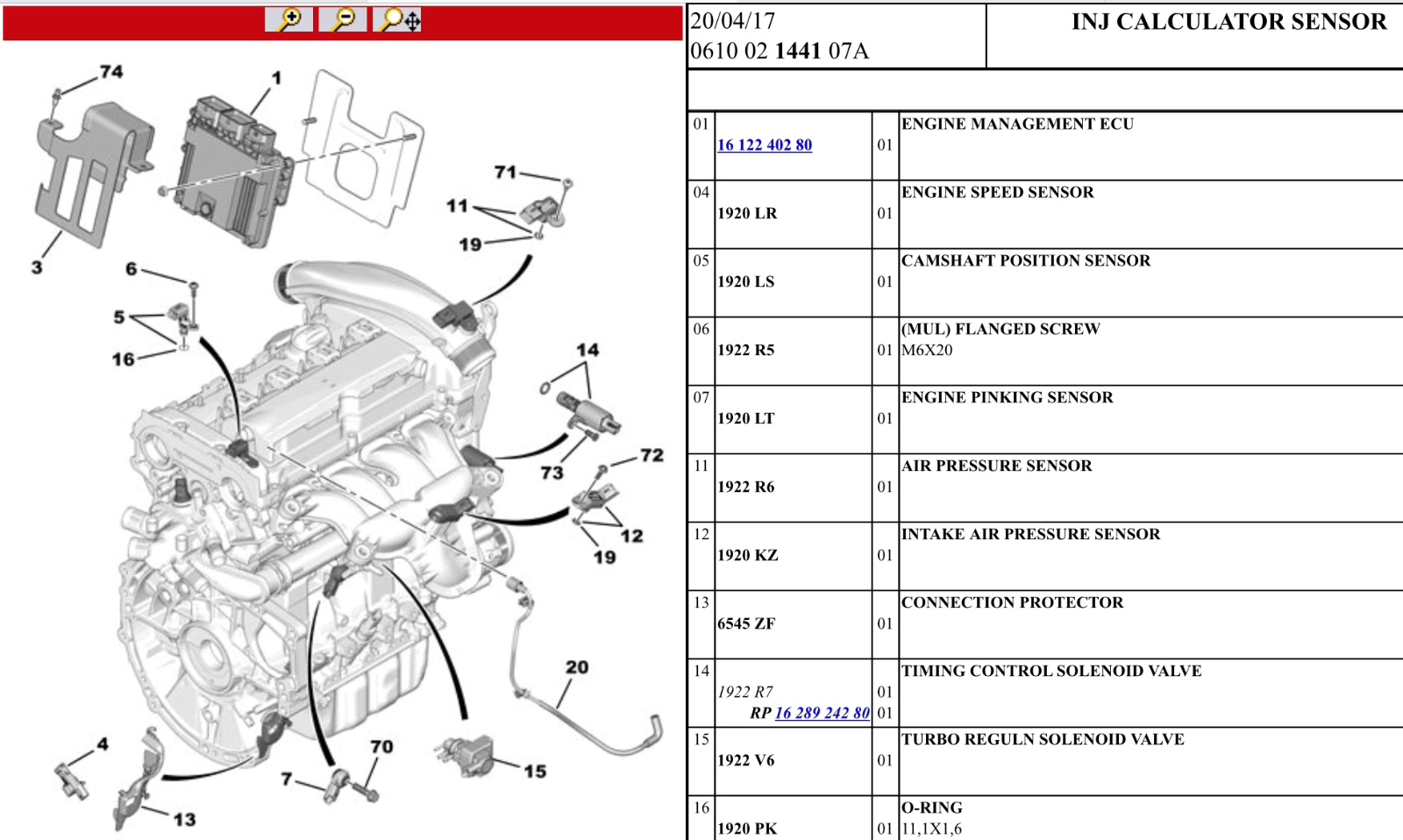

I’ll need the VIN for the vehicle to confirm the part as there are quite a few variations, but it looks ok...
11 is the Air Pressure Sensor. 12 is the Intake Air Pressure Sensor

Here you go. This is the diagram for your car.
Item 11 Part Number 1922R6 available from Citroen for £100.03 inc. VAT. You’ll need to do the conversion for your country. But you may be able to get a new one elsewhere. If you do make sure it is a well known brand.

PS.: do you have any idea how to change in the second picture part number 15, turbo reguln solenoid valve? This is the one giving the snifting sound at deceleration...

The turbo boost control valve is a little troublesome to change, it is done from under the vehicle and you probably need to remove the link pipe (if there is one) in the exhaust to get access, and even then it is not easy to reach or see what you are doing. I am not convinced that that valve will be causing an abnormal deceleration noise because any abnormal operation of the valve will trigger boost control error codes.

Changed the valve...same noise...Now I really don't know what's that sound
Ps.: what is the item called on the above picture which has number 20?
