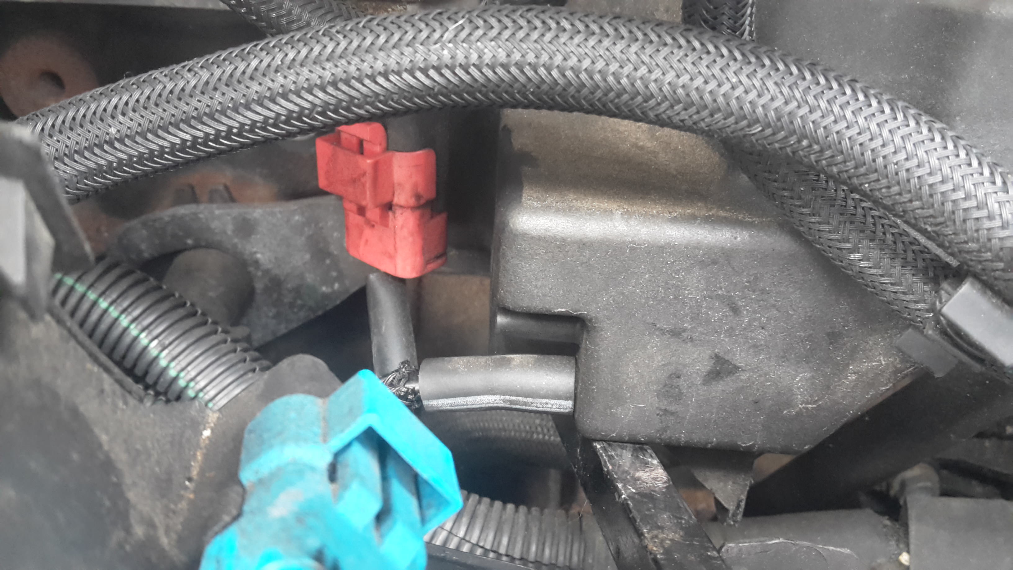

out this morning, stripped off the gubbins again and found an open ended fitting on the vac reservoir
pipe connected to it and tee'd in to the pipe from the vac pump and to the solenoid on AC, seemed the most logical way the way the plastic pipes sat?
out for test, still the same , flat as....no boost

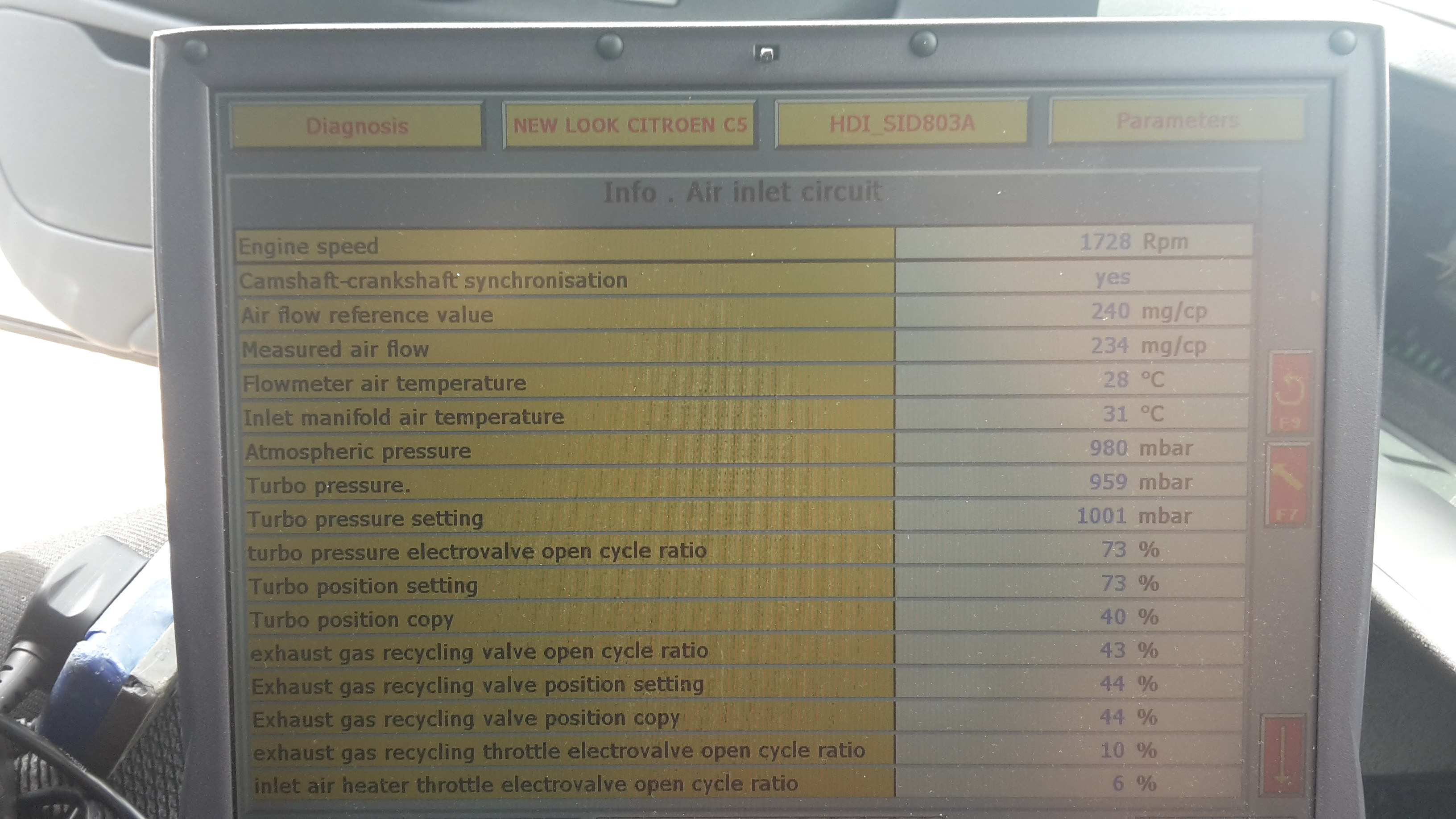

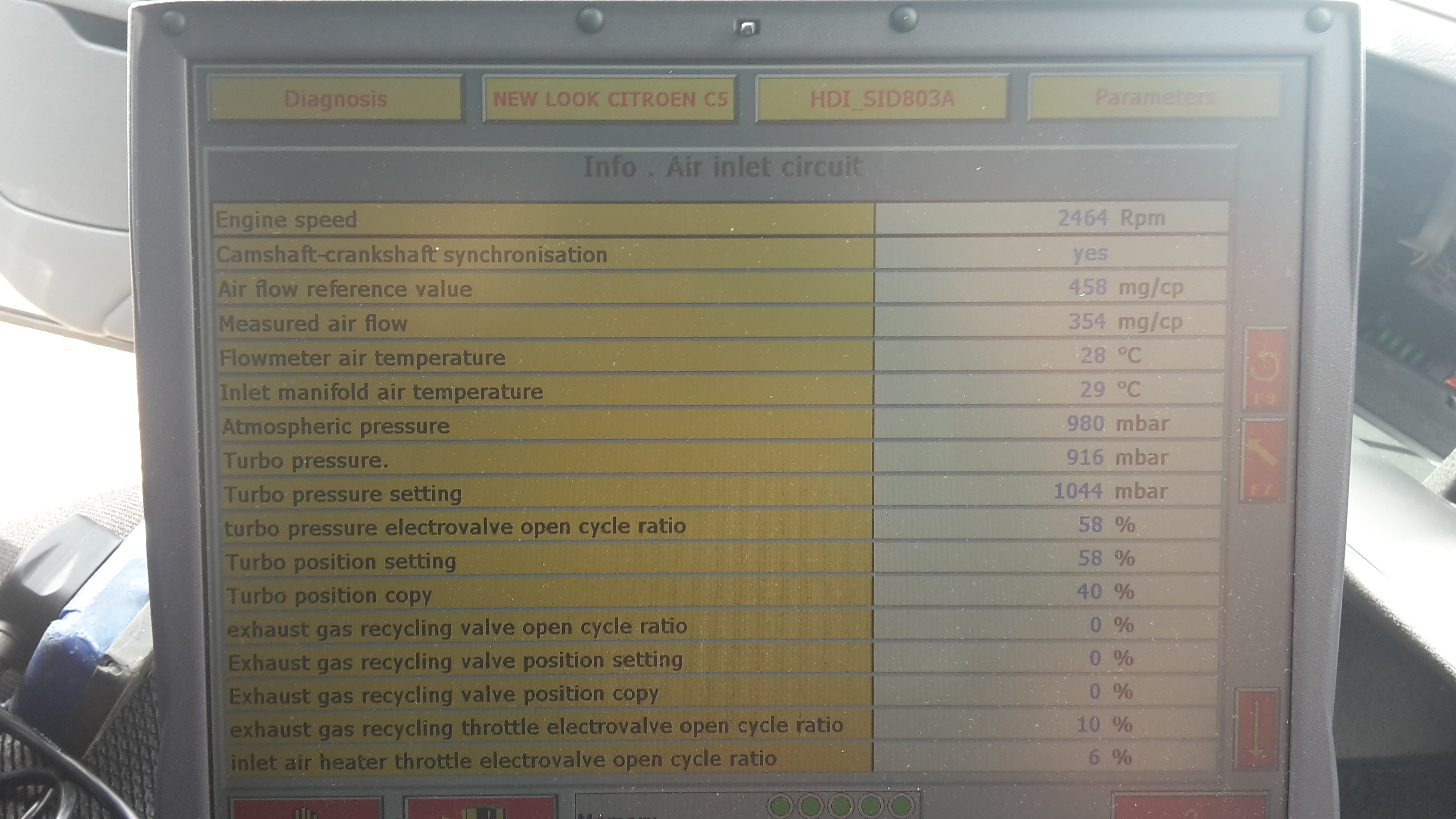

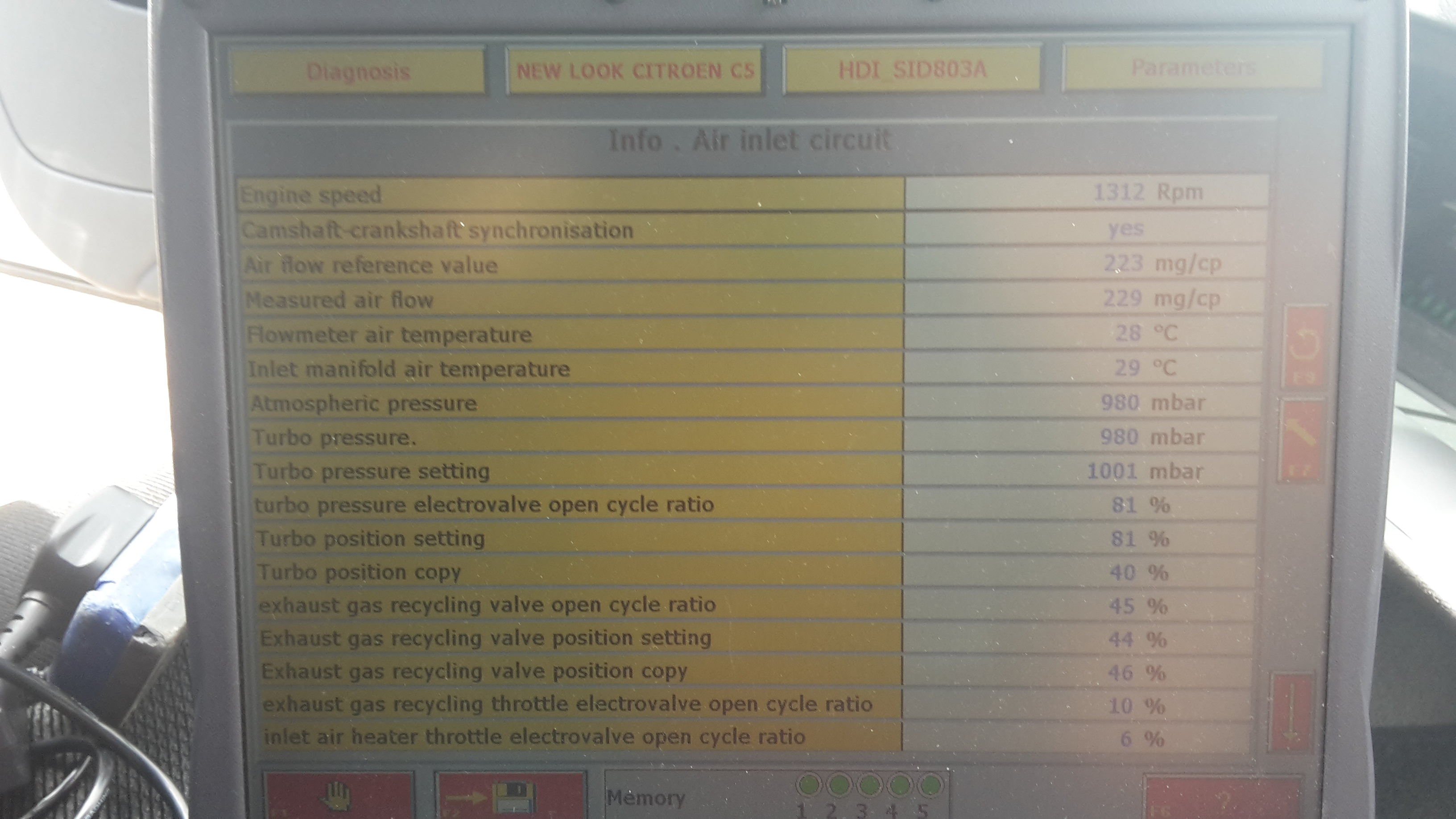

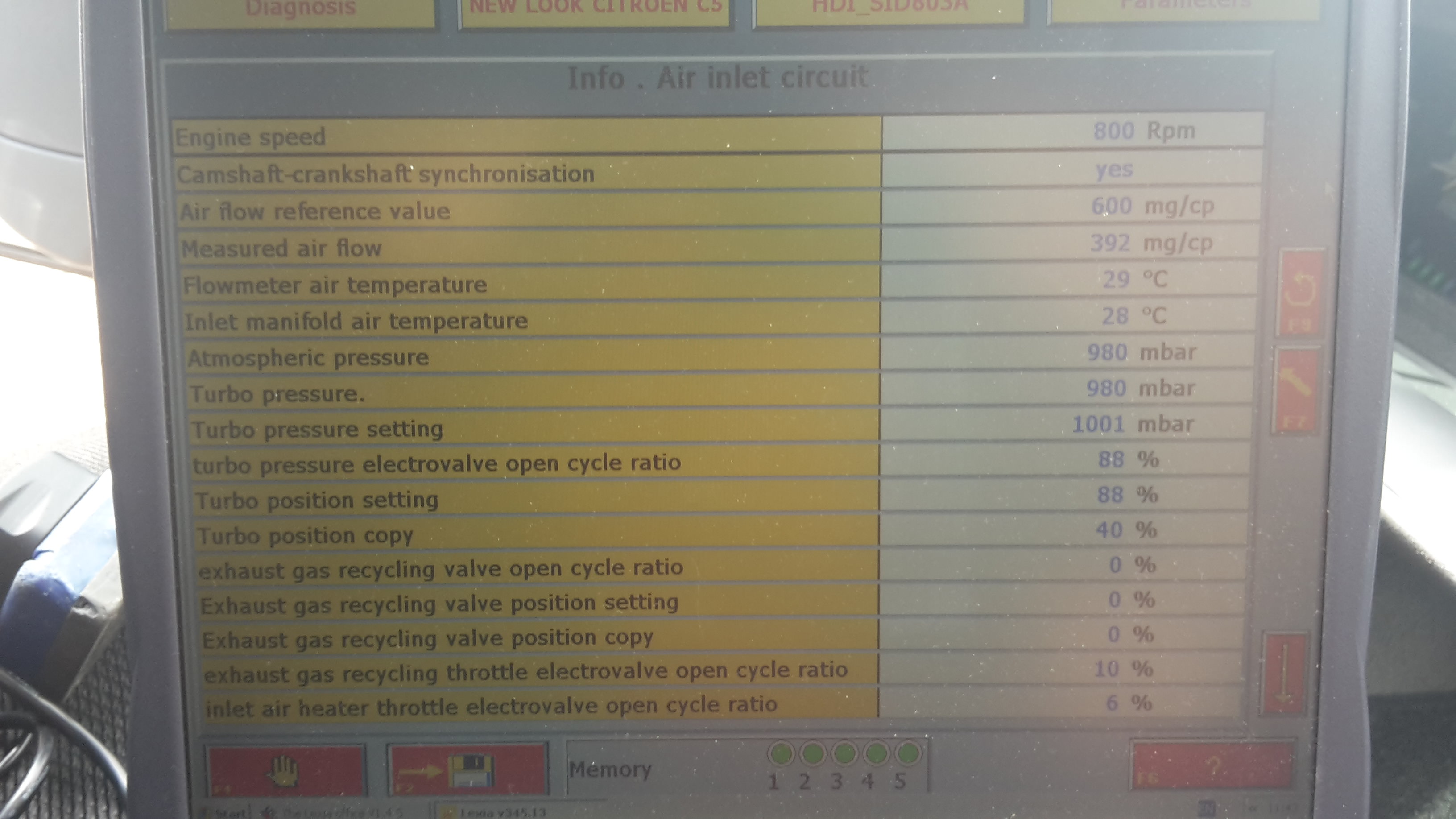

actuator tests...
fuel flow reg...OK
fuel press reg...OK
EGR valve ...clicks
EGR electrovalve...not at first but faintly when pipes to Vac res were swapped, low vac pressure?
inlet air heater throttle electro...OK
Turbo pressure...not at first, again better when vac res pipes swapped
live data screenshots, stationary...excuse the quality, phone got a bit grubby
off out to lunch later and then a sit down in a dark room and a sob in the corner :)
i'm reluctant to take off EGR at moment, no time and may not achieve anything

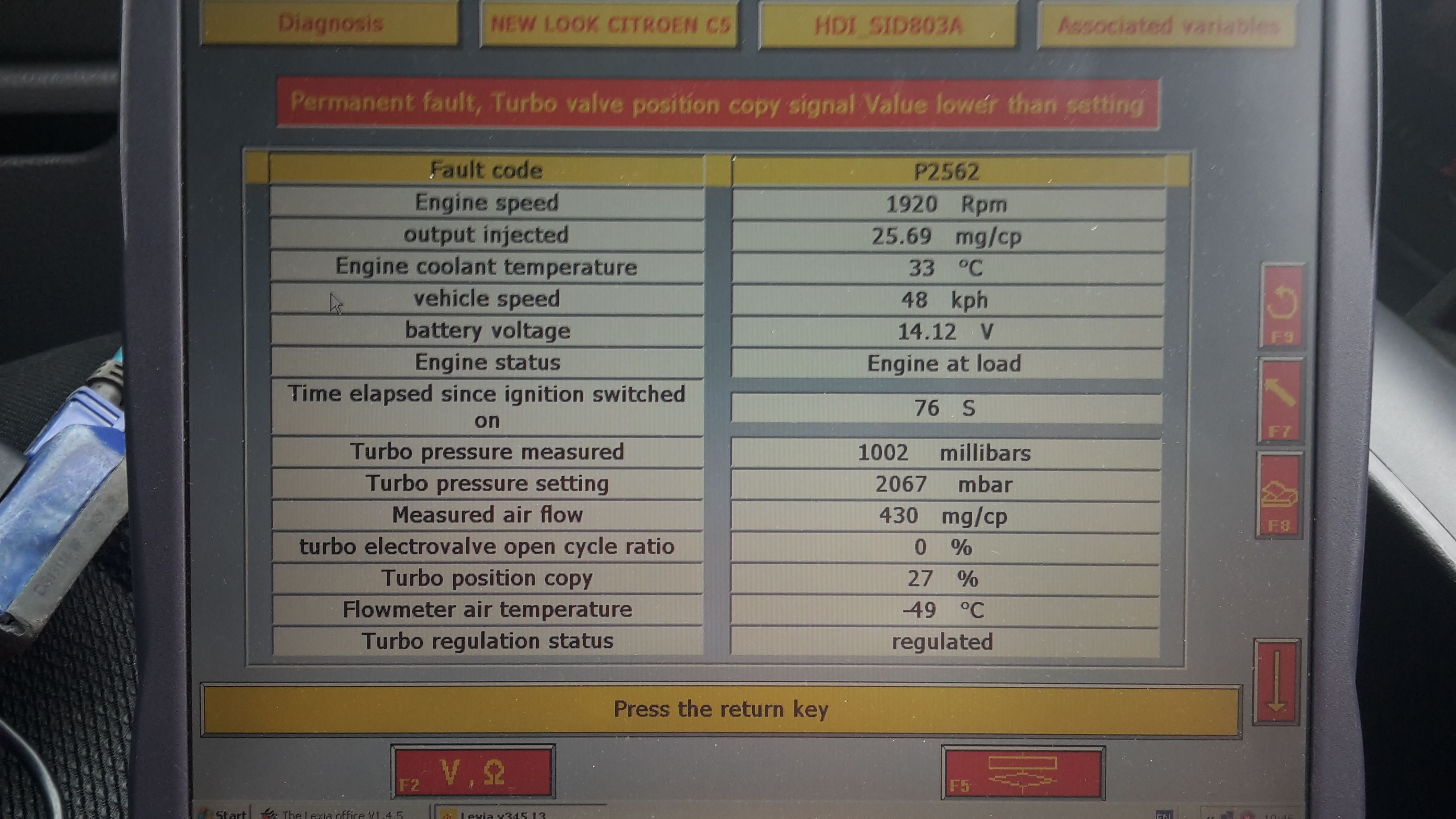

I think the pressure sensor in your inlet manifold would benefit from being changed myself. It's probably full of that carbon gunk, possibly clogging the diaphragm.
Also, you may need a new MAF (that includes a temp sensor) as the inlet temp of -49 wont be helping things.
The main issue seems to be the vacuum system that actuates the turbo, if there are no vac leaks then I'd suspect the solenoid valve.

That's odd, there must be another reason for the erroneous freezing cold temp reading then.
Yes, that's the one, its short stub sticks into the doser housing so it can sense the pressure. Is it blocked up perhaps?
If the piping is all ok, then there may be a physical reason why the vanes on the turbo won't move. I'd be tempted to try this 'easier' step first:
