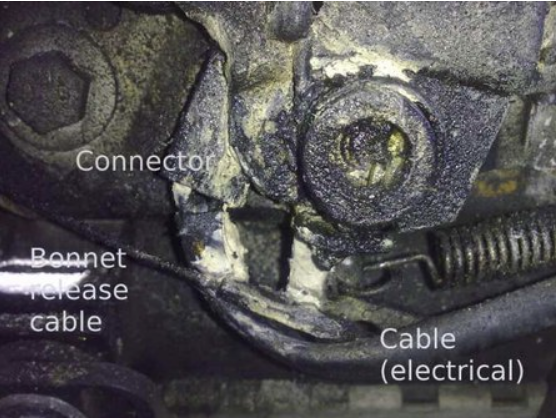

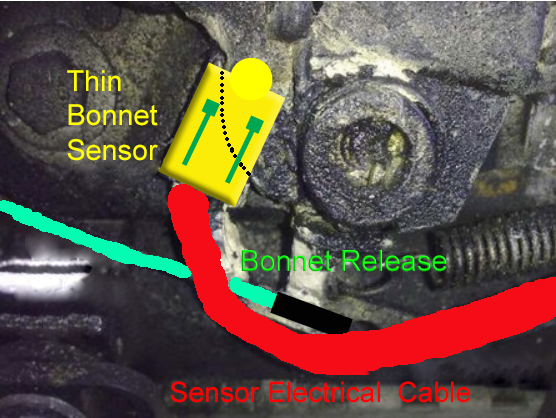

Correct Zel, - unlike the C5 (X7) which has the bonnet contact switch on one of the corners where the bonnet comes down on a bump stop and depresses the switch underneath - the C3 allows for no experimentation as the switch itself is very thin and slides precariously onto a thin sliver of the inside of the bonnet catch plate. It has a precise location or the bonnet 'hook' won't make contact and push the nipple in. Everything is so compact on the C3 MK II there is no room to put anything.
I've pinched and edited a diagram on C3 Owners below but drawn the actual sensor as it was difficult to make out as you can see against the original. The yellow sensor slides behind the plate where I have drawn the black dotted lines. So there is no room for anything and it has to fit at the exact location and 'clips' into place using the green runners.
Original courtesy of C3 OwnersModified to show the Alarm Bonnet Sensor
