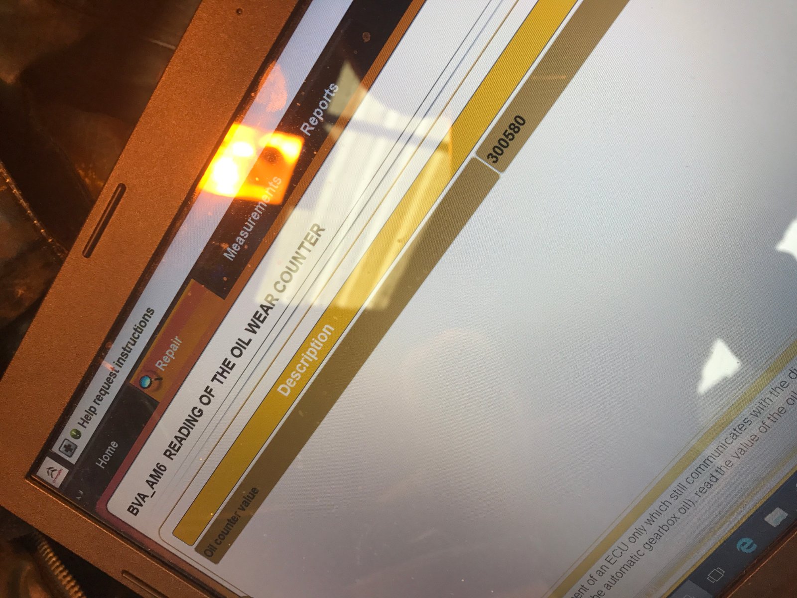

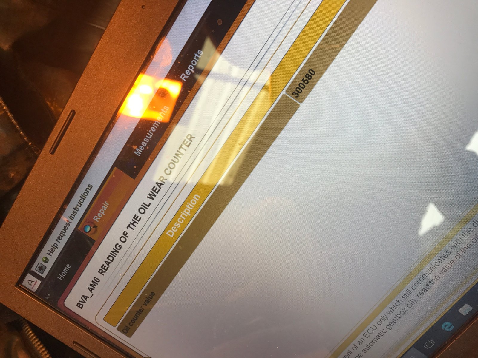

I'll dig out the pic of my oil wear counter, I've got it somewhere:
300,580. That's at around 58,000 miles

Thanks, I must have misread my counter, yours is 5.2 x miles and mine reads 15 x miles, was trying to confirm or not whether the change today was it's first, but if I've misread the counter that idea is up the spout. Unless the counter isn't linear with the mileage? Need more examples I suppose. I think it was though.

It's not to do with the miles alone. It's based on the temperature of the oil and the time spent at that temperature. There may be a milage component to the counter value but it's not the only factor by a long shot.
- x 6945
Re: 407 very intermittent surging
Yes that's correct Elis - I think I posted about it somewhere in the depths of the Forum - but can't recall now, but certainly the time spent at certain temperatures all affect the increments of the counter.

It's interesting comparing our oil counter values. From my reckoning my oil was already badly burned at 300580 oil counter (58k miles), was yours like water at the much higher value? Any metallic specs in the oil at all? Any bad odours from the oil?

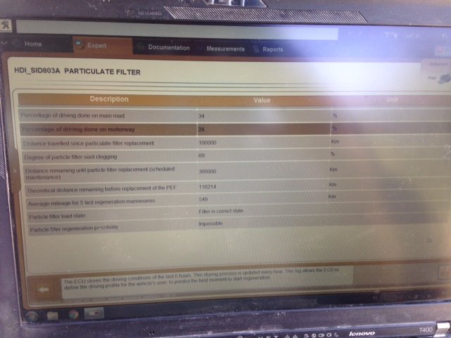

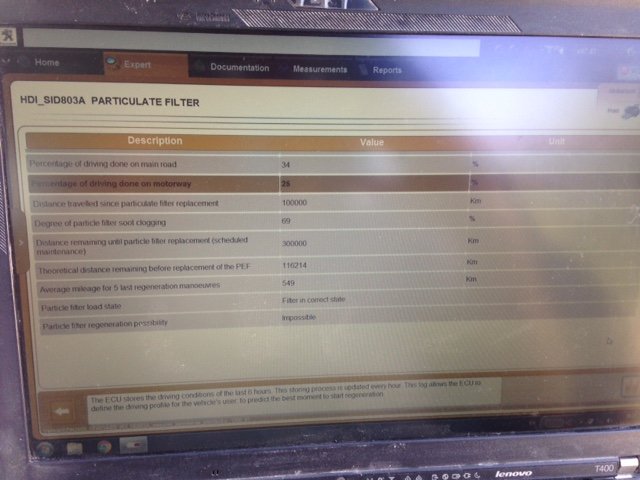

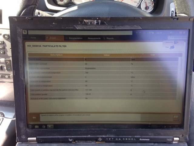

Just been to see a classic car show (photos to turn up on POTD) and was checking fuel figures, seems better but I'll have to do more miles to get an accurate figure, and I noticed that it changes gear earlier. Remarked to my self how smooth it feels......then it had a surge! Not regular and if booted it took off but when easing off revs drop to 800. It's like the accelerator becomes a switch? I've looked in Diag to try and find where the potentiometer measurements are but can't, any ideas? Whilst I was in there I did notice that the soot was at 77%. Would this be normal?

at 77% soot the FAP will most probably attempt a regeneration the next journey you take, try to make it a long one with some fast roads if possible

Chris, there's still a bit of the old stuff in there but I did a double change yesterday (7 litres). Just thinking back to the first 2 times it played up, it smelt hot and the second time when I opened the bonnet there was 'smoke' rising back the back of the engine. I was told the eolys fluid was refilled last year and after seeing the soot data and the fact that the regen status is regeneration I'm wondering if this could be connected, though I may be completely up the wrong tree as I'm still getting my head round these computer driven cars. I would have included the other 2 screen shots but the sun got them! I take it this car hasn't got a particulate filter ECU because it shows as not present. Are there any other screen shots that may be useful to someone with more of a clue than me? In 3 weeks the car has got to get me to Lyon and back, then shortly after, Wales. Not filling me with confidence. The fault does clear itself but without knowing why....

I can't quite read those pics, a bit low-res unfortunately. If you like I can take some to compare but the important bit is that after a regeneration, the soot level in the filter value drops significantly. This is calculated from the differential pressure sensor surrounding the DPF.
