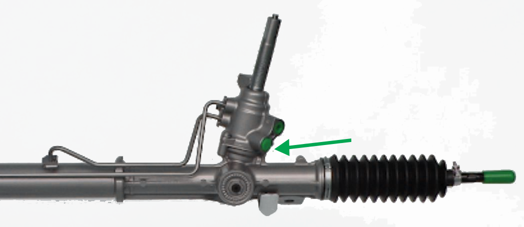

I've ordered a set of these Mike:
https://www.ebay.co.uk/itm/PEUGEOT-CITR ... 3193195357
Have a look in the description later down the listing - seems they are suitable for earlier C5s - and I'm also hunting for some Green HNBR ones as back up because knowing my luck the O ring will fall out and forever be lost in the pit.
How much difference are the small differences in measurements going to make? - I mean the ones in the kits are 1.9 or 1.78 as opposed to 1.8 and some are 1.9 x 8.8
I'm going of course by the ones in the kit I mentioned above that are one for the low pressure and one for the high pressure pipe I assume:
7.6 x 1.8mm
8.7 x 1.8mm
7.6 x 1.8mm
8.7 x 1.8mm

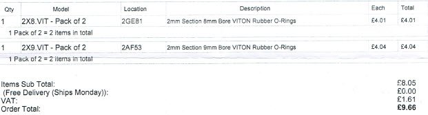

I went for Viton rather than HNBR. (6,000 miles a still going strong)!! "Touch Wood" as it seemed to tick all the right boxes. Bought mine from Simply Beraings https://simplybearings.co.uk/ for £9.66 free delivery (2 of each minimum order)
1 x 2mm Section 8mm Bore VITON Rubber O-Rings ,
1 x 2mm Section 9mm Bore VITON Rubber O-Rings,
Details about Viton here = https://o-ring.info/en/materials/vitonr--fkm/

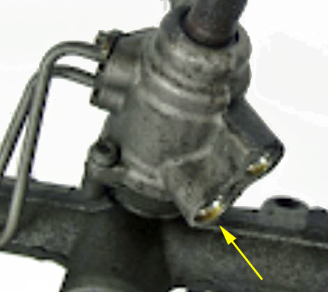

Stu, thanks for that link. So just to confirm, yours was leaking in the same place as I’ve arrowhead?
And the larger rings seem to be fine then?
I will get onto them tomorrow. That’s brilliant, thanks.

So I have ordered these this morning and the same sizes as you Stu. Fingers crossed.

GiveMeABreak wrote: 13 May 2018, 20:04 Stu, thanks for that link. So just to confirm, yours was leaking in the same place as I’ve arrowhead?
GiveMeABreak wrote: 14 May 2018, 10:39 So I have ordered these this morning and the same sizes as you Stu. Fingers crossed.
Sorry not got back sooner. But, Yes, but... mine was not leaking, these are the two o-rings I bought when I replaced my rack, dimensions taken from another, post by Bobbins but fitted nice.
bobins wrote: 14 May 2017, 12:22 Notes:
........ The two sizes of ring are approx 8mm int dia x 2mm thickness, and 9.1mm int dia x 2mm............
Problem is when you remove the torx screw that holds the pipes in place one pipe did not move without the other so did you order both sizes?
Hopefully, the seals have gone and not the pipes that are cracked, also, as it is stated that the seals only come with the pipes....Did your main dealer actually get new seals or just used the old ones.
Good engineering practice is to replace all seals when a joint is disturbed, Bad Engineering Practice is to use the old seals if the new ones are not available!!

Yes, I ordered the Peugeot ones (one of each in the ebay link), plus for backup I ordered 2 each of the ones you got - identical Viton O rings same size as you.

Update:
Car finally got into the indy today, and they've just called to tell me that it IS the rack leaking! So they will be doing the timing belt replacement and the ARBs, whilst I now source another rack - which WILL NOT BE A CITROEN sourced one after the last fiasco. It turns out I actually had the last one replaced Oct 2014 - so longer than I thought. I'll be giving that company a ring a few posts ago now.
