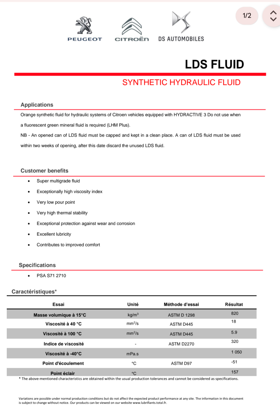

Mannol website, datasheet:
https://www.mannol.de/products/operatin ... -lds-fluid
TDS at the bottom of the page:
Total LDS datasheet:
https://www.online-lubricants.co.uk/pro ... fluide-lds
Hoped there'd be some viscosity data but nowt listed.PSA S71 2710
DIN 51 524-3
ISO 7308
Material Safety Data Sheet:Specifications:
• PSA S71 2710
Viscosity Kinematic (40°C): 17 mm2
/s (ISO 3104).

On viscosities, kinematic viscosity centistokes = centipoise / density
so the oil density needs to be known to compare the two but is going to be around 0.8 g/cm3 so cSt will be about 1.25 times higher than cP.
