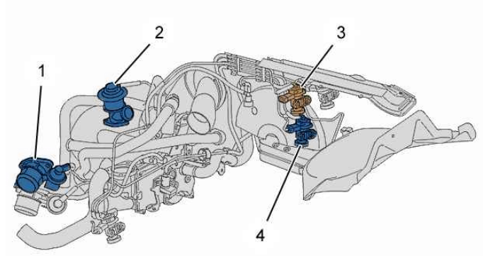

Here are the checks you can make concerning the EGR & throttle butterfly housing - you'll need a pressure testing tool though...
EGR Solenoid Valve
Check to be carried out off-load between the electrovalve ( 3) (blue connector) and the EGR valve (2) (tube marked in blue).
Connect the tool [1] as an adaptor between the electrovalve (3) and the EGR valve (2).
Compare the values read with those of the table below.
Butterfly Housing Electrovalve
Check to be carried out off-load between the electrovalve ( 4) (black connector) and the butterfly housing (1) (doseur cold) (pipe with white mark).
Connect the tool [ 1] as an adaptor between the electrovalve (4) and the butterfly housing (1).
EGR Valve
Connect the tool [1] on the take-off (a) of the EGR valve capsule (2).
Apply a vacuum of approximately 0,6 bar to operate the valve.
When the vacuum is suddenly cut off, the valve should click as it returns to its seat.
Repeat the operation several times
Remove the air duct between the air/air exchanger and the butterfly housing ( 1).
Disconnect the pipe (white mark) at the electrovalve ( 4) (black connector).
Connect the tool [ 1] to the pipe with white mark.
Apply a vacuum of approx. 0,8 bar, the flap (b) of the butterfly housing (1) should be closed.

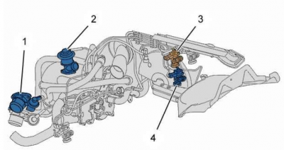

EGR Solenoid Valve
| Engine speed | Vacuum value |
| 780 rpm | 0,5 bar |
| 2500 rpm | 0 bar |
| 780 rpm | 0,5 bar |
| 2500 rpm | 0 bar |

Marc - in your first diagram, the electro valve is part number 1628LQ, how ever, what is part number 4 used for if 3 is the electro valve? I though 3 was for the wastegate?
Simon

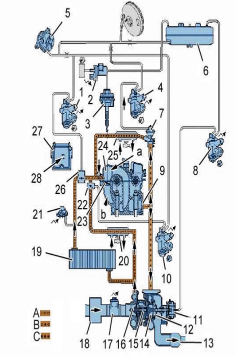

This is the Bosch setup for the DW12TED4 Engine that might help with the EGR Function and parts identification Simon:
Click to Zoom Diagram
| Reference | Designation | Remarks |
| 1 | Throttle housing control electrovalve (EGR) | |
| 2 | "Swirl" control electrovalve | |
| 3 | "Swirl" control diaphragm | Vacuum-controlled |
| 4 | Recycling regulation electrovalve (EGR) | |
| 5 | vacuum pump | |
| 6 | Vacuum reservoir | |
| 7 | Exhaust gas recycling valve (EGR) | Vacuum-controlled |
| 8 | Turbocharging pressure regulation solenoid valve | |
| 9 | Exhaust gas manifold | |
| 10 | Inlet air heater throttle control electrovalve | |
| 11 | Finned diffuser piston control pneumatic capsule | Vacuum-controlled |
| 12 | Finned diffuser piston | |
| 13 | Particle filter + catalytic converter | |
| 14 | Exhaust turbine | |
| 15 | Variable geometry turbocharger | |
| 16 | Air inlet turbine | |
| 17 | Air flow meter + Air temperature sensor | |
| 18 | Air cleaner | |
| 19 | air/air heat exchanger | |
| 20 | Water-to-air heat exchanger + (inlet air heating) | |
| 21 | Inlet manifold pressure sensor | |
| 22 | Inlet air heater throttle | Vacuum-controlled |
| 23 | "Swirl" control throttle | |
| 24 | Air inlet manifold | |
| 25 | Exhaust gas/water exchanger | |
| 26 | Throttle butterfly housing (EGR) | Vacuum-controlled |
| 27 | injection ECU | |
| 28 | atmospheric pressure sensor (integrated in the injection ECU) |
