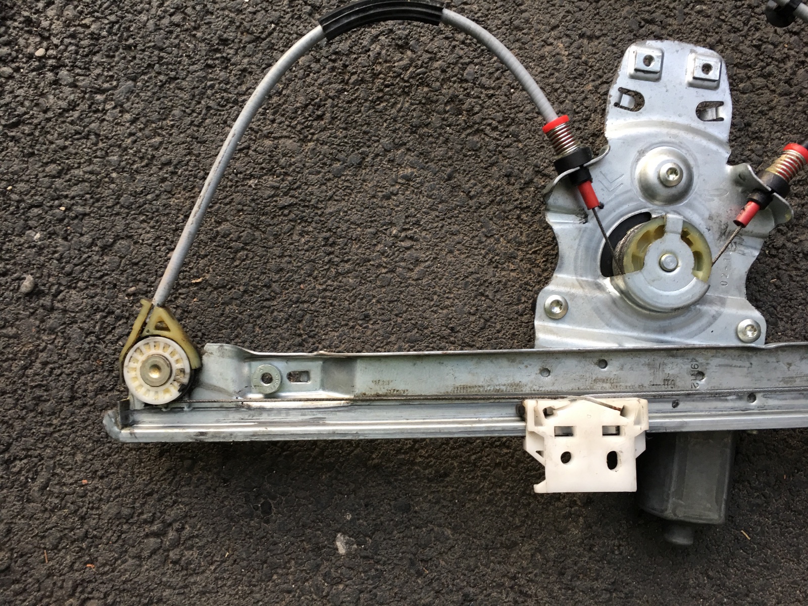

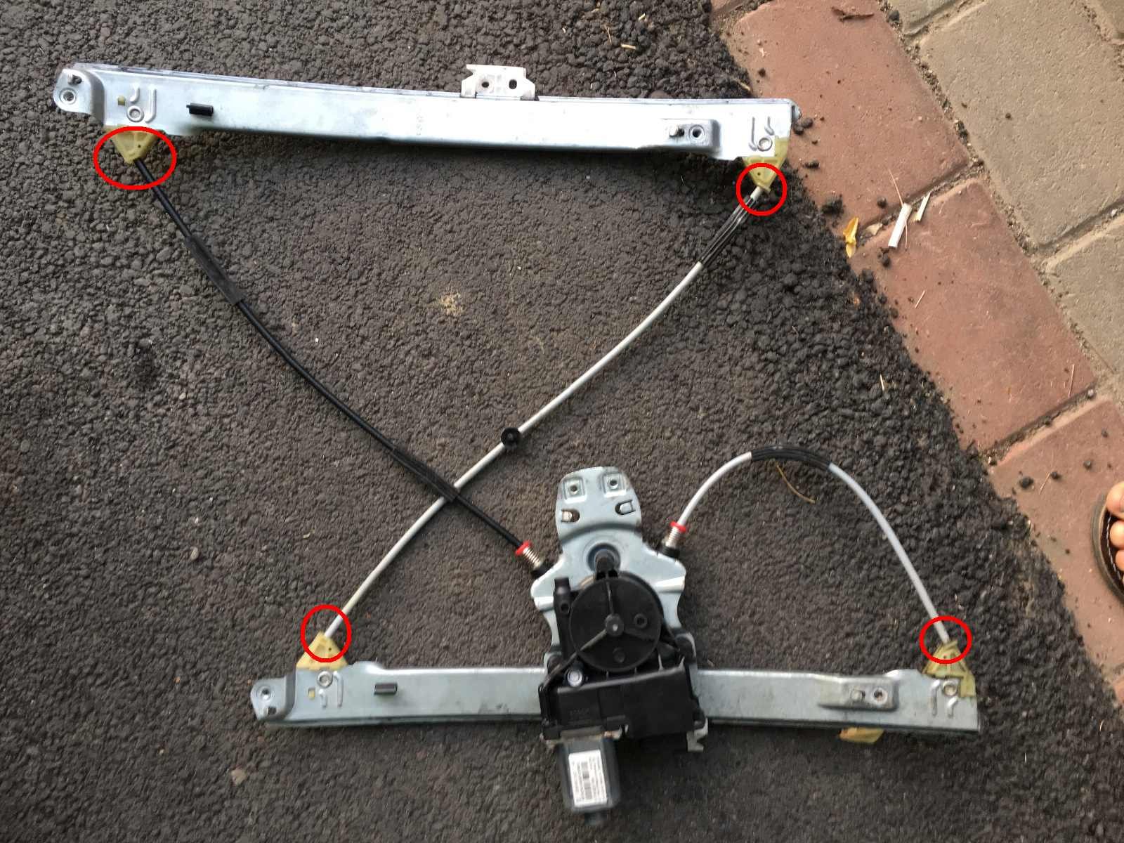

I have a frame with me here that is exactly the same as yours, and your one looks identical to mine. The only thing I would suggest is to make sure the cables I've circled in red are pushed all the way into the plastic parts in the corners.
Window frame
Window frame
I've just seen that the two springs are at different tensions when the frame is fitted into the door - one is squeezed, the other is loose.
Window springs
Window springs
Check if these change tension when you lift and lower the window

bobins wrote: 30 Aug 2017, 22:10 I have a frame with me here that is exactly the same as yours, and your one looks identical to mine. The only thing I would suggest is to make sure the cables I've circled in red are pushed all the way into the plastic parts in the corners.

I've noticed too that the tensions on those springs are different depending on the position of the window.
I will definitely check if those cables are pushed into the plastic. ..
