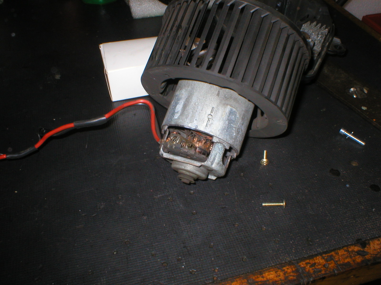

Davie, a replacement, fully tested blower will be on it's way to you shortly with your own regulator module fitted to it...
Whilst testing, I was happy to note that the brushes on this particular (Valeo) model are easily accessed and very amenable to replacement as shown in the picture below...
Suitable brushes of a near size could be obtained and filed to fit if need be...

Speaking of re-brushing cooling fan motors, I've actually dismantled a couple (albeit Ford/Motorcraft/whomever their supplier is) that were U/S and open circuit. In these cases the brushes actually had years of life left in them & very little wear to the commutator. The problem was that the brushes had got stuck in a paste of their own dust & presumably road grime/oil. Once cleaned up the fans worked with no need to replace parts at all.
Might be interesting to strip a dead PSA rad. fan & see whether it's a similar story here?

That's very likely with the rad fan motors as the one I pulled apart was full of brush dust. An incredible amount... More than you’d think could ever come from the four brushes!ekjdm14 wrote:The problem was that the brushes had got stuck in a paste of their own dust & presumably road grime/oil. Once cleaned up the fans worked with no need to replace parts at all.
Sticky brushes afflict a lot of motors in domestic appliances...
