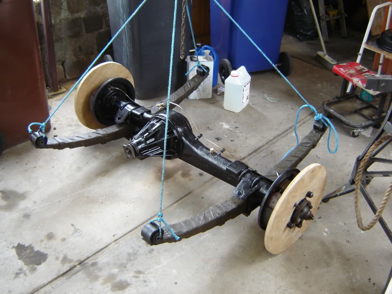

This one is for Chris. Note the Denso tape on the new heavy duty springs.

Lovely! What is that from?
Remember my 1960 Rover 3-litre had its rear leaf springs wrapped in OE thin leather "gaiters". It was a service recommended that these were periodically removed (they were laced on) and graphite powder or graphite grease refreshed in between the leaves! "Just going out to grease the leaves on the Rover, dear . . ."
Front of the car was a bit easier: long horizontal torsion bars, with a simple spanner adjustment for ride height.
Everything on the car was big, including the rust problem. If only I knew then, what I know now! IIRC the car weighed in at 33cwt (1.65 tons), with a matching 33 pints (19 litres) for the cooling system, and a 20 gal (91 litre) fuel tank. Being manual, she did return about 22mpg, which some here would be happy with, it seems!
With its Connolly leather bench seat in the front, and an incredibly long-travel forward-reaching gear lever. This made driving exciting, especially when two front passengers included mini-skirted young things, in the days when.........
A great picture, lexi !

I remember quite a few of the 'quality' cars in the '50s having wrapped springs and in the DIY world greasing and wrapping them was advocated to improve the ride and lengthen spring life.

Thanks Chris.
That was from the 62 ser 11 Landy. Wooden wheels to aid moving around and then rolling under to bolt up. Crazy Tractors but fun!

Leave the wooden wheels on, you will not notice in a LandRover :)

I thought they were early discs. :wink:
