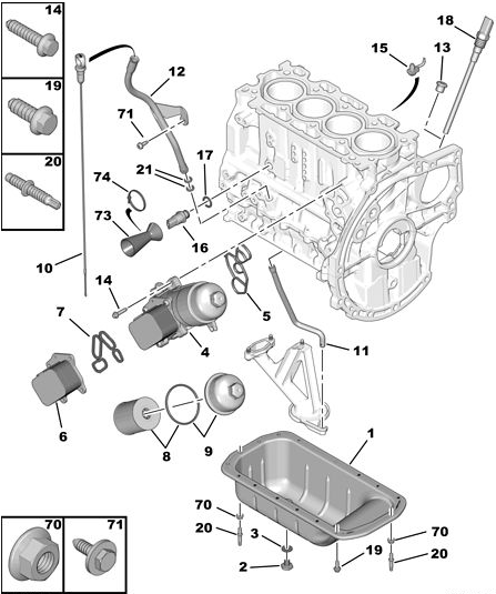

I've listed both parts as it depends on the sump fitted. You may have a 10mm Diameter plug / seal or 16mm, so you need to visually check it
10MM:
(1) Drain Plug Part: 031129 (M10 x 125 EP13) £1.31
(3) Drain Plug Seal Part: 031340 (21 x 10 -1,5) 10mm Diameter. £1.49
Or:
16mm:
(1) Drain Plug Part 031139: (M16 x 1,5) 16mm Diameter £1.62
(3) Drain Plug Seal Part: 9677491780 16mm Diameter £1.97
All VAT inclusive from Citroen.
10MM:
Or:
16mm:
