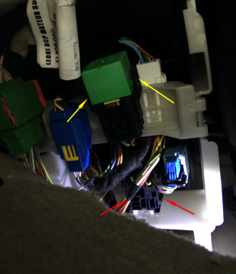

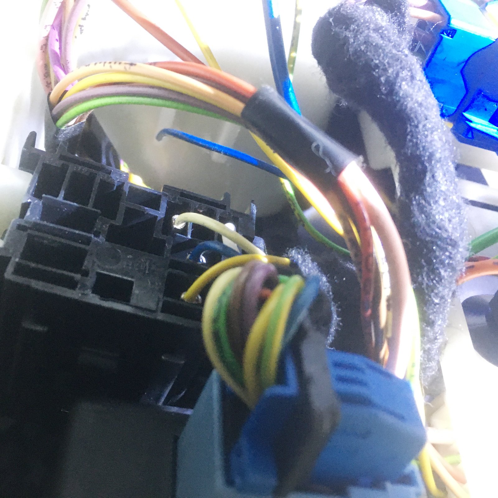

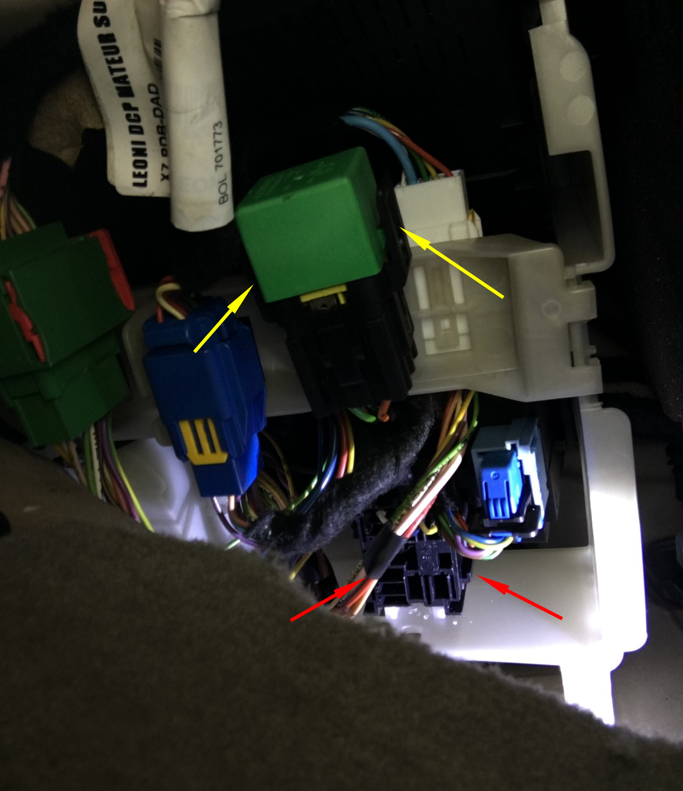

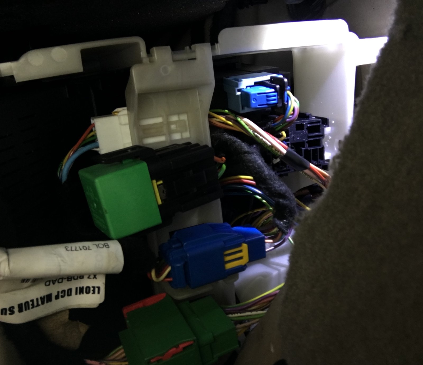

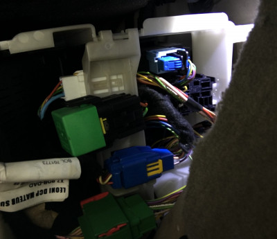

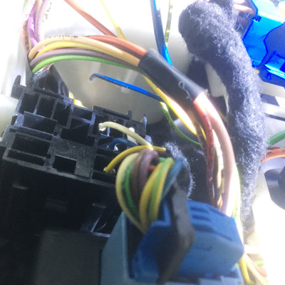

But I have found the relay. I just can't work out how to remove it. The photos attached show the general view looking up from the footwell & in the second pic is a clear view of the underside of the relay mounting (the black bit with the yellow, blue & white wires going in). I have used a reasonable amount of force trying to release it but I don't know exactly how it's held & I don't want to break anything. It would be nice to see the whole assembly removed from the car to see how it's fitted. Any suggestions greatly appreciated. TIA
Adrian
Thanks for the reply. I couldn't begin to contemplate the contortions you describe! I'm far too old & decrepit!
Adrian
- x 6946
Re: C5 Mk3 X7 Autobox Interlock Relay
If you look at the relay housing that the green relay fits into below, I have arrowed in yellow the securing tabs. You'll need to carefully lift the similar tabs of the housing connector the other relay is inserted into where I have arrowed in red. So a small flat blunt screwdriver or similar probably needs to raise the securing tabs up on each side before you can pull it out of the housing (which is the visible part with the wires going in and the relay is underneath).

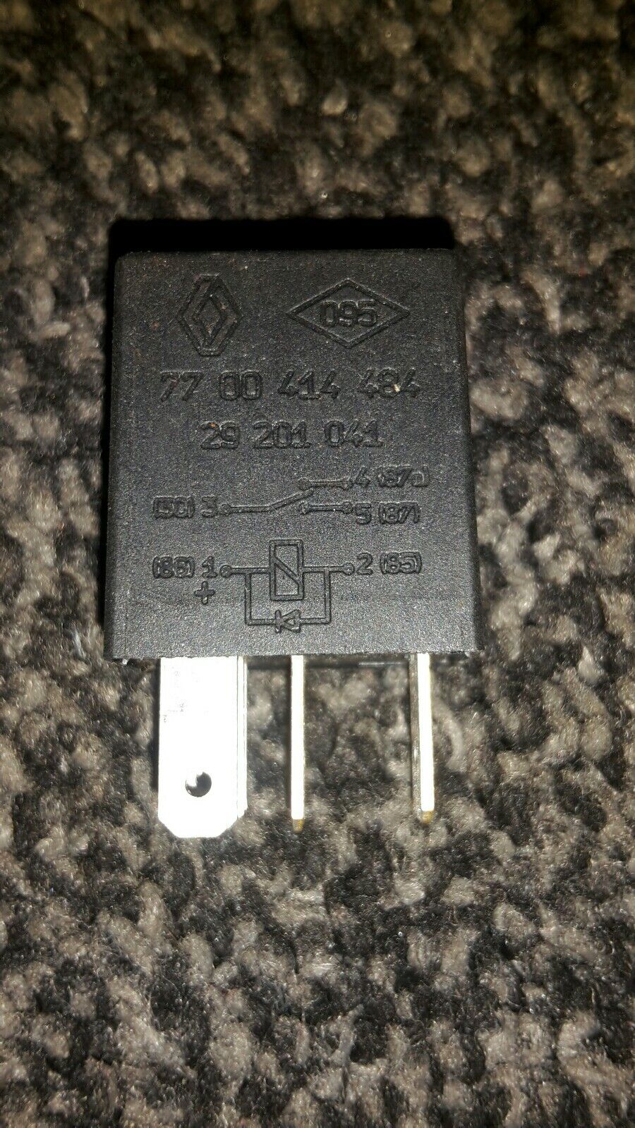

From memory the relay I changed was a black and smaller than that green one.
Your car is a later model than mine, perhaps it was changed to be a larger green one?
I would have someone repeatedly press and release the brake pedal for you whilst you double check by feeling the click from the relay if possible. (Ignore if you are already sure that it is the green one)
in fact I could almost swear that the relay I changed was one like this:
Thanks (yet again!) Marc
I'll have another crawl into the footwell when I get a chance. Don't suppose those clips would release the mounting would they? There is no way I could get to the relay above the mounting that I can see. I think the only way is to remove the whole mounting to reach the relay. It is achievable as previous posters on this thread have proved though one had to resort to removing the glove box which I would like to avoid. I'll let you know how my next attempt goes!
Thanks EDC5
I've just posted a reply to Marc as your post came in. The relay on my car is smaller & black & is fitted to the mounting that the red arrows point to. I'm sure it is almost exactly the same as your photo. This was located exactly as you described. My problem is that I can't work out how to remove the mounting as I can't reach the relay which is inserted above it. I'm going to have another go shortly!
Thanks
Adrian
Finally got round to replacing the relay today. It took about 10 minutes! I realised that in order to free the relay mount you have to slide it upwards first & then down! Changed to the new relay & tested it. Worked fine for the first half dozen times then went back to it's old ways. I disassembled the one I had taken out & couldn't find anything wrong with it. The contacts weren't particularly dirty but I cleaned them up anyway. I put the old relay back in & now it works first time every time. Don't know why the new one didn't but that's now being kept as a spare.
Nice to get that one sorted & thanks to all those who have helped. Having done the job now I could do it again in less than 10 minutes total!
