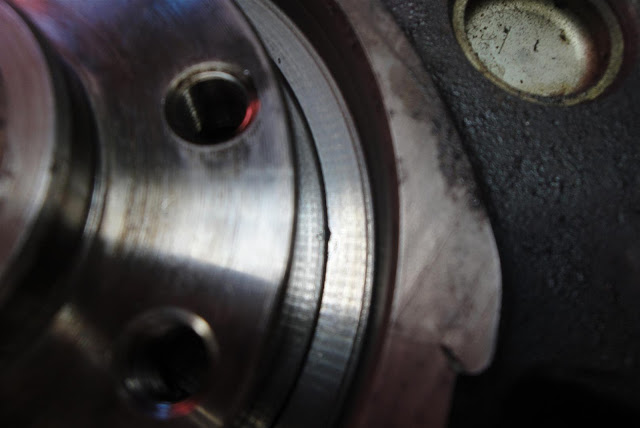

Ayyy Help! Disaster strikes.
Whilst using the technique to take the old oil seal out as suggested in Haynes- as I was drilling to be able to insert a screw into the old seal, it looks like i've put a nip in the seal housing- i'm very surprised as I used a low-power electric screw driver to drill precisely to reduce risk of any damage. Dont understand how it happened.
Have I just ruined my car? do you think this there's any chance that this might not ruin the seal?

- Posts: 10980
- Joined: 09 Nov 2005, 22:03
- x 1463
Re: Xantia crankshaft oil seal and clutch
I don't think the knick will cause any serious problems as it is not near the sealing surface. I would just reassemble carefully and cross my fingers.
