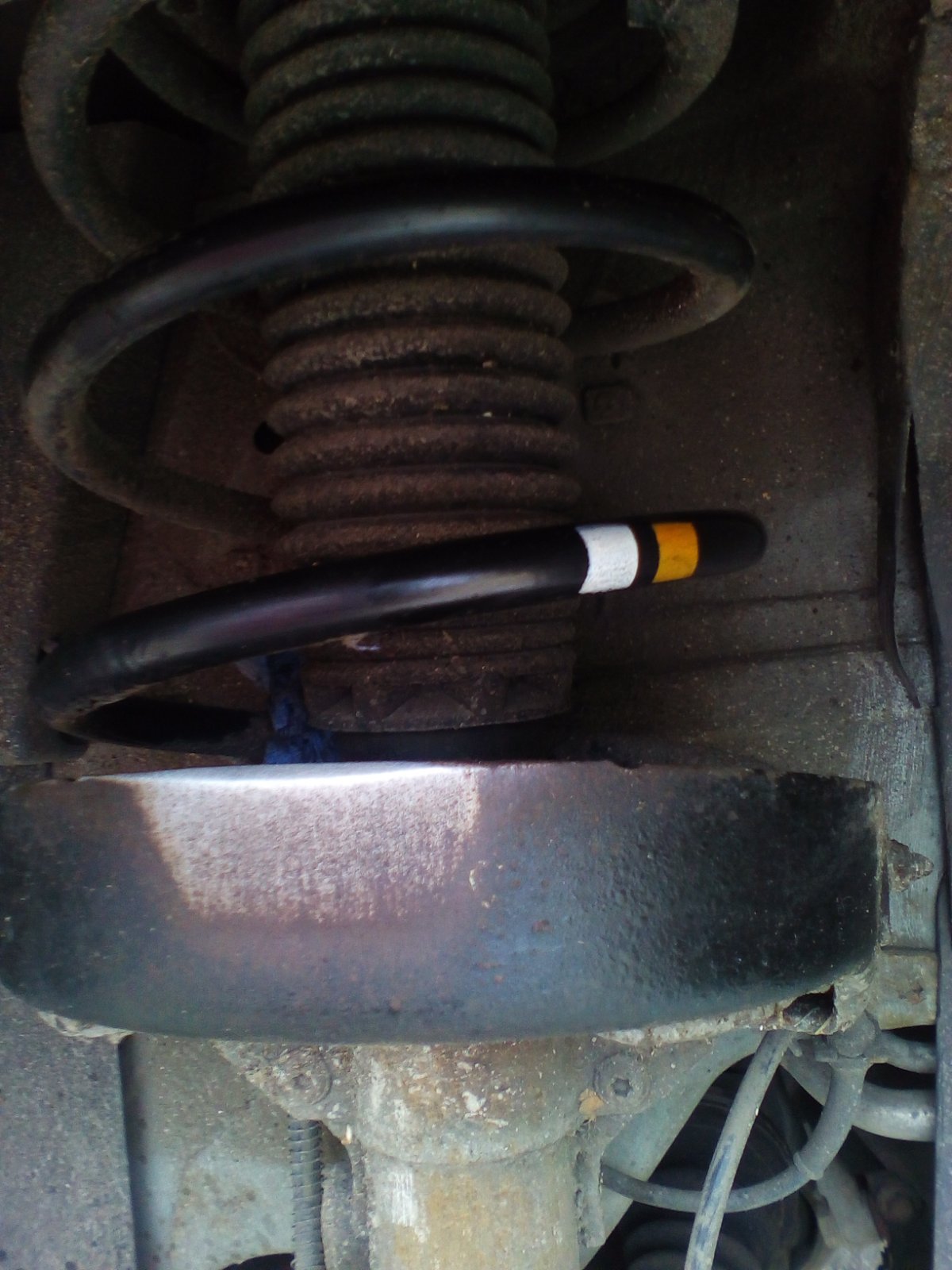

Checking for any other water damage .. Abs stuff all ok , but noticed this rubbing mark on the strut base... Ain't got a clue what's caused this both sides are like it
Cheers for any pointers
My photo didn't upload.....

that's from the spring guard hitting the arch liner
mine does the same thing
