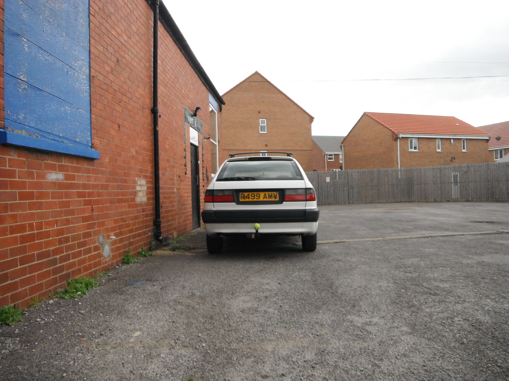

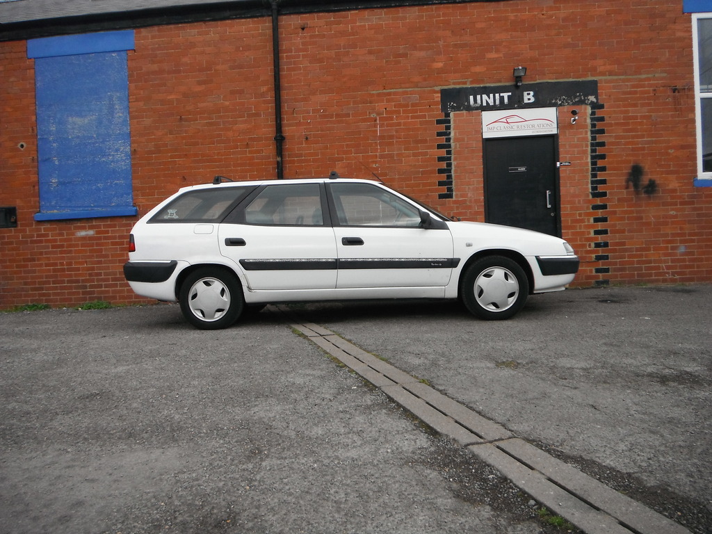

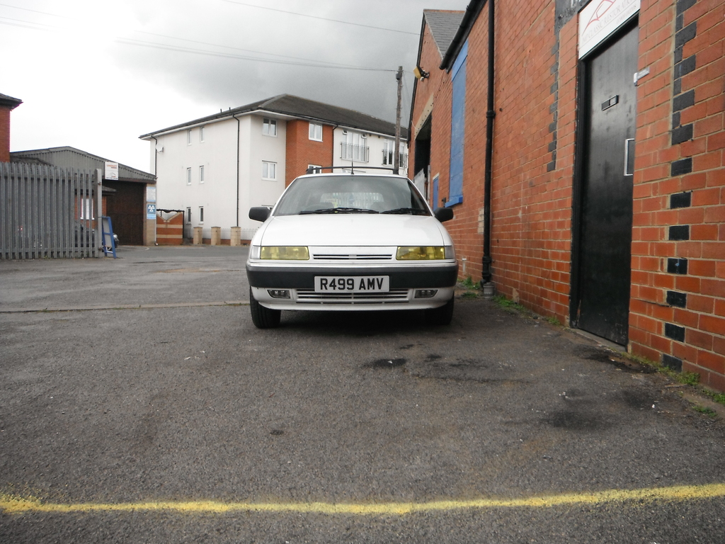

More tinkering has happened today, ride height is now more correct I think ... I shall let you guys decide
3 fingers gap between the arch and the top of the tyre!
Back sits a tiny bit lower
Looks much better from the front too!
I was expecting the pinch bolt on the Arb thing to be seized and snap off, Completely the opposite was the case! I would think that the height was altered by someone on purpose as the bolt was very easy to undo and well greased up ... bit of a fiddly job with 2 heavy axle stands and a jack, Once you know what your looking at it's all straight forward enough I guess
Now the car has really floaty suspension and soaks up the harshness of the local speed bumps really well (I am impressed)! But it is not still without it's problems ... all of the height settings work as they should, that is apart from the low setting to normal ride height! All the corrector seems to be nice and free moving enough but now the front will not lift at all without waiting for the rear to lift and then popping it into intermediate for a second!
I no longer have the will to chase the suspension faults as it's breaking my head a bit, so she is off to Citromatics on Martinet road, Thornaby on Monday morning for a check up to see what is going on with the suspension. I would say it will be nothing, but this is my car and it will more than likely need every single component to be replaced before it works properly!
