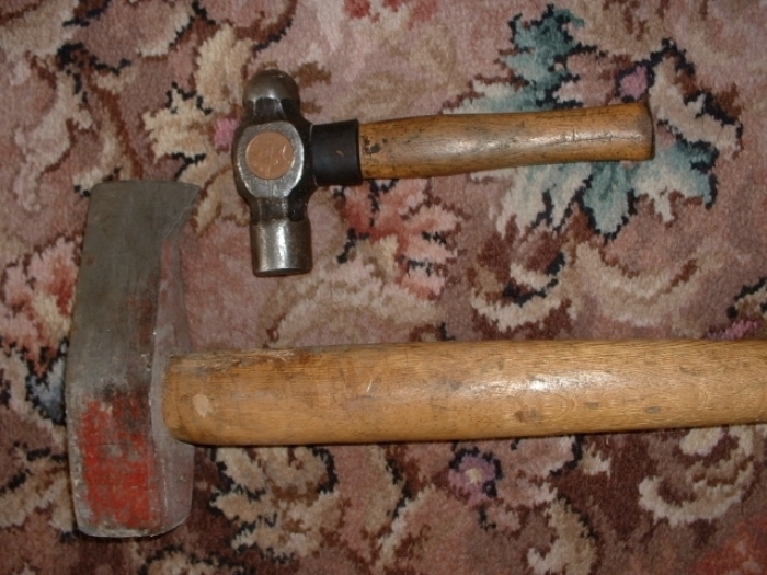

One of these should do
The little one is only 1.5 Ibs but a nice stubby handle
The big one is a whole new ball game
Lovely carpet
Lovely carpet

Re: 2.1 TD Xantia on a budget
I find bracing my feet against the opposing rear tyre and swearing a lot helps too, failing that its straight on to the blood sacrifice, I lost about a square inch of skin from my forearm changing my accumulator, blood everywhere, the car positively purred

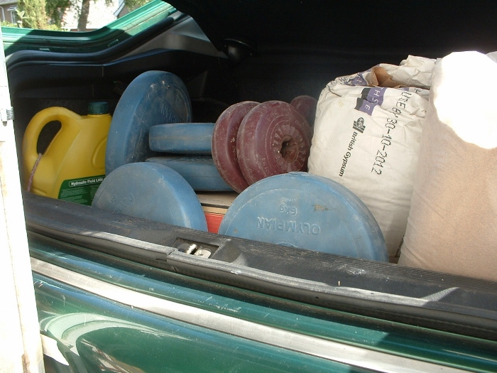

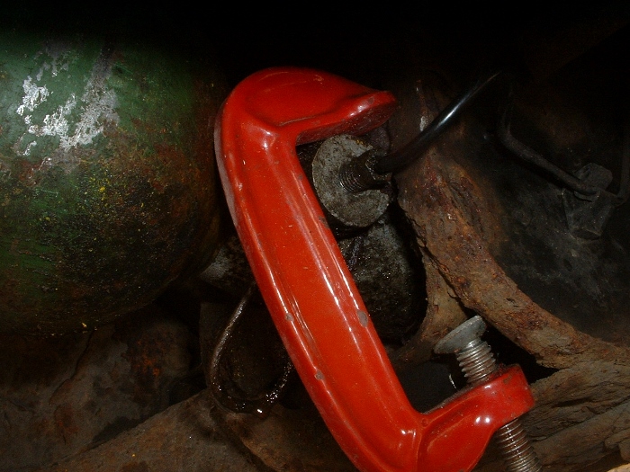

Cheers Stewart / CitroJimStewart(oily) wrote:Have you added weight to the back of the car ?
Courage mon brave!
I've emptied half the garage into the boot
and started her up again and she rose another 3" higher at the back - without doing anything else to her - makes me wonder if there's a problem with the rear height corrector
I've also clamped the suspension cylinder to make sure it can't rotate (belt and braces)
..... spheres arrived yesterday just waiting for the tool now ....
hopefully that extra load on the suspension will be the key ..... just need to 'carb up' now for the effort needed to crack the spheres off ...... must remember to lower and depressurise after that before I get too carried away in the joy of the moment .....

Make certain that you have the suspension on high, with axle stands (or something suitable) to "catch" the car if she drops (make sure they are high enough to protect you), but with the weight on the wheels. If the spheres turn (but not the cylinders, obviously), make sure not to go past 1/4 of a turn.

2 rear suspension spheres fitted
tool worked a treat and would have struggled without that and the 'add more weight' tip
from CitroJim and Mandrake
