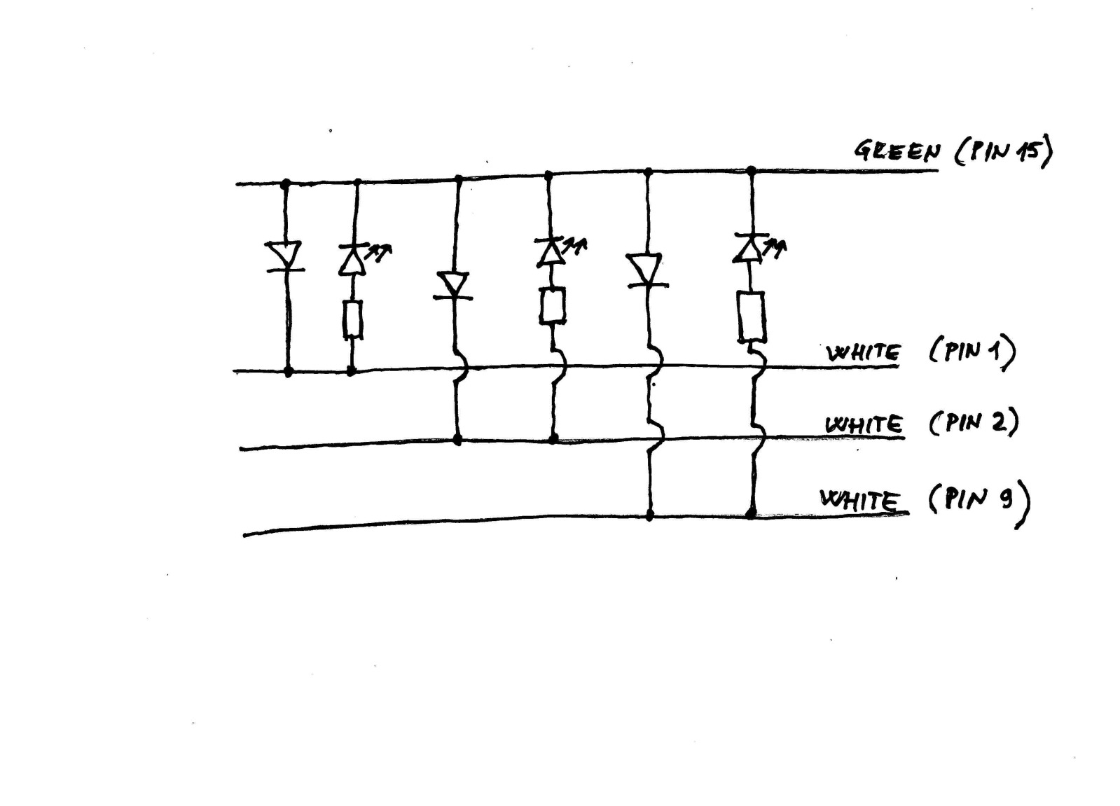

So the electrical layout should look like this:

Yes that's correct. :)
I only used one LED monitoring the front electrovalve because front and rear should always switch together, however there is no harm in monitoring both. The Activa electrovalve on pin 9 will operate at different times than the other two and will be in the reverse sense - it should light up during hard cornering while the other two will go off.
The normal front and rear electrovalves should also switch to hard (LED off) during heavy acceleration and braking, however I believe the Activa electrovalve will only come on during (hard) cornering and not during straight ahead acceleration and deceleration. (Note: I've never driven an Activa so this is supposition based on the system design)

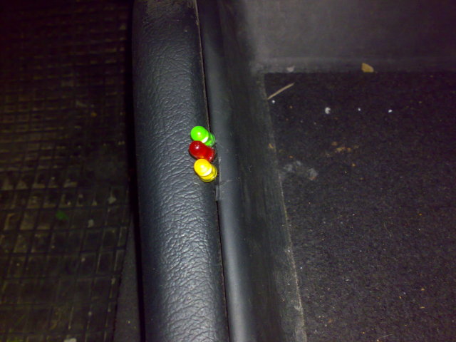

I have done the light diodes mode and here is how it looks:
The green and yellow are for the front and back electrovalves and the red is for activa electrovalve.
As far as I can tell the electrovalves are working, but the car is still stiff. Like I said it was a jolly good ride, when they were switched to 12V (which was wrong but nonetheless)...
Ok here is how they operate:
- ignition on; ON
- opening door, ignition off; ON for quite a few minutes
- closing door, ignition off; ON for half a minute
- slow accelerating (cruising) and gear change; OFF/ON every gear change (but just when starting the car from stand until 5th gear, then they are ON if I change gear)
- sport button on; ON (they should be OFF right?)
The activa valve switches ON on cornering (cruising speed) and not only on hard cornering.

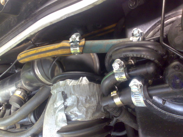

But of course some new problems... I had to change one pipe on the LHM filter because the old one just fell apart.
Just improvised with what had at hand and this is how it looks (it's not nice and maybe causing me problems):
