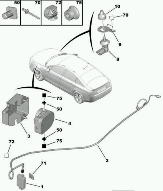

Anyway, back to the issue, now that I have all the data for your car. It seems that you should have the following parts according to the specs, but in case not here are the parts:
(50) Plate Screw - Part 6680 G6
(70) Rivet - Part 6973 05
(71) Hog Ring - Part 6991 V0
(72) Hog Ring- Part 6990 A7
(75) Nut with Base - Part 6936 C9
So you will need the wiring components, siren and control modules:
(1) Control Module - Part 6680 V1
(2) Anti Theft Alarm Sensor - Part 6680 S4
(3) Siren Bracket Anti Theft Alarm - Part 6680 R7
(4) Anti Theft Alarm Siren - Either Part 6680 S5 (or the replacement Part 6680 W7)
(8) Contact Switch - Part 6366 93
(9) Contactor Bracket - Part 6680 S6
(10) Buffer - Part 8711 50
The coding option within Lexia is designed for this Alarm system only and when the above components have been fitted, then you would enable the option within the BSI - or get the dealer to do it for you. Don't change any settings using the Lexia for any other Alarm system, otherwise you may find you can't start the car.
