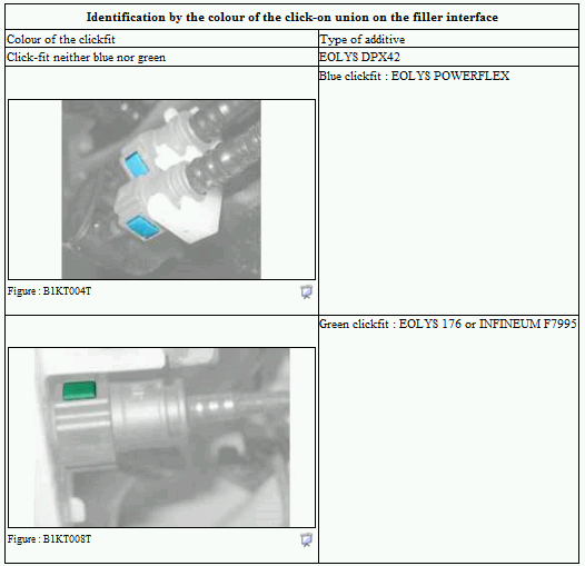

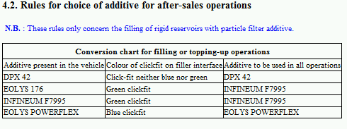

rmunns wrote:I don't know (a) whether I have FAPS on this car and (b) what to look for on the dash if I do indeed have FAPS and the fluid gets low.
A) for this HDi engine you will have a DPFS on the car. B) When the additive is low, you will get the SERVICE warning lamp lit, with an audible warning and a message on the multifunction screen.
Now as for the type of additive, you would have to check by the click connector colour as to what type of additive you have and need. Despite all the info in this thread, I'll simply quote from the service Doc notes regarding the 'Modification: particulate filter additive': Here is where the click connectors are in the first diagram and in the second, the table showing the 'rules'. There are of course soft pouches of additive, and these have part numbers, so this concerns the 'rigid' reservoirs.

Good info for those of limited knowledge however it does not talk about modification of fluid, just shows a way of identifying what you have and effectively says "fill with same" except in the case of Eolys 176 where Infineum F7995 may be used as a replacement.
