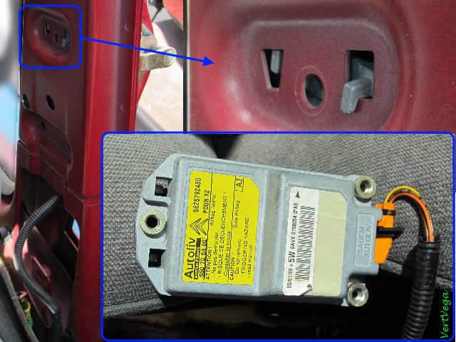

Thanks to CitroJim, I now know why Gracies' side airbag light is on. The NS ECU is not responding to queries (it appears to have gone down to the pub without telling Gracie). Jim has told me that I need to take the trim off to get at it, but (due to time constraints) we weren't able to do it then. Please can somebody explain how to remove the trim cleanly. I would like to find out what the problem is, and get it fixed.

Re: My Xantia needs knowledgable help!
Removing that trim is easy James...
Send the passenger seat fully forward and where the trim splays out at the bottom by the sill you'll see two T20 Torx screws. Remove those and gently prise the trim off - bottom up- it is held at the top under the top part of the trim and will just slide from under.
You'll see the ECU hiding in there. It will have an orange label on it...
After following CitroJim's instructions you'll see the ECU.
Pics combined from a scrap car. Mine doesn't have a side airbag.

Thanks to both CitroJim, who narrowed down the fault, and mirafioriman for providing the side airbag ECU, Gracie is now aware of all of her airbags, and has stopped showing any warning lights. Thanks gents, your assistance is much appreciated by both myself and Gracie!
