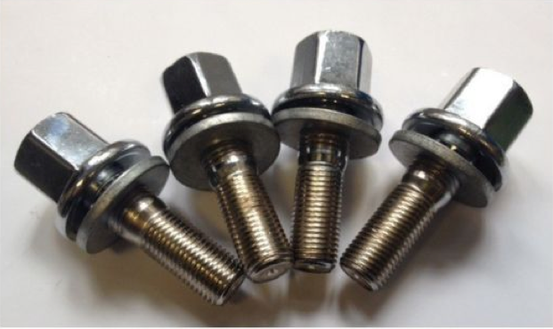

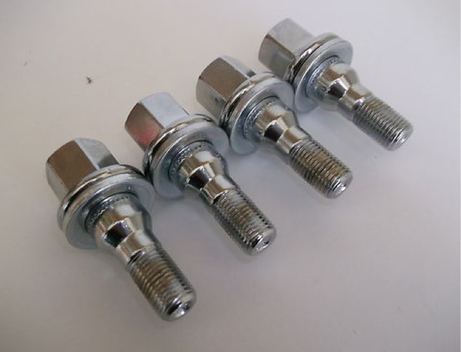

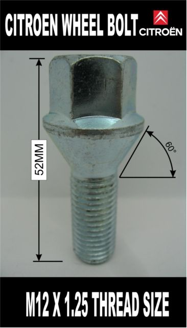

I've seen the Xantia use x2 main design types (as does the Xm too), although
there is a subtlety that could be significant to the alloy bolts where they look
almost identical but aren't!
All x3 types are M12 with a 1.25 pitch metric fine thread with a 19mm hex head.
Steel Wheel:
Standard Alloy Wheel - square shoulder:
Alternate Alloy Wheel - tapered shoulder:
The MAIN key significant difference is the 60 degree shoulder seen on steel rims
AND the flat/square captive washer type as seen on the alloy rims. The main
thing to be aware of here with the two types is they aren't interchangeable and
cannot work if you try swapping between them - the 60 degree ones are shorter
and won't reach into the hub
The same follows with the square shoulder bolts being too long and going too
far into the hub and damaging it as the run out of the thread near the hex head
then damages the thread by burring it off. Don't ask me how I know and don't
try these even in an emergency flat/wheel swap.
The slight extra element of confusion arises where I have seen the hybrid midway
on a couple of VSX alloy rims where they are usually designed with a square shoulder
yet have a tapered 60 degree taper and marginally longer bolts than the steel variety.
Good old Citroen although there's no knowing what previous owners and garages get
up to so it may not be their fault!

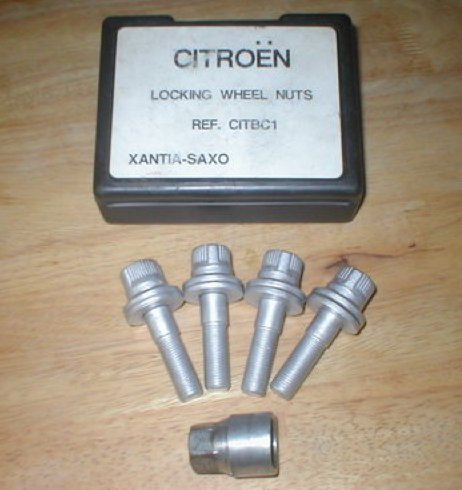

The locking bolts if you're daft enough (or unlucky) to still have them fitted usually
come as x2 designs. The first is a kind of shaved edges hex and the second uses
x4 very fragile pins that engage in the corresponding cut out holes in a rough plough
star constellation styley in the head of the shorter headed bolt:
I will post the other pin design type when I find one to picture. I've had to have x3
sets of alloy wheel bolts removed by garages with an alloy wheel bolt remover tool
as the original owners have lost the key...
Steel Wheel:

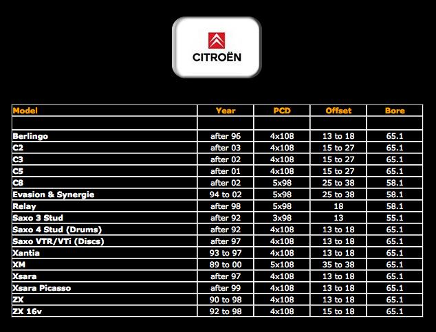

Some of this always crops up on the forum especially the spec to fit alternate
wheels so it's worth putting this in too:
