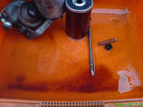

Here's the photo of the 2.5s filter and pick up -
So with this in mind I rigged up an inline fuel filter, tubing and funnel suspended from the bonnet 'hook'. I filled the filter with fresh real diesel and held my breath. No difference.

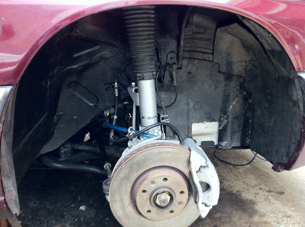

On Saturday I collected a carton of Hydraflush from GSF, so more work could be done. Brakes finished on both sides, parking brake cables worked into place. Wheel arch liners, left side ABS sensor bought off Ebay for £40 cabled tied out of the way - it wouldn't fit in the hub carrier hole but the ABS computer was happy it could see it. Cleaned out the LHM tank again (it was full of dust after a year in the shed) filters OK. Dug out a couple of spheres for the front struts. Topped up tank with Hydraflush and started the engine, it took 10 minutes or more to get the pump primed and pumping fluid. Steadily the car rose up, no creaking or leaking so that was good. Next task was to check to see if the front right flexible joint leaked so I propped the brake pedal with the jack handle. No leak! Next I bled the brakes for 5 minutes each back into the LHM tank to help circulate the Hydraflush. Wheels on next and move the car onto the front drive so that I could sweep up and get better all round access.
I spent a few hours on Sunday doing a few bits and pieces, checked the front right caliper and had to rotate the piston to allow the 'nub ' on the brake pad to sit in the piston notch.
Monday was a near full day putiing back all the little bits and pieces, washer filler 'trumpet', cleaned out the scuttle, oiled up the various linkages in the scuttle, replaced the plastic trim. Next came a thorough wash of the car to remove all the moss, algea and general dirt that had built up, a toothbrush came in usefull around the rubbers and door trims. The Lacquer (?) has really started to peel along the edge of the left front wing and door. A fair amount of time was spent trying to clean up the black but now grey plastic, unfortunately I've run out out Autoglym Bumper stuff, it's the best thing I've found upto now for bringing trim back to life.
On Tuesday it was time to tackle the front left ABS sensor that wouldn't fit in the hub carrier. A gentle sanding with a sanding drum on a rotary tool soon had that problem fixed. Now although the part number I'd bought the sensor under matched what I needed it was obviously different, the lead was slightly shorter and the rubber mountings fastened to the lead were different and in the wrong places. With a new Stanley knife blade I carefully cut through the rubber mountings and peeled them off, I did the same with the broken sensor, glued the mounting from the broken sensor lead around the replacements lead being careful to glue the rubber to itself and not the lead to allow adjustment. This allowed me to thread the sensor lead into the same path as the original. Now was the time to find out if the sensor would work with the wheels moving. With the whole front of the car jacked up I could spin the wheels, in first and second at idle no faults showed but I thought maybe the ABS ECU wouldn't until 15 MPH and above had been registered. Something an MOT tester told me once about a note on their system about XM ABS systems, which had proved to be true, during the MOT of the 2.5 the ABS light had come up during the braking test, the note on their system said to take the vehicle on the road to increase the rate of rotation of the wheels, sure enough the light went out and the 2.5 passed. Anyhow in third I took the 2.1 up to 25 MPH and no faults showed. So the two things that I thought would be a problem were fine. That ABS sensor was £40 well spent.
