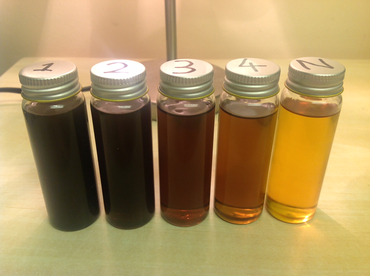

Franchute13 wrote: 03 Jun 2017, 12:53 Hi Simon!
Thank you for responding and for taking the test in your car.
When you changed the oil burned in your old Xantia, it came out dark?
Thank you
Here is a picture of the oil that came out each time I changed the oil, numbered 1 to 4. There were a few hundred miles driving between each change to allow mixing. On the far right is new unused oil straight from the bottle for comparison. As you can see it wasn't until the third change before the oil started to change from black! So one oil change on its own will not do much if the oil is really black.

Also have you done or do you plan to do any oil changes ? Although changing the heat exchanger should prevent it from overheating and prevent further damage to the gearbox or oil degradation, some symptoms of the gearbox will probably remain until the oil in the box is cleaner, and it may take 2-3 changes to get it sufficiently clean for any symptoms to go away. As you can only change about 50% of the oil each time you drain it, you are diluting dirty oil with clean oil by 50% each change.

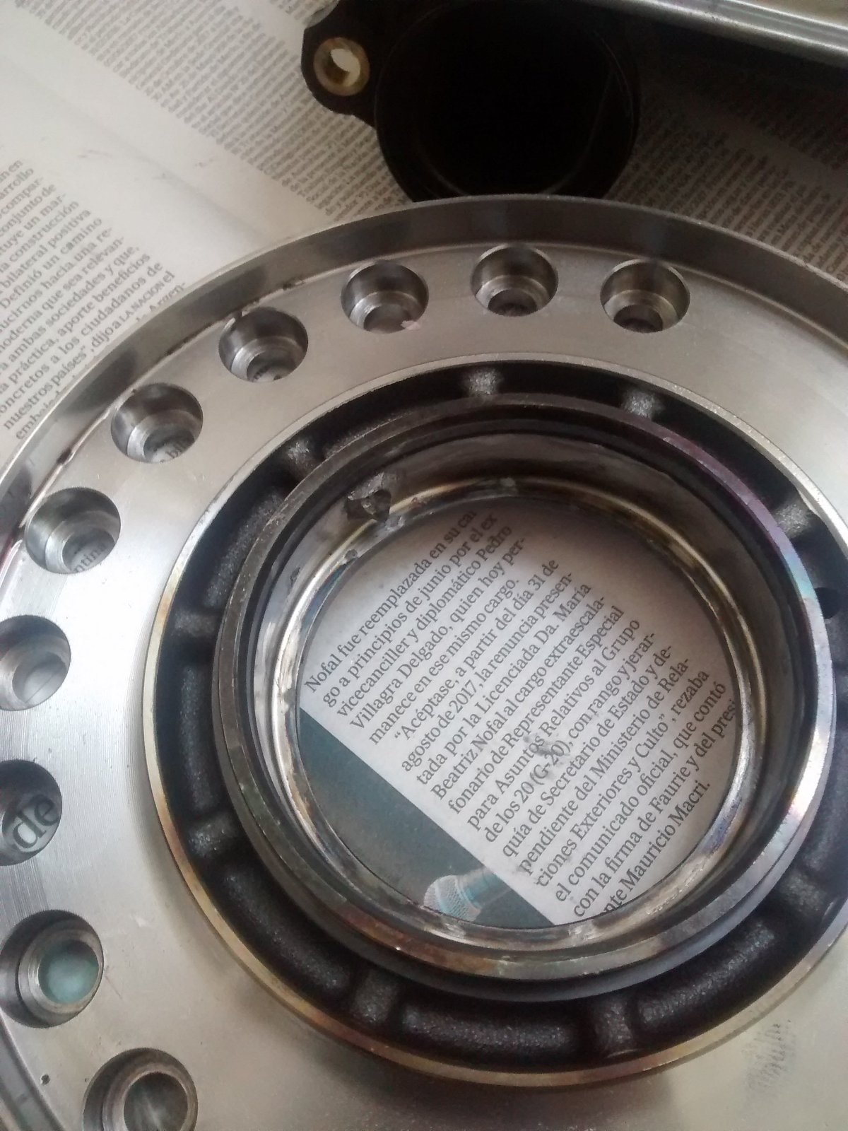

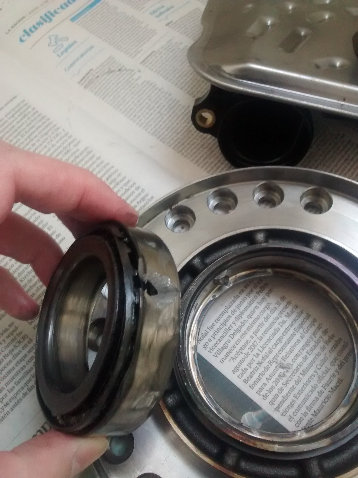

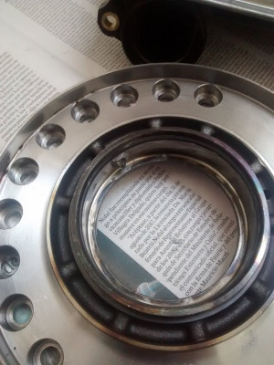

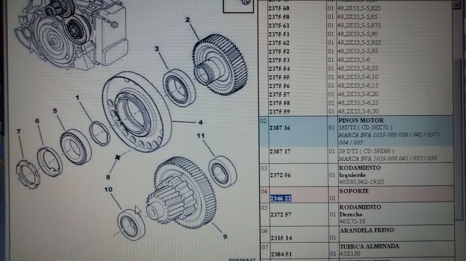

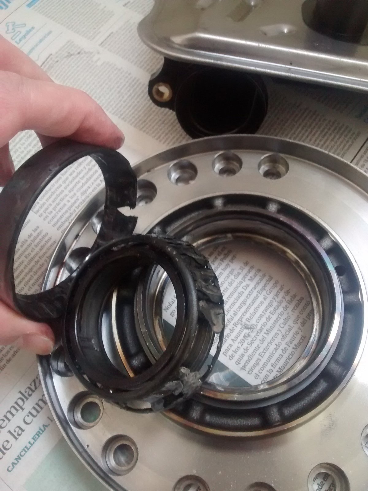

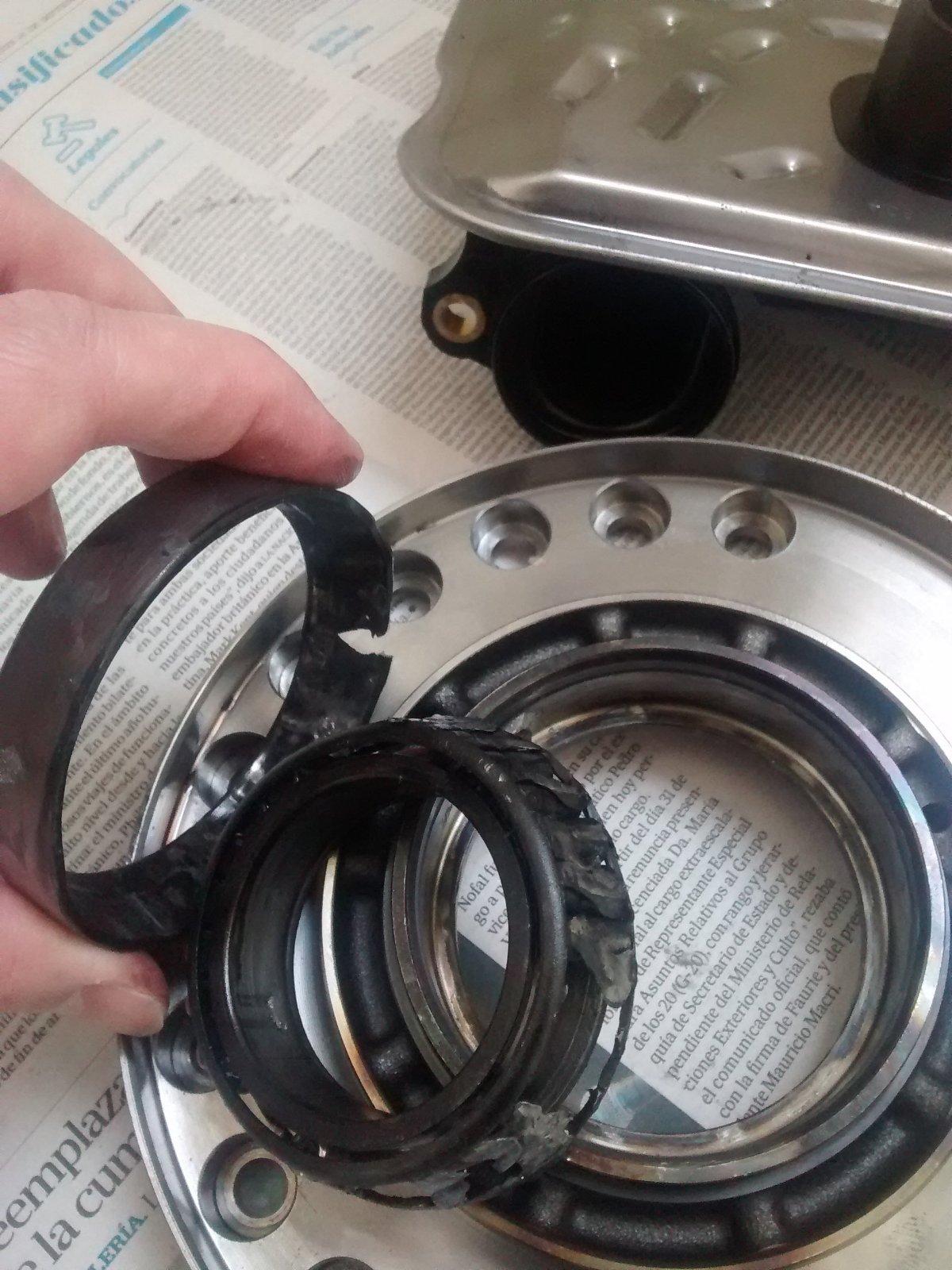

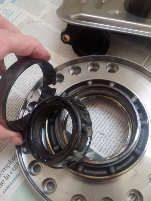

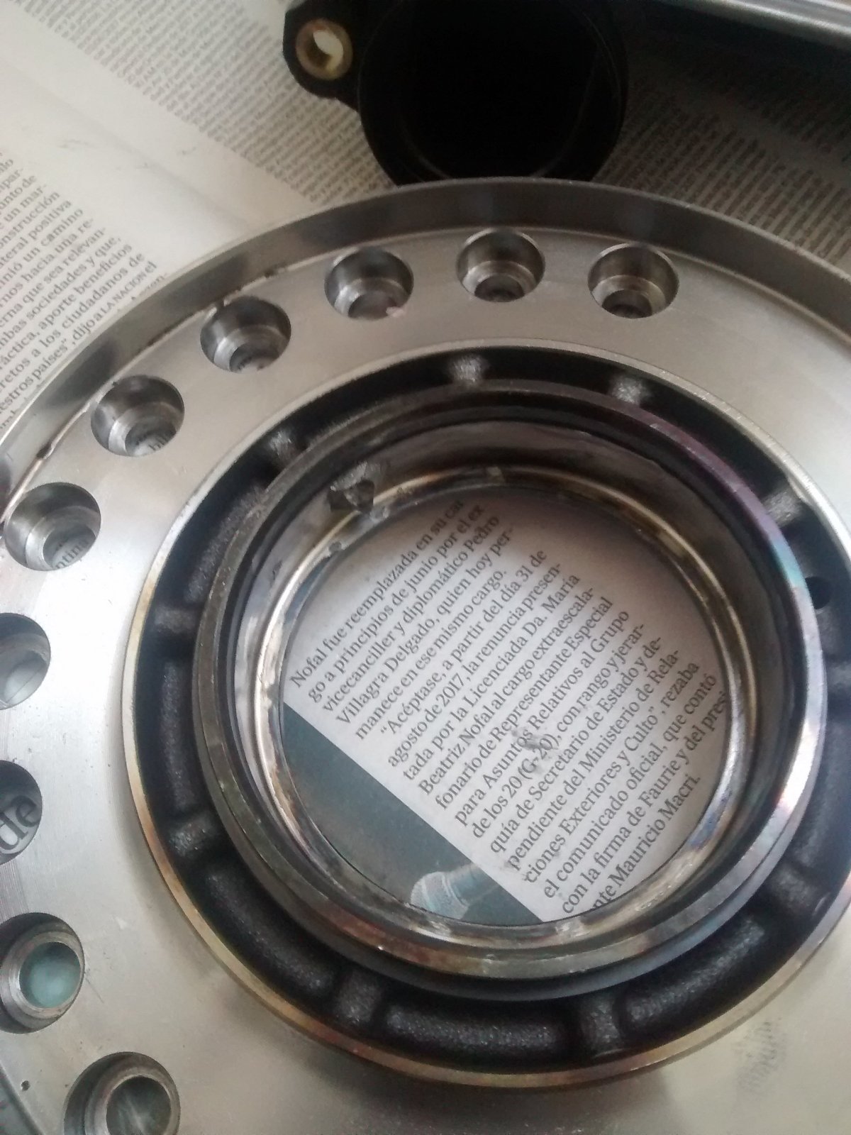

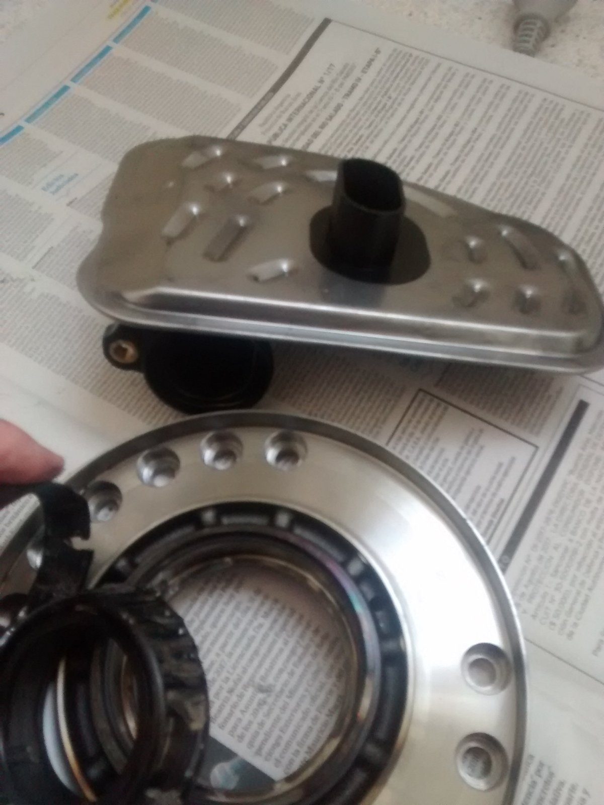

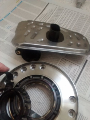

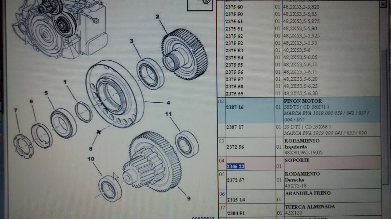

Hi.
Finally the 4hp20 fails completely.
The heat exchanger was completely clogged.
In these images we can see the pieces that broke and dropped particles. (part nro 4, 10, 11)
regards
