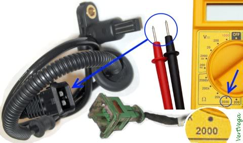

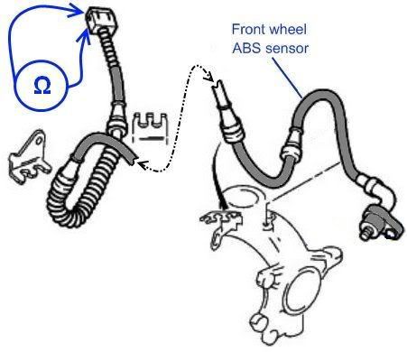

Here are some pics. This one shows a tech drawing of ABS sensor routing, fixing points etc.brmartyn wrote:... I'm a bit lost regarding follow cables to the connectors etc etc ...
If I remember correct, cable length is max 1 m.
Following cable of sensor (I colored with gray) you'll find the connector end of it.
This pic shows a brand new one (rear sensor: different head part but same connector) and the green connector
which should be disconnected for measuring resistance. The other end of the green connector is in the
ABS plug next to battery. Multimeter scale switched to Resistance and scale 2000.
Measuring resistance from the connector is to make sure if the sensor is defective.
Otherwise search other issues to find the source of ABS error.
I hope this helps
