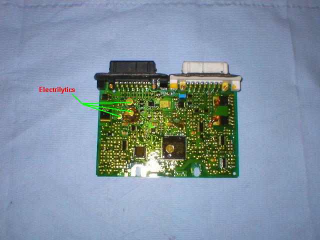

Yes three electrolytics one with radial leads, two SMD.

Happy to provide a service to anyone who wants it. Wouldn't necessarily be able to guarantee that it would be a cure all, but if anyone wants me to do what I did to mine then I'm happy to oblige. It's about an hours work and I normally charge £45/hour, but for fellow Cit enthusiasts I reckon £25 would cover it, including the three capacitors. Anyone interested can PM me.Sid_the_Squid wrote:Excellent Stempy
Fancy setting up an Hydractive ECU repair service as an extension of your existing business? I can imagine a niche market for such services, would be easier than trying to find a working replacement ECU for those of us with suspension problems.

This photo shows the three electrolytic capacitors in the Hydractive ECU.
All the brown stuff around the radially leaded one is not leakage but glue.
The ECU is quite hard to open as it's well stick together with silicone sealant to keep out the damp. The board is varnished to further protect against damp and this must be carefully scraped away before attempting to unsolder these components.
I'll be replacing these in mine to see if it has any effect on the problem described in this thread on fast regulator ticking in soft mode

I've got a few of each value if you don't have them, if you want I'll stick one of each in an envelope. Save you having to buy 10.

Stempy, that'll be wonderful, thank youStempy wrote:I've got a few of each value if you don't have them, if you want I'll stick one of each in an envelope. Save you having to buy 10.
Shall I PM you my address?
That "machinegunning" yours did. Mine has done it several times as well. First time I wondered what the heck it was and my passenger was a bit concerned. I said "no worries, they all do that dear.." whilst wondering what it was that was making the noise

Further to this topic, as the front end of the V6 is now in just about as many pieces as it will go, temptation got the better of me and I pulled out the gearbox ECU and split it open. Not as straight forward as the HA ECU as it is sealed up with bent metal tangs and the PCB is riveted to the back plate and so has to be drilled out.
There are two capacitors in there but they are not of the surface mount variety. I removed and checked them and both were well within tolerance, although I stuck new ones in anyway as it was open. I reassembled it with a combination of pop rivets and M3 setscrews/nuts.

I took my autobox ECU apart because it was so rusty looking and I was worried about the internal condition. In the event it looked like new inside.
I successfully managed to bend back the tabs and pop it open. When I reassembled it I resealed it with electronics grade silicone RTV. I shall use the same stuff when I finally reassemble my HA ECU.
I really get the distinct feeling these ECUs are not really intended to be opened
