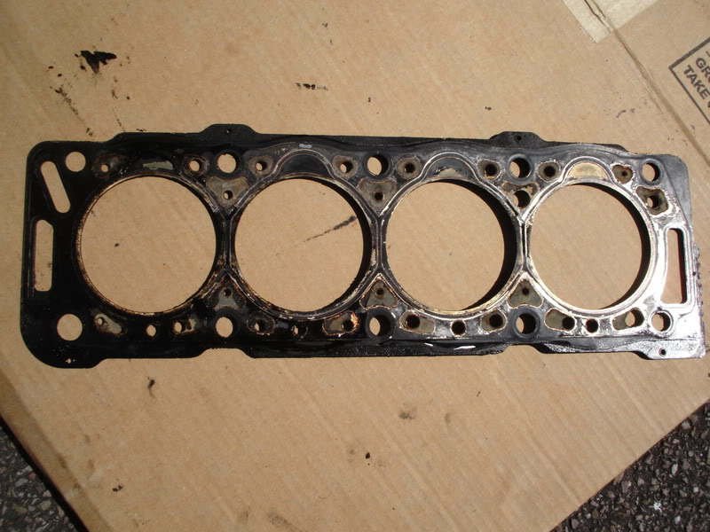

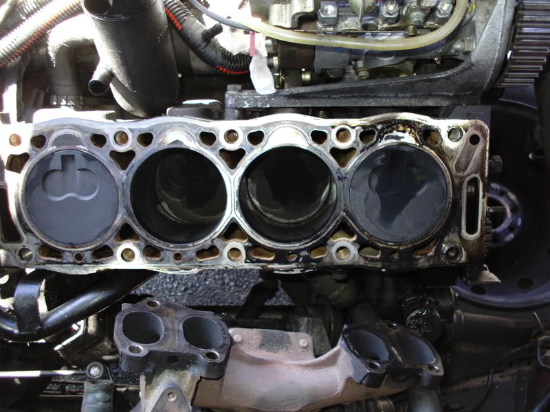

And finally, we get to the heart of the matter. A passing friend offered to help remove the head and no sooner had I propped up the bonnet he had grabbed the head with both hands, shook it a bit and lifted it straight off!
Now, I admit I don't really know what I'm looking for but this gasket looks fine to me.

Good stuff Mike
That, in all honesty, is about how they look when lifted. Nothing immediatlely unusual to be spotted.
You can see why they need a light skin can't you? You'd be there for a month of Sundays trying to get that lot clean whereas a 'thou or so of a skim will do it in a jiffy and true it up at the same time as well as pressure test it..

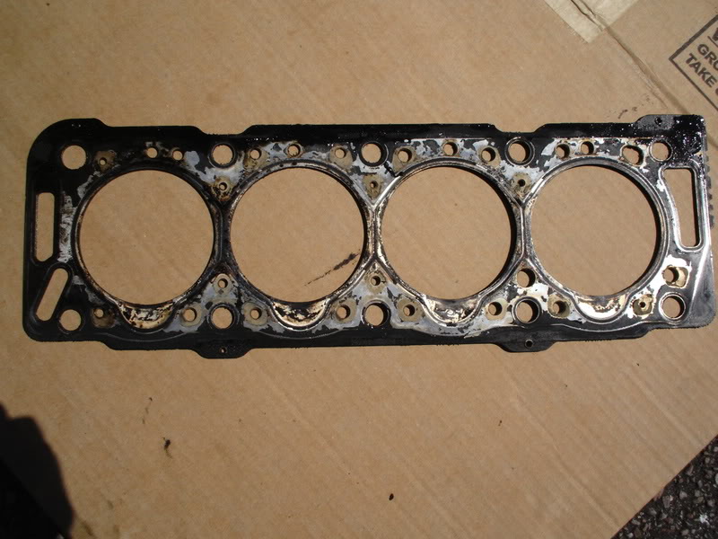

I've wiped clean the gasket and can't see anything unusual, it looks undamaged and uniform except for the thin rubber-like coating that has peeled in various places but like I say, I don't know what I'm looking for in the detail.

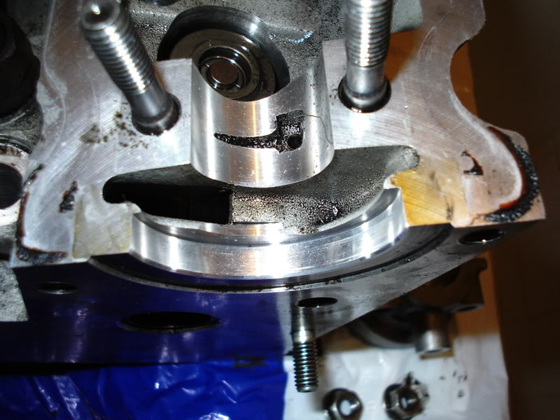

On the cam cover mating surface there is some gum or varnish deposits at each corner both outside and inside the seal circumference - but only at the corners.
The protrusions that hold the inner parts of the seal to the cover have marked the mating surface on the head. Surely they should have been seperated by the seal thickness? Perhaps this was the cause for the oil leak?
The sprocket bolt really was not tight at all and required minimal leverage to undo. I'll have to source a spring compressor before I can remove the valves to check for trueness but I'm confident they weren't stressed.
I've been distracted lately but I did remove the camshaft last night. Interesting to see the wear patterns on the bearings and although not scored or seriously marked, there are some minute pits on each one. You may also notice the heat mark (looks yellow in pic but is more brown) on the mating surface of the vacuum pump bearing? Please note, that's not a crack on the bearing, just a dirty streak.
I was quite surprised to see how much oil was retained within the bearings, caps etc. This engine certainly needed an oil change and probably a flushing agent too.

That brown discolouration and crusty bits either sides are the remnants of the sealant.
Don't forget to use some when you put it back together!

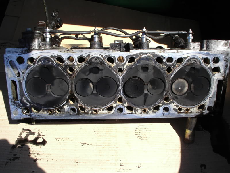

Spring compressor arrived today and all valves are now out. As expected, the inlet valves are host to massive build-up of gooey, oily paste from the exhaust and crankcase mist. Thinking about it, the additional weight cannot be good for the valve and/or the spring. What's worse, is the inlet valves sealing faces all have at least one spec/spot of this "gum" presumably allowing them to leak when shut?
I don't know what it may indicate but the valves had varying degrees of resistance to being removed from the guides. The majority resisted enough to hold the valve in the guide but gave up when pulled lightly. One just dropped out and two were highly resistant to being removed but did come out eventually.
