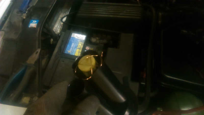

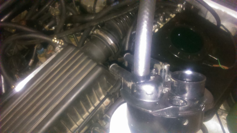

Go here for pic of the tank inlet pipe.
look closely you will notice I have filed down the top edge to only about 1mm or less.
The fasterner on the left should never be used on the inlet hose. The one on the right is the reccommended one.

Bubbles that come back through return lines (leaky low pressure plastic/rubber return lines etc) and bubbles that are introduced by the pouring action of some of the returns depositing their contents at the surface should all be contained by the filter and rise harmlessly to the surface and not make their way into the tank proper, outside of the return filter, and certainly not to the feed filter.
However it's been my experience that the mesh can only cope with so much - if the quantity of return bubbles becomes excessive and those bubbles become large, whatever the reason (and there are multiple possible causes) it starts to overwhelm the filter and some bubbles do start getting through, and yes they do get sucked up by the pump. As there is a constant circulation from the pump via both the pressure regulator return (most of the time) and the power steering its easy to see how bubbles that are already in the system can start to build up into a runaway state where the filter gets overwhelmed and the quantity of bubbles increases until it gets out of hand.
The basis of the 10 minute mod is that the main return is too far down at the bottom of the filter - and although there are two filters in between, the exit of the main high volume return flow is too close to the intake - it's only about an inch or two at most. In my opinion one mistake Citroen made here is there should have been a flat baffle between the two filters that is most of the width of the tank so that the oil has to pass a long way around the baffle rather than just travelling from one filter directly to the other. A kind of silly mistake in hindsight.
Cutting the main return pipe shorter brings the turbulence level higher up in the tank and seems to prevent those turbulence related bubbles from going down through the bottom of the filter, straight into the suction vortex of the pickup filter. Instead they swirl around a bit and come back up to the surface within the filter. The exit of the pipe still needs to be below the surface though, if you cut it too short you just create more "pouring turbulence". The 10 minute mod does not fix the problem at its source (excessive bubbles coming back through return lines and insufficient baffling between return and intake in the tank) but it does work around it to some degree.
Unfortunately I don't think there is any one silver bullet for this bubble problem - the causes of bubbles are numerous and some cars may have some problems (air leak in the pump feed line) some may have others, and some particularly stubborn cars may have multiple problems. So there is always going to be debate about what works and what doesn't (or even that nothing works) because although the end result - bubbles - is the same, the causes can be very different.
Some people have found what works for their car but that doesn't necessarily mean it will translate to other cars. On my current Xantia V6 (which I have not done the 10 minute mod on) I thought I'd try putting a little bit of black silicon sealant around the junction of the pipe and the spigot of the tank on the feed pipe to the pump, and also around the "join" in the pipe 50mm from the tank that the V6 models have. I didn't notice any immediate difference even after some Citrerobics but over a period of a few days the car has got significantly softer and more cushioned feeling and has stayed that way. I wouldn't say that it has completely solved the intermittent harsh ride I've been seeing but it has helped quite a bit.

Have to agree, Mandrake, with all you say - bubbles can arise from multiple sources, and can be slight or overwhelming.
In order to observe the bubble-blocking action of the filters, I have today ordered up a couple of new ones from Citroen, and will test and post when they arrive.
The hydraulics on the XM are working perfectly, and today we've driven about 90km on motorway, urban and winding mountain road. Dipped a small sample (from outside of the filters, obviously) of the LHM tank in a clear tube when we got home. Not a single bubble of any size to be seen.
What is essential, I think we all agree, is that the suction pipe between reservoir and pump is completely leak-free, and the advice on clip types and hose seating is really useful.
