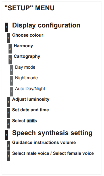

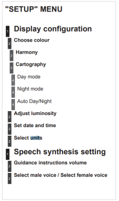

So this is the place in the menu:
Also make sure that the units are set correctly from the vehicle configuration menu - accessed by pressing in the left side rotary steering wheel button when the car is stationary. Go into the vehicle configuration and check the units are correctly set there too.
