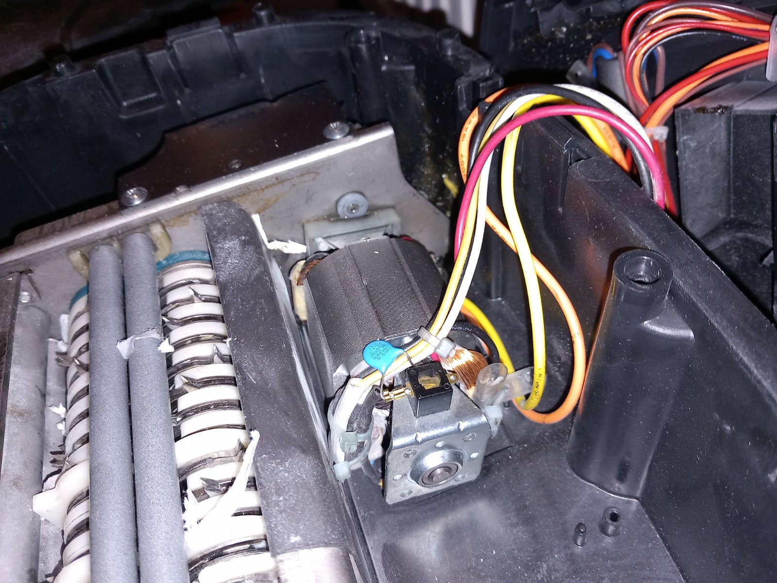

Back on topic... If there ever was a topic ;) :lol: We had a sherdathon today and the shredder with the brass bearings broke - as expected - but the one with the Nylon-66 bearings did a sterling job. The one with the phosphor bronze bearing also stuck it out to the end...
Here's the proof :)
And one of the bearings, showing no wear :)
We did find the motors don't like continuous duty. They get very hot and loose power. They're fine once cooled down...
So now I'll make sets of Nylon-66 bearings for the other two...
The three shredders cost a tenner. I must have spent at least twice that on experimental bearing material :lol:

Now there' a thought :D And maybe pressure lubrication for the bearings... I'll end up turning these into super-shredders 8-)

Yes, it is beyond belief these shredders do't have that as once the cutters start regurgitating the shreddings from a full bin the risk of a solid jam is nearly inevitable unless you realise and do a rapid reverse. Forensically examining the damage to the original bearings I'm almost of the belief they're sacrificial and designed to fail in the case of a jam before the motor and gear-train is damaged...

Never tried the needle roller inside the original bush Jim? Regarding the motor dying, a little contact breaker (like on RC cars in my youth) or if heat is the problem, presumably the wires feeding the motor must get warm also so a suitably rated thermal fuse would work With the motor protected you can for your life on the bearing configuration.

moizeau wrote: 24 Dec 2023, 18:38 Never tried the needle roller inside the original bush Jim?
No, now they've done the bulk of their hard work Pete - well beyond what any shredder would normally see - and no they will only be used for light domestic duty, I'll not go that far, especially as the Nylon-66 seems to work well - my test bearing did have a stern test with several reams of paper!
That is a good plan :) I'll be looking into a thermal cutout along with a 'bin full' interlock...

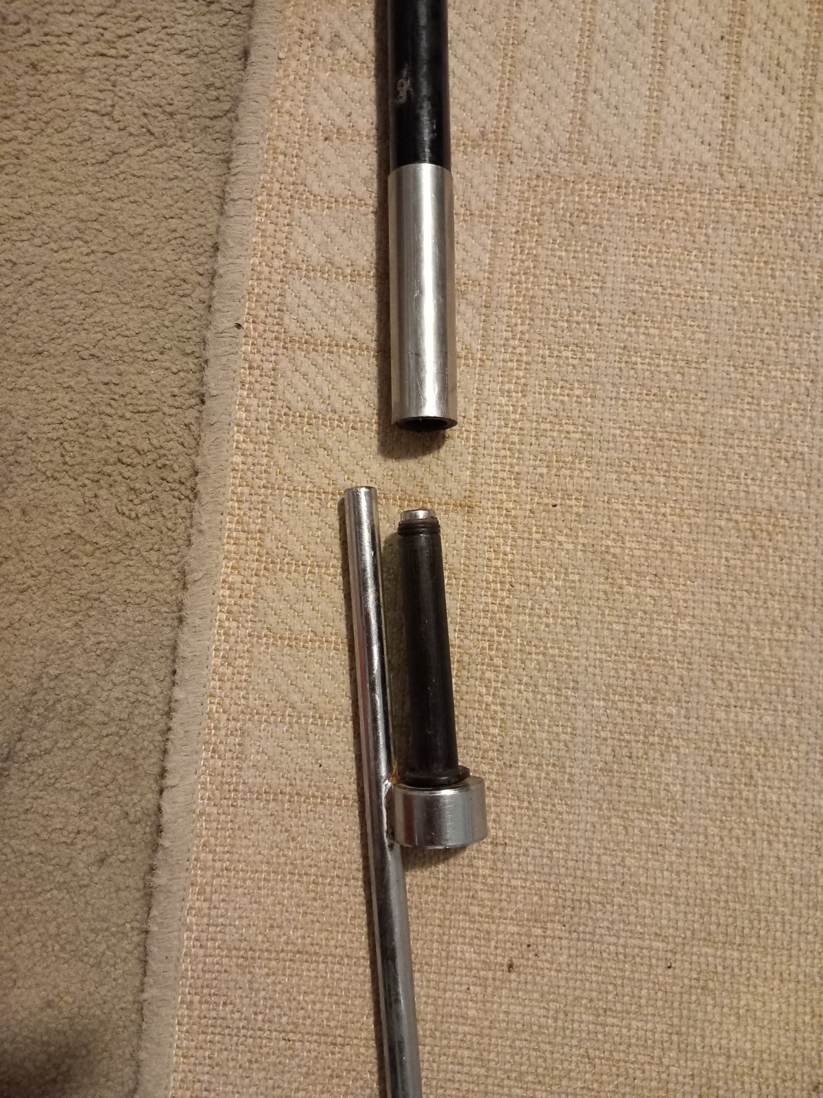

Flagpole problems today... Our parkruns have sets of banner flags on carbon fibre poles that remain upright via a metal spike in the ground...
They all pack down neatly into a thin bag when not in use but not, as happened last week, when the bottom pole gets stuck fast to the spike...
The flags are intended to rotate about the spike and to achieve this there's a nylon sleeve between the spike and pole...
Lots of mud had got in there and a seriously big tug was needed to separate the two. A good cleanup, new O rings, a bit of dressing of the scratched nylon sleeve and a good lube with Vaseline sees it all good again :D
