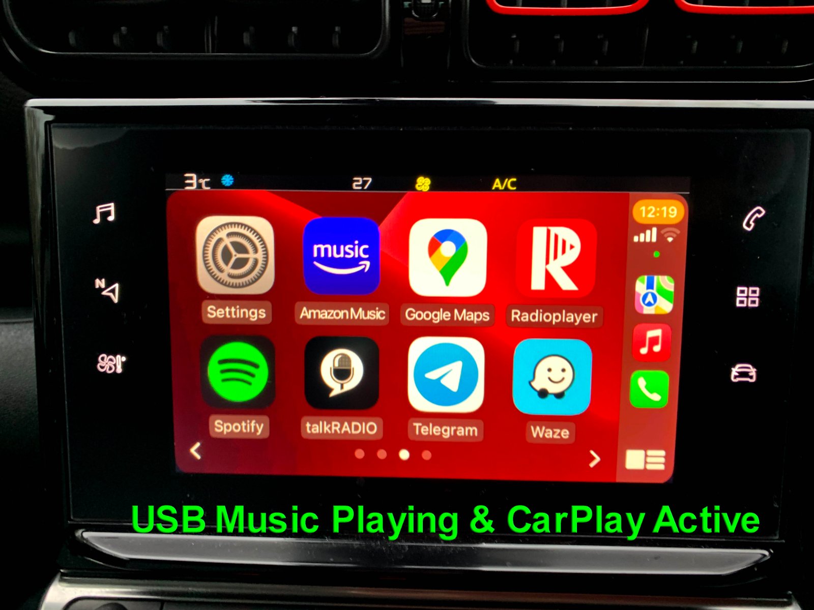

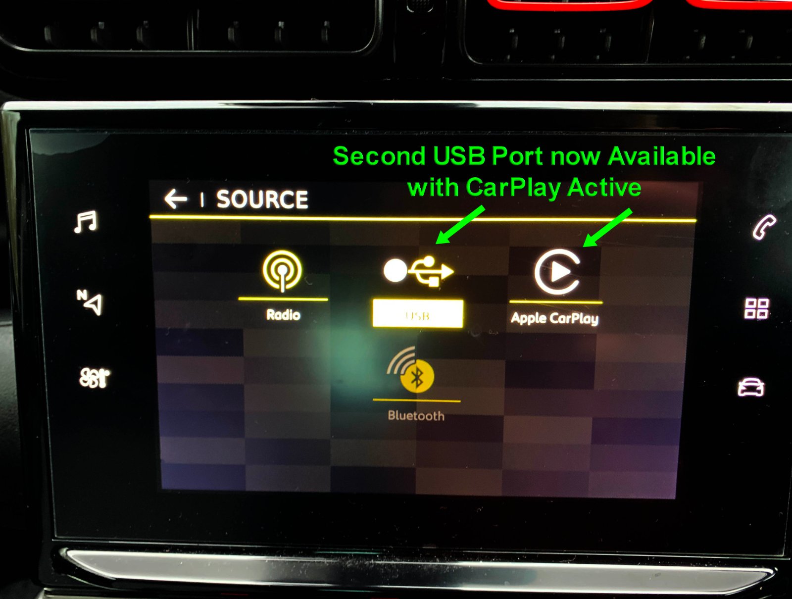

So today I decided to sort out the second USB port upgrade for my Connected NAV system.
The system only has one USB port provided officially, although the unit does have a redundant USB port available at the back of the Head Unit.

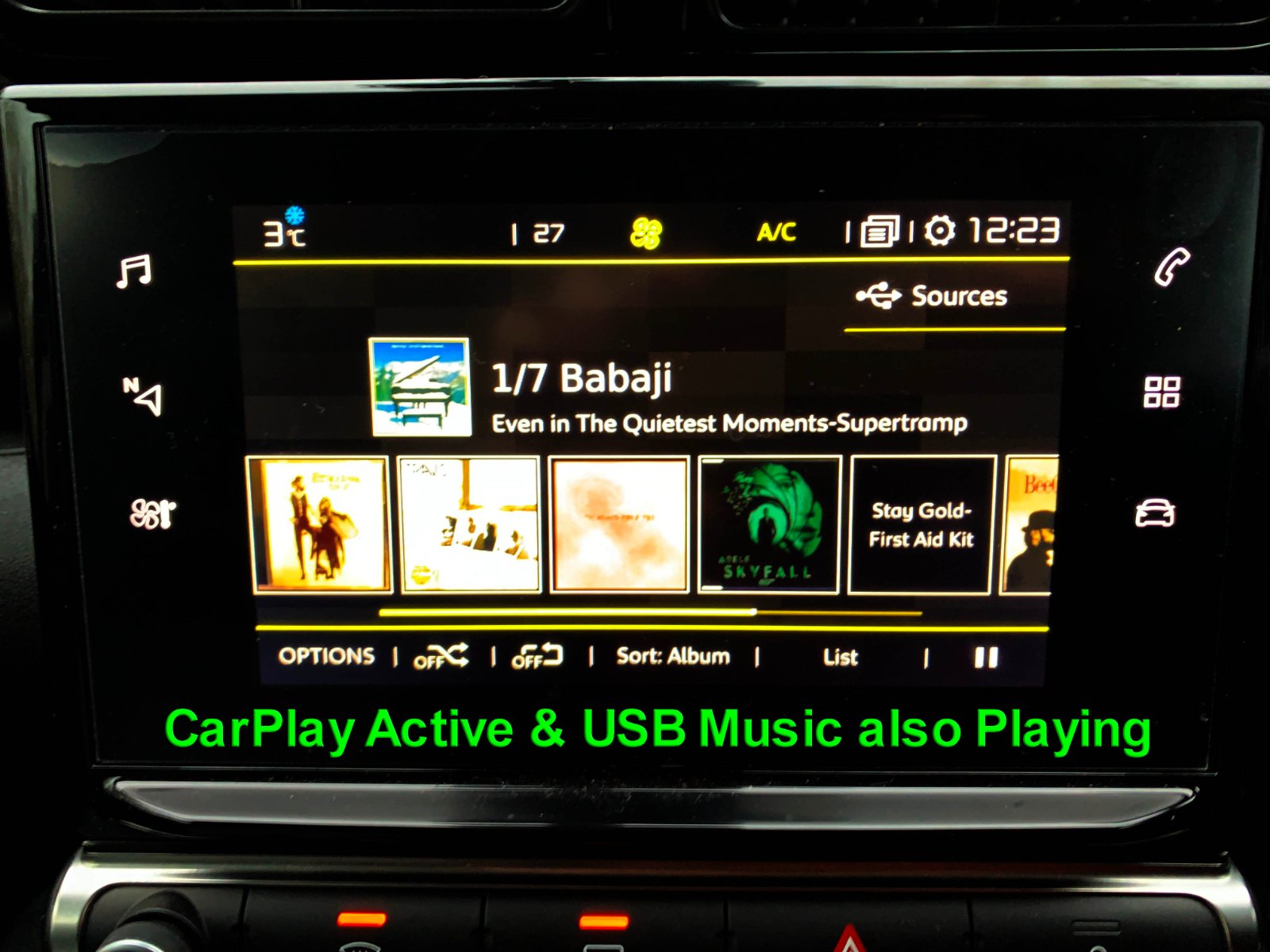

The default setup means that you can only have either Apple CarPlay connected to the existing USB port, or a USB drive but not both. This is because once connected, Apple CarPlay swaps roles and becomes the USB Host and the vehicle becomes the 'Device' instead of the other way round. So CarPlay does not allow a second USB device to be used as a source.
Pros / Cons I have with the current setup:

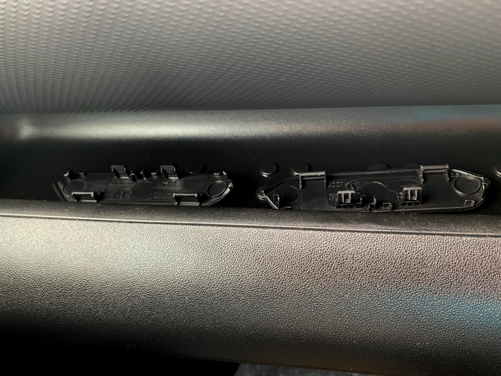

The other issue I had is trying to locate a suitable place for the other end of the USB in the Aircross. There are limited options - especially if you don't particularly want to go drilling holes in your dash. In the end, I decided the only place I could utilise where the cable would be out of side is in the glovebox.

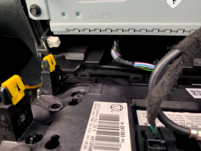

It turns out that there is a hollow area where the glovebox lid catch clips into the glovebox that goes all the way through to the head unit area in the dash. Not ideal, but it works, so you can have the USB connection stored in the glovebox and just plug in your drive / memory key there.

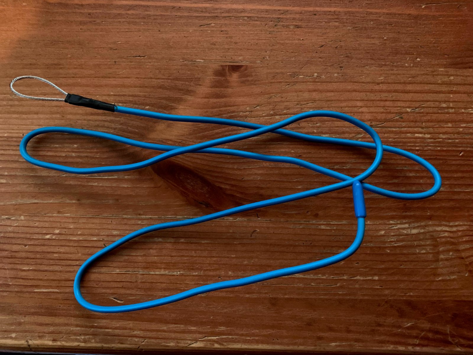

This is where the cable routing tool above is invaluable - cost £6.00 from the bay.

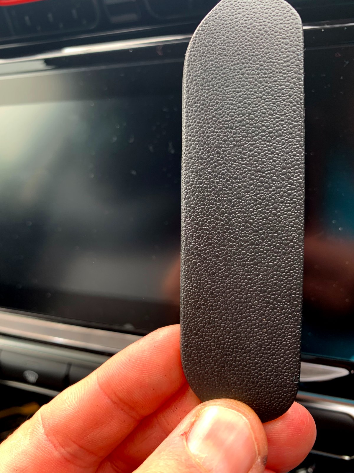

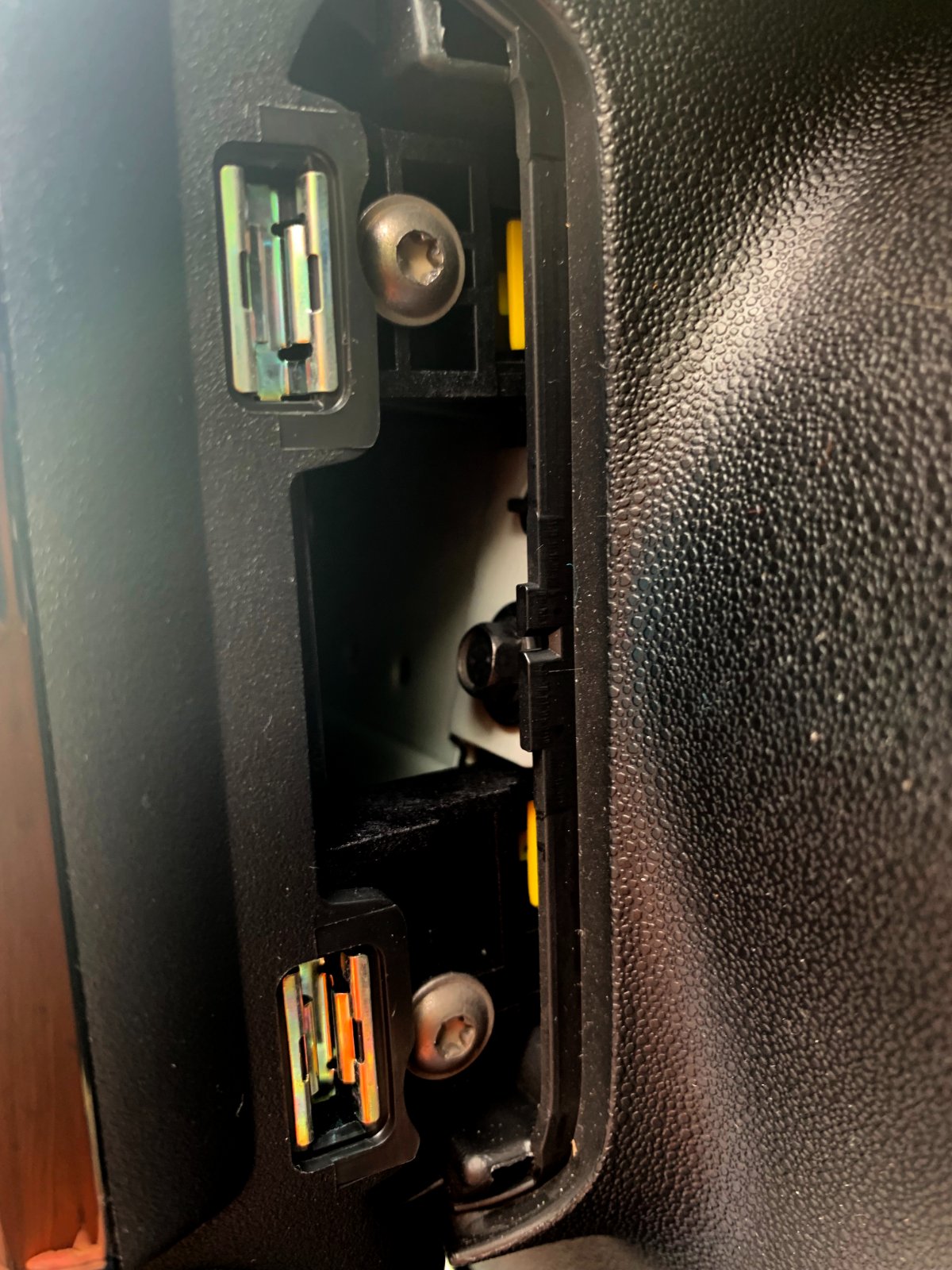

Then you can see that there are 4 torx screws that need removing, 2 each side. You may have to use a combo of hands and smaller tools to get the ones out on the driver's side as the steering wheel is in the way. I let the horn off several times - but I think my swearing was even louder.

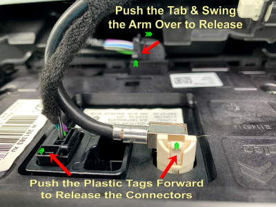

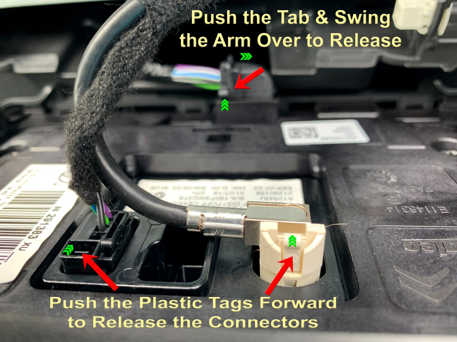

Once out, gently Pivot the Multi-Function Screen towards you from the top and it should release from the four side clips shown in yellow below: Be careful as there are connections immediately behind the screen.
Start removing the MFD connections - instructions are in the photos: Once the screen connections are removed, be careful to place the screen somewhere where the screen won't get scratched. Once out, you can see the 2 securing bolts of the NAC Head Unit.

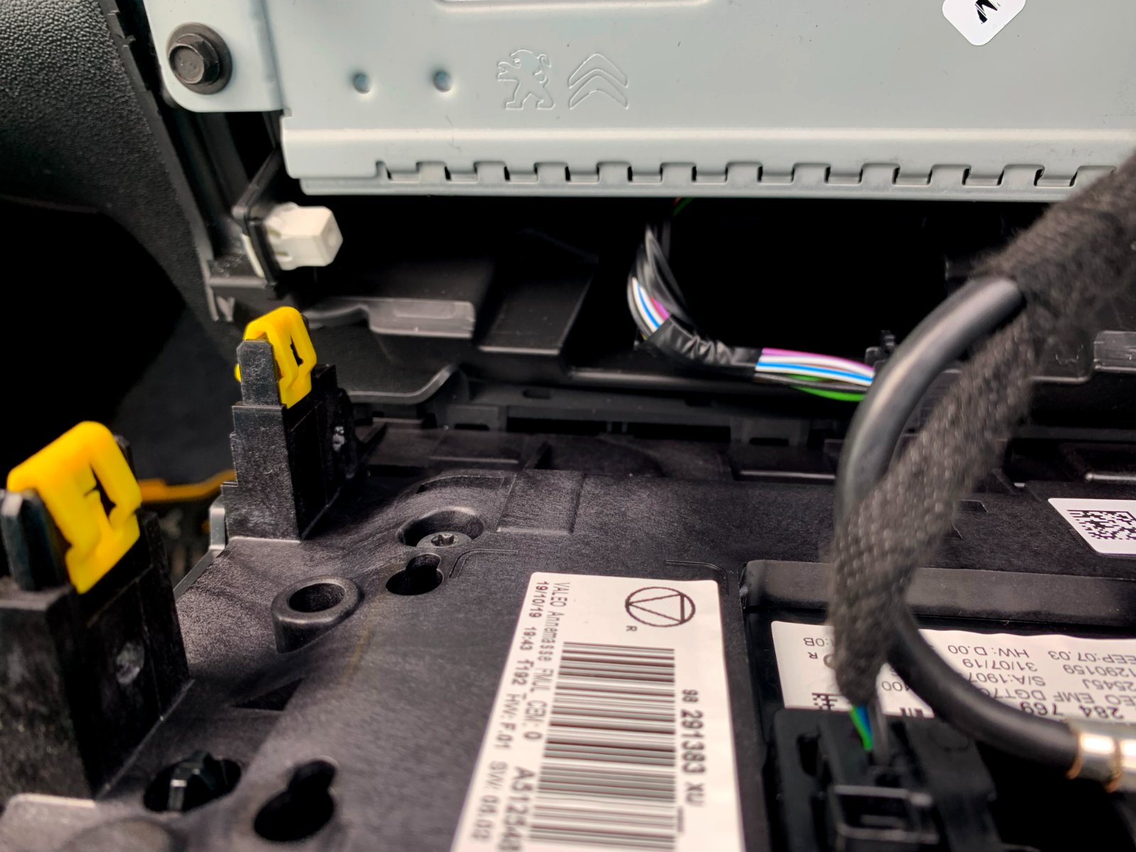

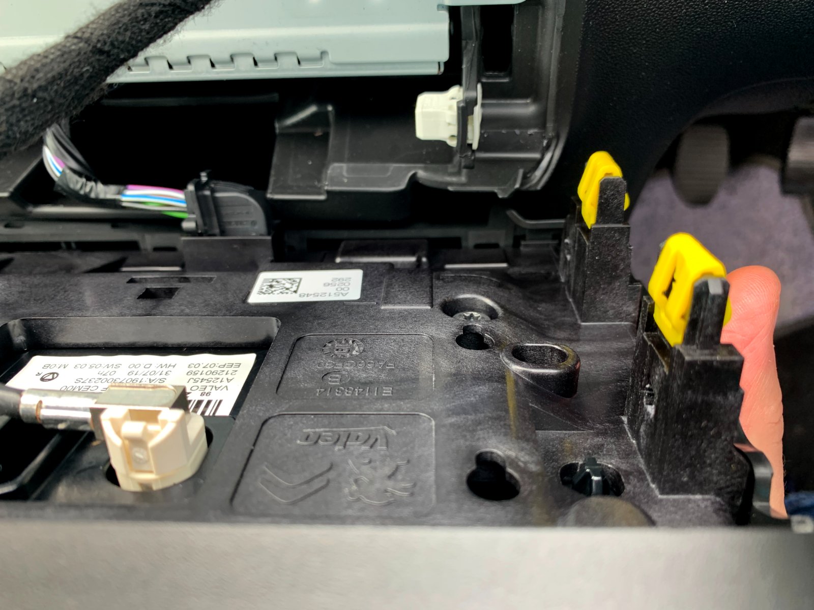

Once the 2 bolts are removed, carefully pull the Head Unit forwards to show the connections. Be very careful not to damage or pull on the harness.
When disconnecting the Head Unit connectors, always remove the large Quadlock connector first (and replace it last).

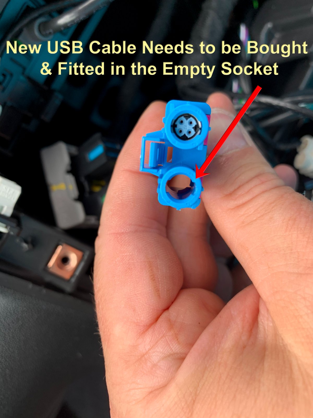

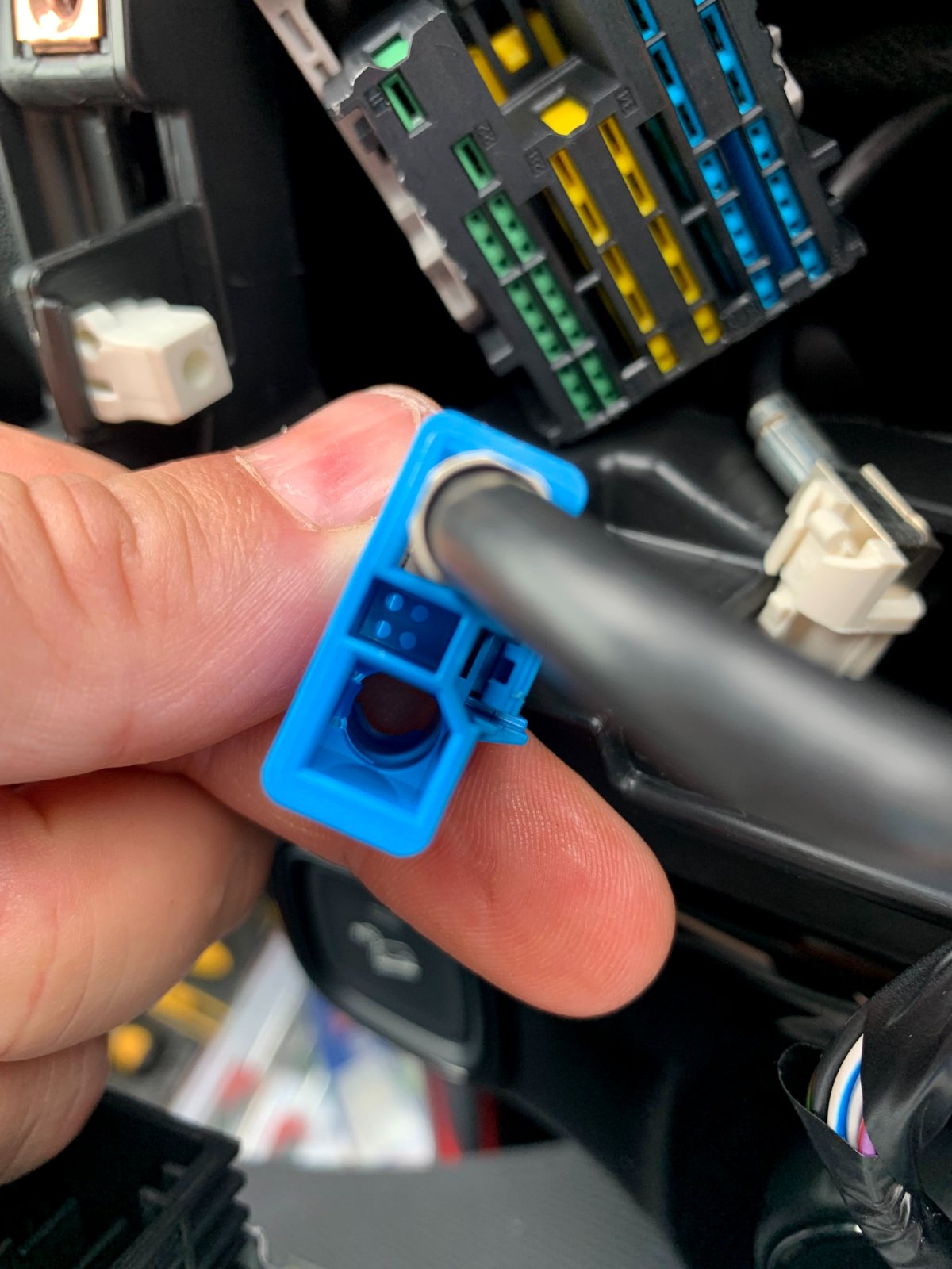

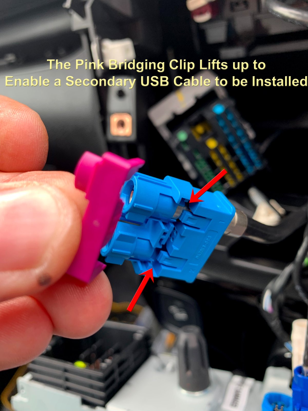

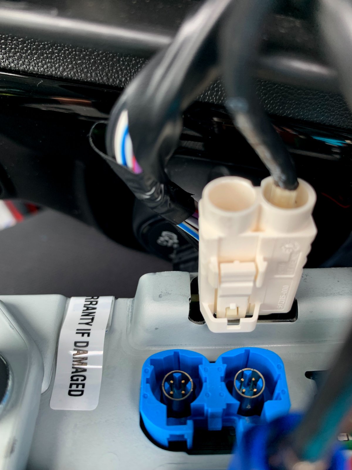

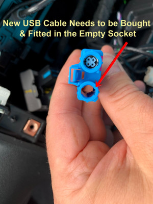

On this unit, as seen above they used a twin USB block with only one USB cable inserted. Some units may have just a single USB socket in which case you can plug the new Fakra connector in and be done with it. However, as this is a twin connection, I had to remove the new cable from its Fakra connector to be able to insert it into the existing twin connector socket on my Head Unit.
On my new USB cable, the crimp was rounded like a half moon shape on the side that had the plastic purple bridge lock. So it's important to keep this in mind before you remove the cable from the Fakra, as it must go back into the twin connector in the same orientation to ensure the pin signals match up. I suggest you line up the new USB plug at the back of the Head Unit the correct way, then mark the cable so you know which is topmost if you don't have the crimp shape to help you.
Once you have moved the purple bridge up with a small flat screwdriver, you can use the same to lift up the little blue tab that holds the USB cable in place and extract it. Then place it the correct way up into the twin USB connector. it should click into place, then re-insert the purple bridge of the twin socket and you are good to go.
Start reconnecting all the connectors (making sure you plug the large quadlock connector in last). Make sure there are no wires blocking the way and ease the head unit back down, secure the screws, then reattach the touchscreen cables, re-locate bottom first, then pivot up into palce.
Secure the 4 side screws and replace the trim clips.
Job done!
CarPlay
- Personally, I don't like or use Apple Music, and I hate that I have to create a playlist to use with CarPlay - otherwise after each track, playback stops and you have to fiddle about to get another track - totally frustrating. Whether this has been a bug and will be fixed I can't say, but it's unusable for me and I don't have time to keep creating playlists.
- In order to use Siri you have to have an internet connection to the phone - so if you are in a poor signal area like me, that's pretty useless for control.
- Considering point (2), that means extremely limited voice control and the Aircross voice command system won't extend to playing specific music on the iPhone - that's why Siri is needed.
- I can use CarPlay for alternative navigation like Waze / Google if required although I don't need it with the excellent built in system on the NAC.
- I can listen to my Podcasts and use other CarPlay apps without having to use it for Music, which in my opinion it does badly.
- I do prefer to use a USB key to store my music files on. I can quickly plug this into my PC and swap or add music very quickly without having to faff about with iTunes
- I don't need a playlist - but the option is there should I want it.
- Aircross voice commands work seamlessly with the USB drive - I can tell it to play an album or an artist or a song without issue and it's very fast.

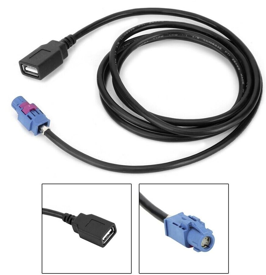

| USB Host Control Cable https://www.ebay.co.uk/itm/114280314815 | Cable Router https://www.ebay.co.uk/itm/184042883906 |
| Remove Clips using a trim tool | These are the insides of the clips. |
| Right Side of MFD | Left Side of MFD |

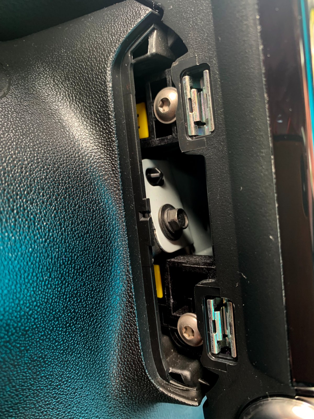

| Rear left side of MFD | Rear Right Side of MFD |

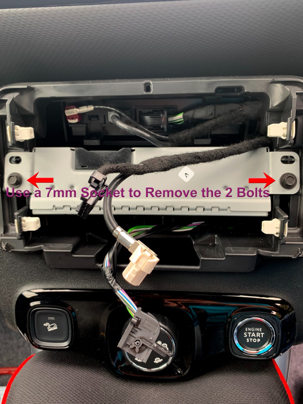

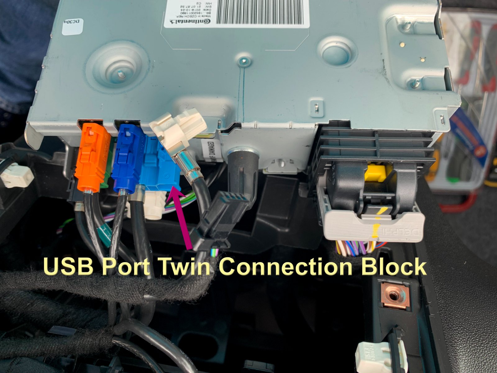

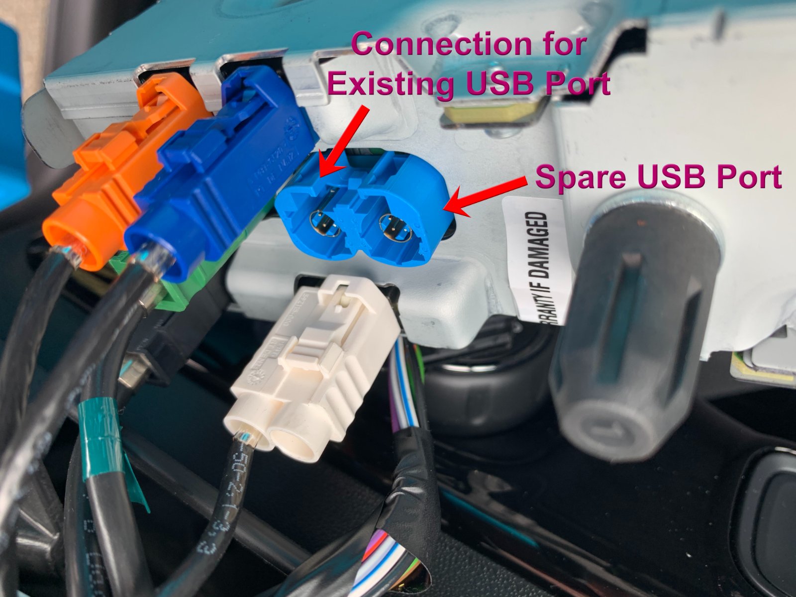

| On this Head Unit you can see the USB already has a twin Port. | The existing USB is populated on the left. |

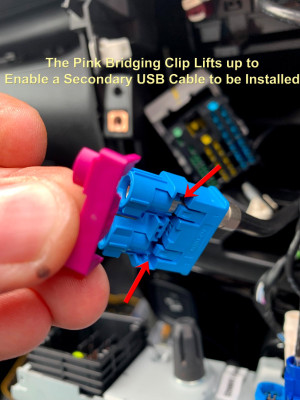

| The Blue Clip can be Pushed in to release. | The Purple Bridge can be raised to allow the new USB cable to be inserted. |
| Bridge Removed showing slot. | Once the existing Connector of the new USB is removed, slot it in here. |
Use your routing tool to hook the USB female end into the loop and thread this through in a straight line through to the glove box area. Use your finger to feel for the cable routing wire, then a pair of long nose pliers to pull it through the aperture where the govebox lid catch goes when closed. Pull through the excess wire.
Job done!
