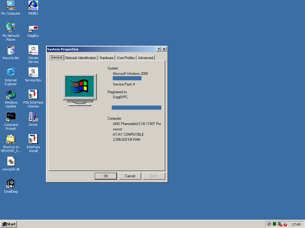

Did some experimentation over the past few days. V5 will install / run on 2K without issue. 7 will install (with a small tweak) but not run. Not yet tested 6.
To make 7 (and possibly 6) install* on 2K:
Grab winrar or similar and open the .iso, inside that open archives\PP2000.z and inside that grab msvcp60.dll from \AWRoot\dtwr\updt\MAJDIST\AWRoot\bin\mmi\ there is another one in \Lexia but its an older dll version.
For what its worth it will install without complaining on the server version of 2K (adv server only it seems normal server falls over) without the dll fuss.
Copy this file to \winnt\system32 if its already present (unlikely) do not overwrite. Then do the installation as normal, not forgetting when finished (all of them) to do the MAJ_COM=FALSE (in \awroot\bin\launcher\ap.ini) to avoid any risk of the interface being zapped.
*install not run, I'm looking into that. Can also confirm 7 seems to be OK on Win7 too although again not really tried to any extent beyond install / upgrade.

V5 and V6 both appear OK on 2K with the aforementioned tweaks, pain to do though as they don't error till near the end. Its not really worth running them on 2K apart from lower hardware (sub 1ghz CPU I think) though:
