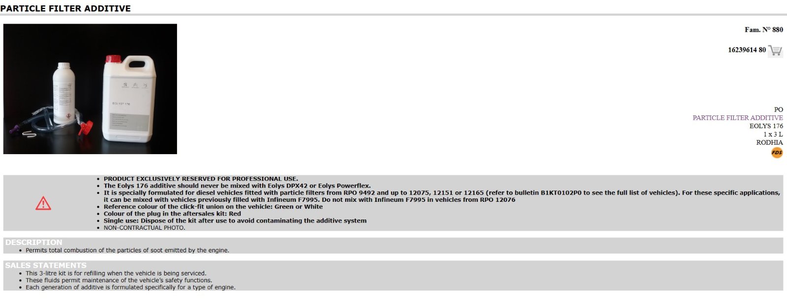

RichardW wrote: 22 Jan 2023, 22:35 Service.citroen says:
This development bulletin describes the changes to the factory-fitted particle filter additives and their impact on after-sales maintenance operations.
1. The new 3rd generation particle filter additives
Suppliers and brands :
RHODIA : EOLYS POWERFLEX
INFINEUM : F7995
2. Previous type of additive
Additive DPX 42 is still available and must be used for all servicing on vehicles that have DPX 42.
The EOLYS 176 additive is replaced by the INFINEUM F7995 additive When current stocks are exhausted, only the new product will be supplied.
3. Compatibility between additives
Additive DPX42 cannot be mixed with any other additive.
Additives EOLYS POWERFLEX and INFINEUM F7995 cannot be mixed with each other.
N.B. : The different generations of additive do not affect the calibrations of the engine management ECU.
CAUTION : It is not permissible to mix additives INFINEUM F7995 and Rhodia EOLYS POWERFLEX with each other.
And
4.2. Rules for choice of additive for after-sales operations
N.B. : These rules only concern the filling of rigid reservoirs with particle filter additive.
Conversion chart for filling or topping-up operations
Additive present in the vehicle Colour of clickfit on filler interface Additive to be used in all operations
DPX 42 Click-fit neither blue nor green DPX 42
EOLYS 176 Green clickfit INFINEUM F7995
INFINEUM F7995 Green clickfit INFINEUM F7995
EOLYS POWERFLEX Blue clickfit EOLYS POWERFLEX
If your kit won't do the reset Graeme, I've got kit here that will!
Wondering now: must I source this Infineum F7995 even where a supplier stocks what they name EOLYS 176?

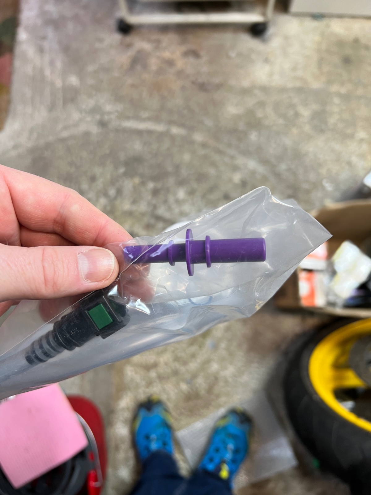

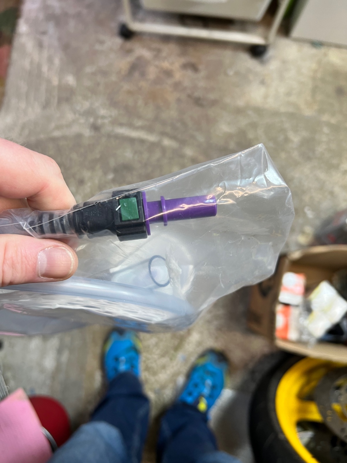

As far as the fillers go I believe they are all the same from memory.
This one is from a Powerflex kit.

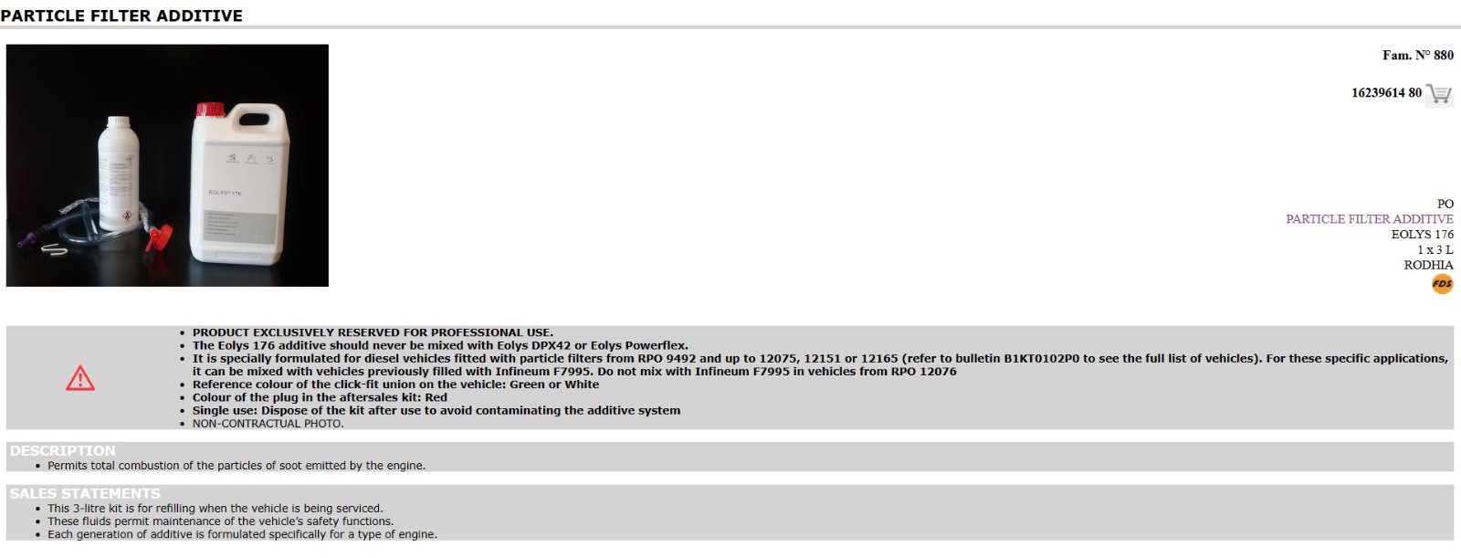

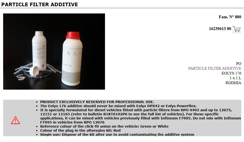

Are we sure you cant get 176 anymore?? Servicebox still lists both the 1L & 3L kits.

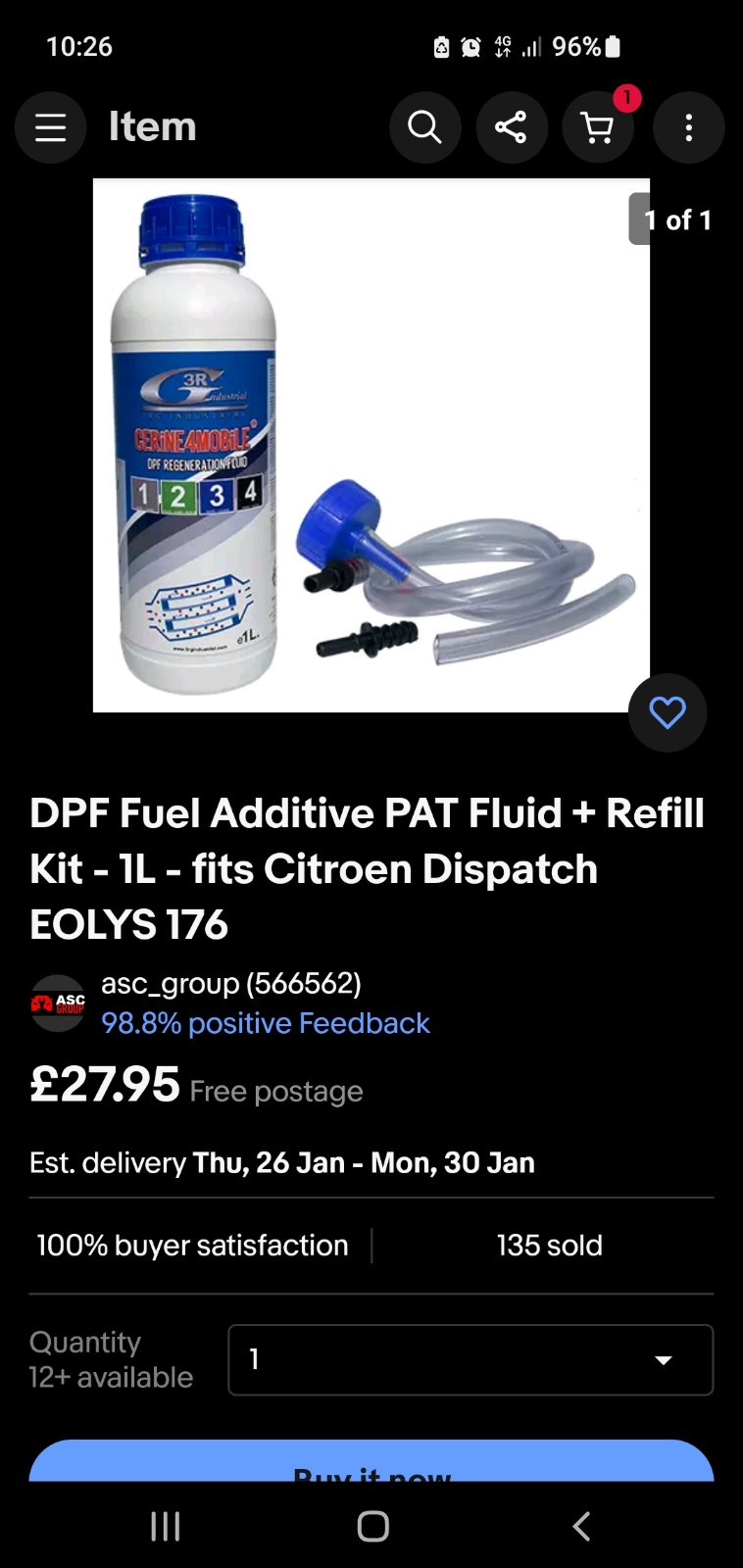

I might just get the ebay eolys and hope for the best

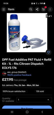

This is what I was going to go for
Is 1 litre enough?

wheeler wrote: 23 Jan 2023, 10:37 Its very confusing, extend is for C5 after 2010 sometime. That buliten says 176 is being phased out but service box is still listing it.
Infineum disappeared a good few years ago (at least 3 years) & as far as i can tell was replaced by Extend.
That's why I said that 'Extend' is specifically stated not for the X7 for the OPs build date. Extend is not a straightforward replacement and only applies to certain engines / build dates. :wink:
Eolys Extend is only for C5 X7 vehicles from build date 12076. Prior to this is it Eolys 176 from build date 9492 up to build date 12075 (or a compatible aftermarket equivalent), but 176 as said is still available online from various sellers.
wheeler
Posts: 7927
Joined: 21 Sep 2002, 19:07
x 1056
Re: Eolys?
Unread post by wheeler »
Theres no doubt about what fluid the car need’s going by build date, we know its 176 but that old document (which I would think is at least 3 years old) says that 176 is being phased out in favour of infineum (which we know has been obsolete for several years). So do the dealers still have 176? It is still listed on servicebox.
x 6956
Re: Eolys?
It's still showing up as a valid part number and in the basket.
The document I refer to is 2 years old but is still the latest on Service Box as listed under the C5 X7 and many other vehicles, so had not been updated.
The info is the same in the July 2022 document of the same name for the 508.

I topped up this stuff today but now I wonder how much is meant to be in the tank. I purchased one bottle that's 1l. Filling it took the whole lot and none emerged from the 'overflow' pipe . Perhaps I should have got 2 or more litres and filled until the overflow began dripping. I reset the counter anyway.
