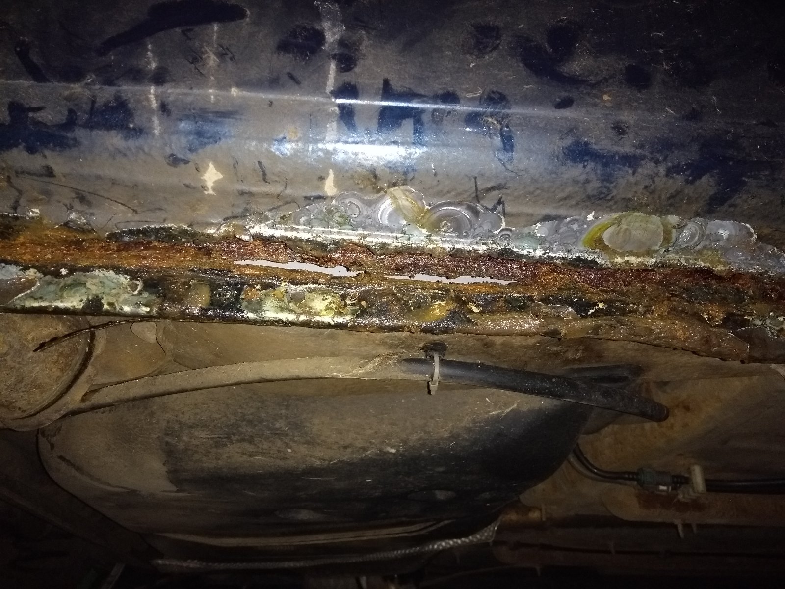

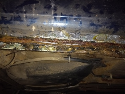

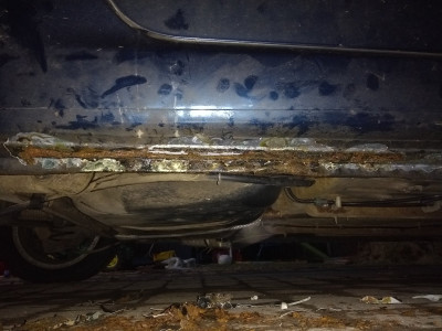

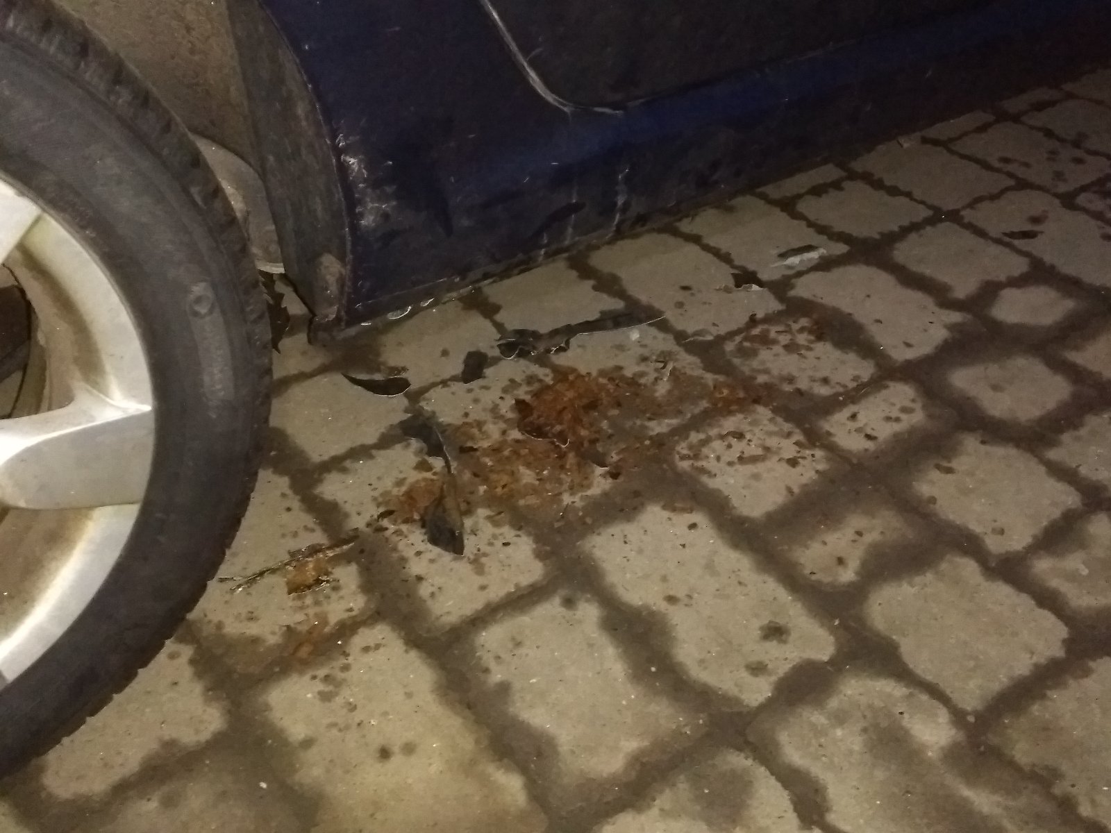

The inner inch or so of the sill has dissolved, almost all the way from the rear wheel arch to the B pillar, and the inner sill is gone too just above the jacking point. It would be a big job to repair it properly, and given that it needs a pile of other work, I will be changing its appointment with the MOT man to one with the scrap man

The jacking didn't kill it - it just gave the game away - had I not jacked it this week, the MOT man would have had a field day poking his CAT through it in a couple of weeks. Much the same failure as the Xsara Picassos suffer - it has rotted from the inside out; the underseal on the sill was still pristine; just very soft....

But if the MOT man couldn't see any outward appearance of rust, why would he have been poking at it forcefully with his screwdriver ?
For all you know that rust was there at the last MOT as well, but it just hadn't been discovered yet. That kind of rot doesn't come out of nowhere overnight.
I'm just saying if it had have been discovered after the MOT instead of just before it it would have at least given you a bit more time to find a replacement.
