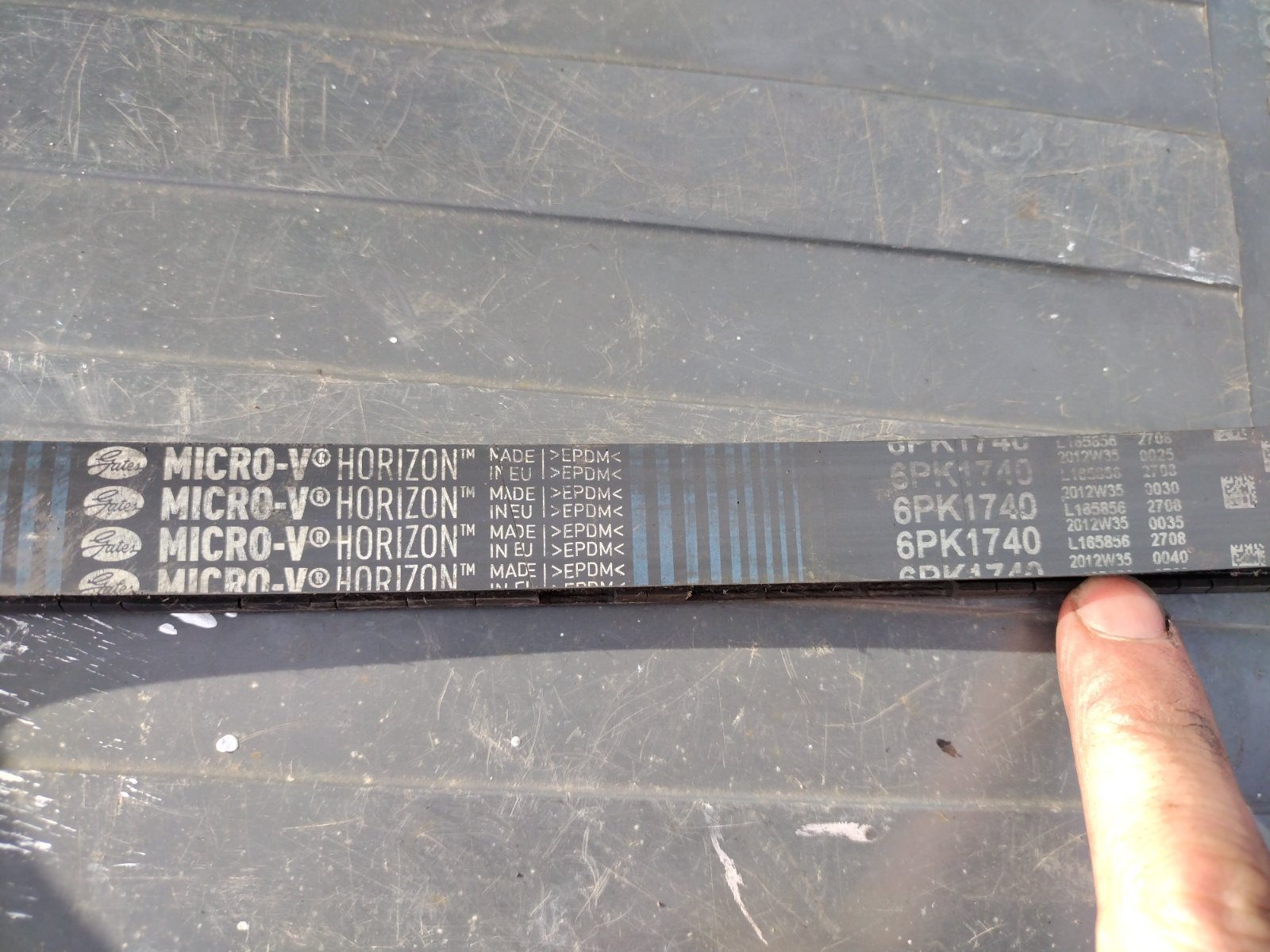

"2012W35" = perhaps 2012, week 35. So barely 11 years use our of that! :-D
Posts: 21206
x 8124
It might prove interesting to run that through a tape reader and see if it comes up with 42? :-D

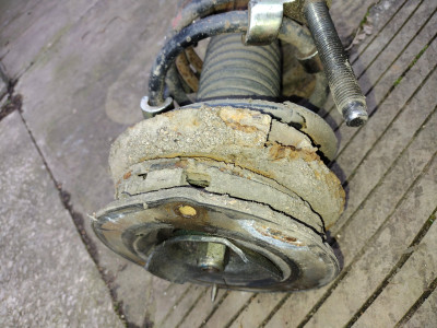

2000 Coupe, front passenger side (left) strut, again not bad. Quick wire brush and slap some black on for now.

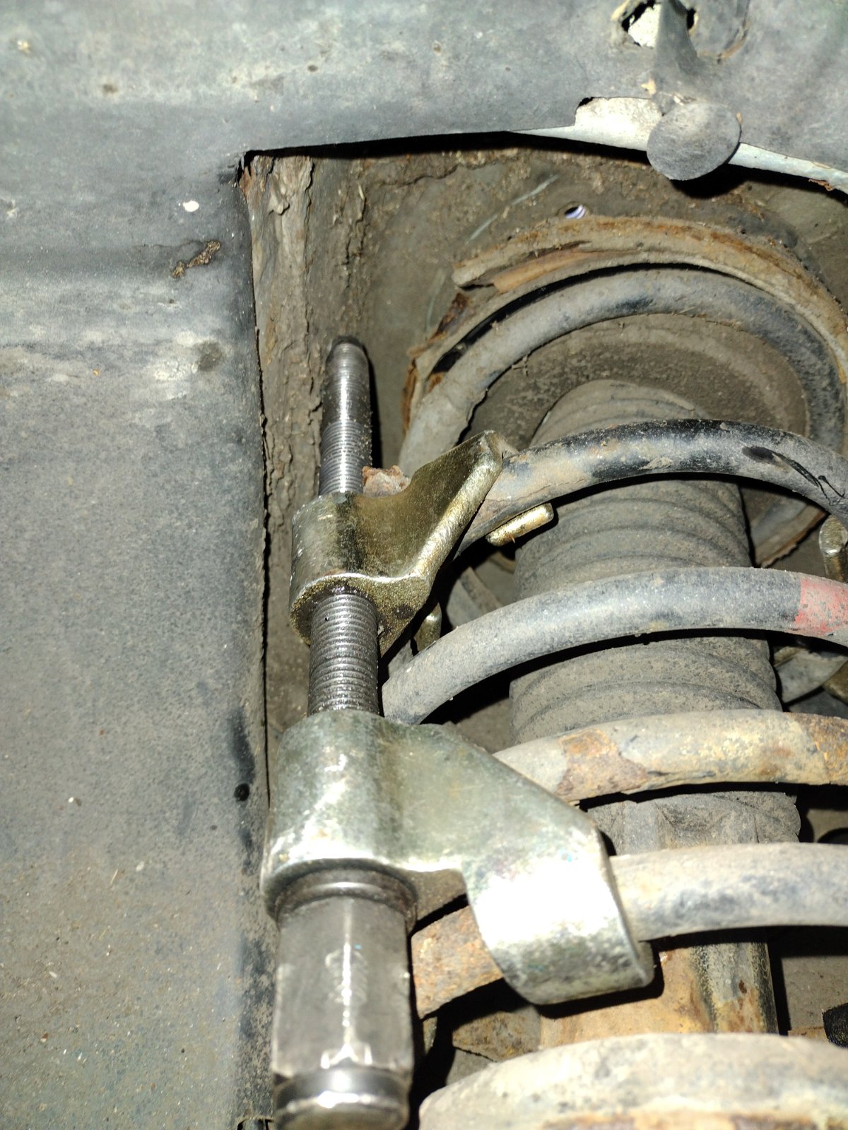

Back to the 2002 Hdi Coupe. This is what MOT man would see, at best:
Looks ok (yes spring rusty)

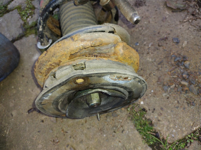

Unread post by MattBLancs »

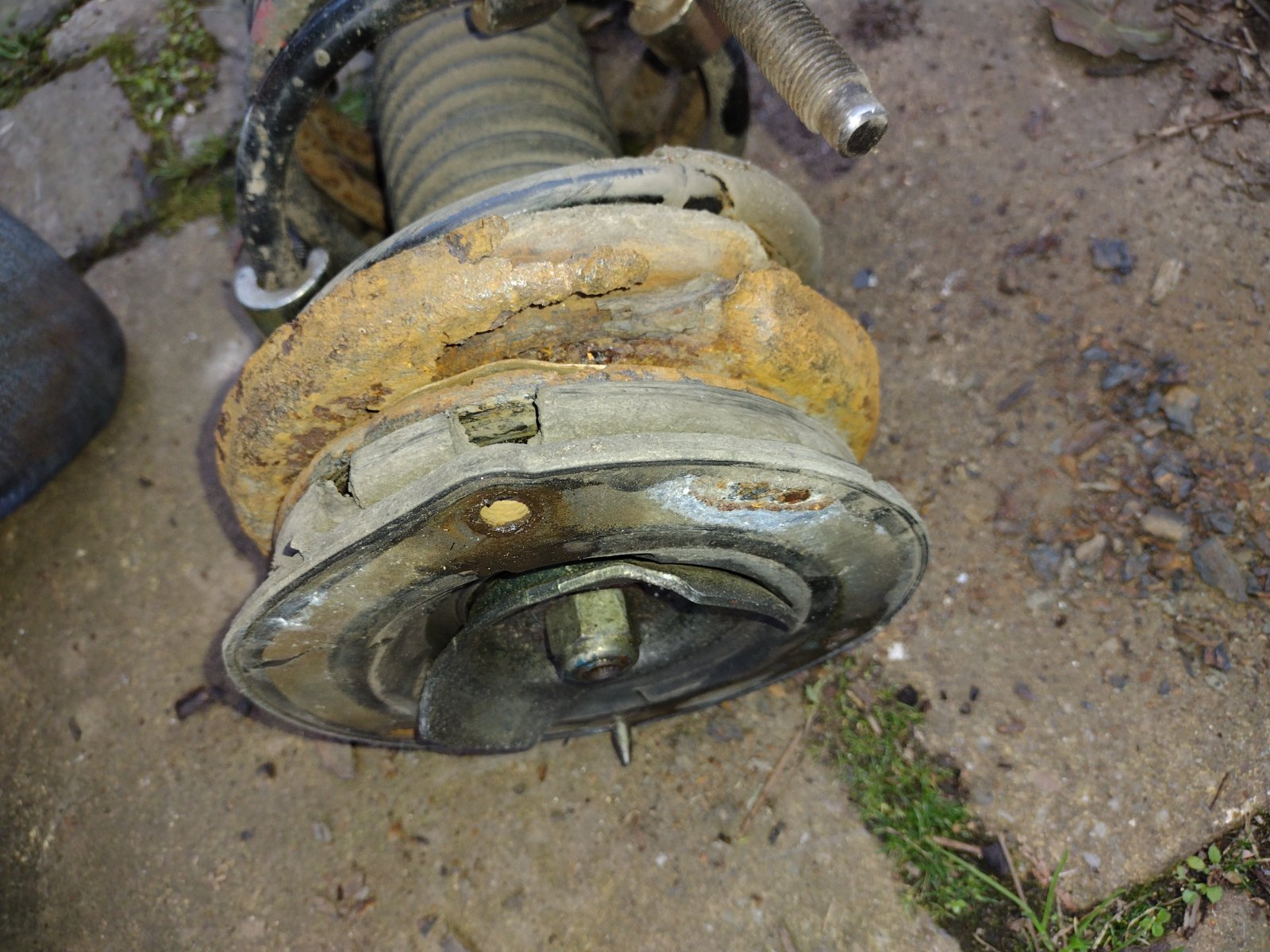

Top of same (2002) strut when removed:

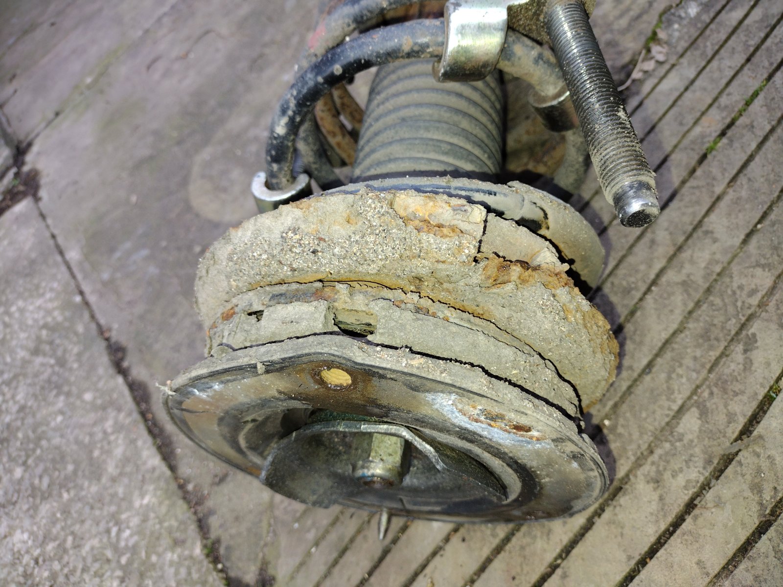

2002 strut:
And now, with 30 seconds of wire brush by hand.
Frightening!

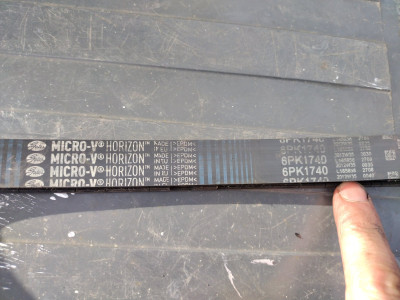

Posts: 55111
x 8406
Gosh! That auxiliary belt had seen better days. Amazed it could still transmit power!

CitroJim wrote: 29 Oct 2023, 17:28 Gosh! That auxiliary belt had seen better days. Amazed it could still transmit power!
Yes me too! No squealing or other clues as to its condition, beyond the shiny glazed surface of the back of the belt. Must be good printing process Gates used as last "definitely old" belt I changed had worn as to be anonymous.

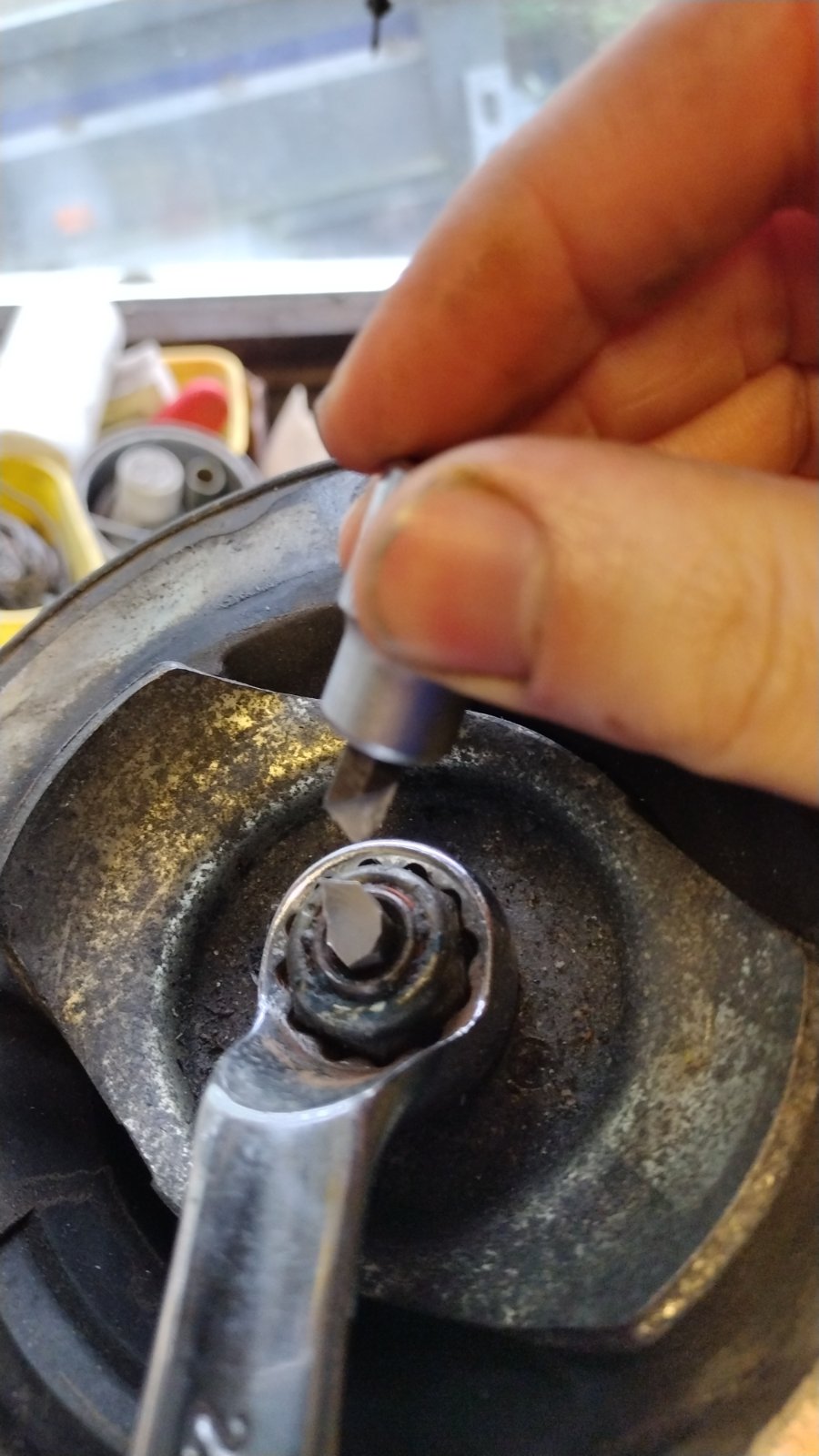

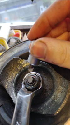

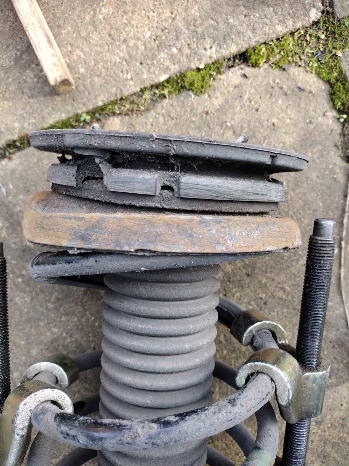

I'll just take the old strut apart whilst I have it setup in the spring compressors, or maybe
Spoiler: show
not just yet.
7mm Allen bites the dust
:x
