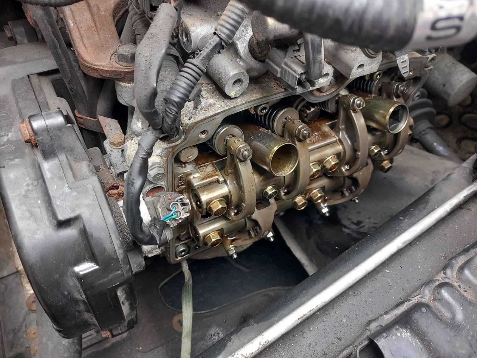

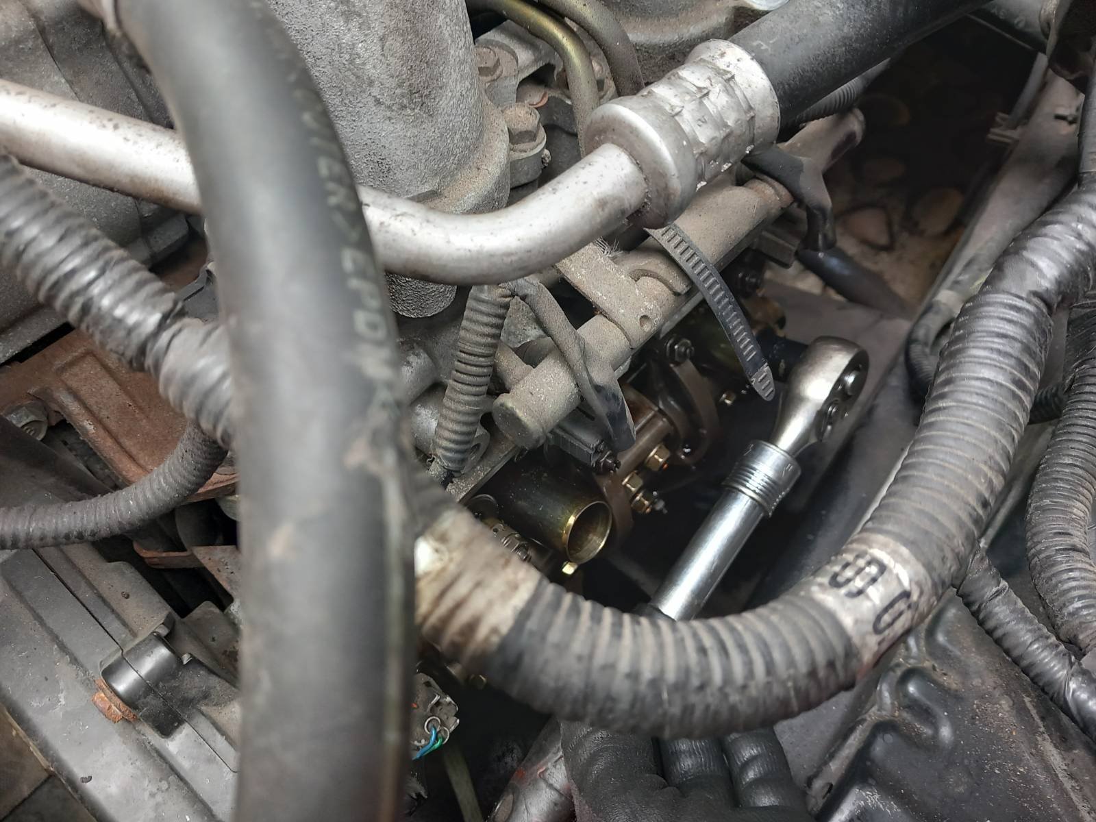

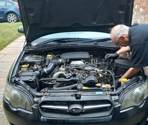

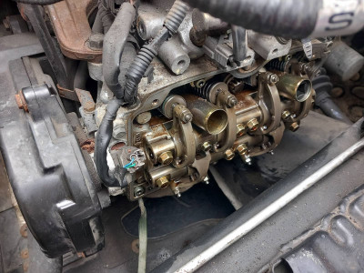

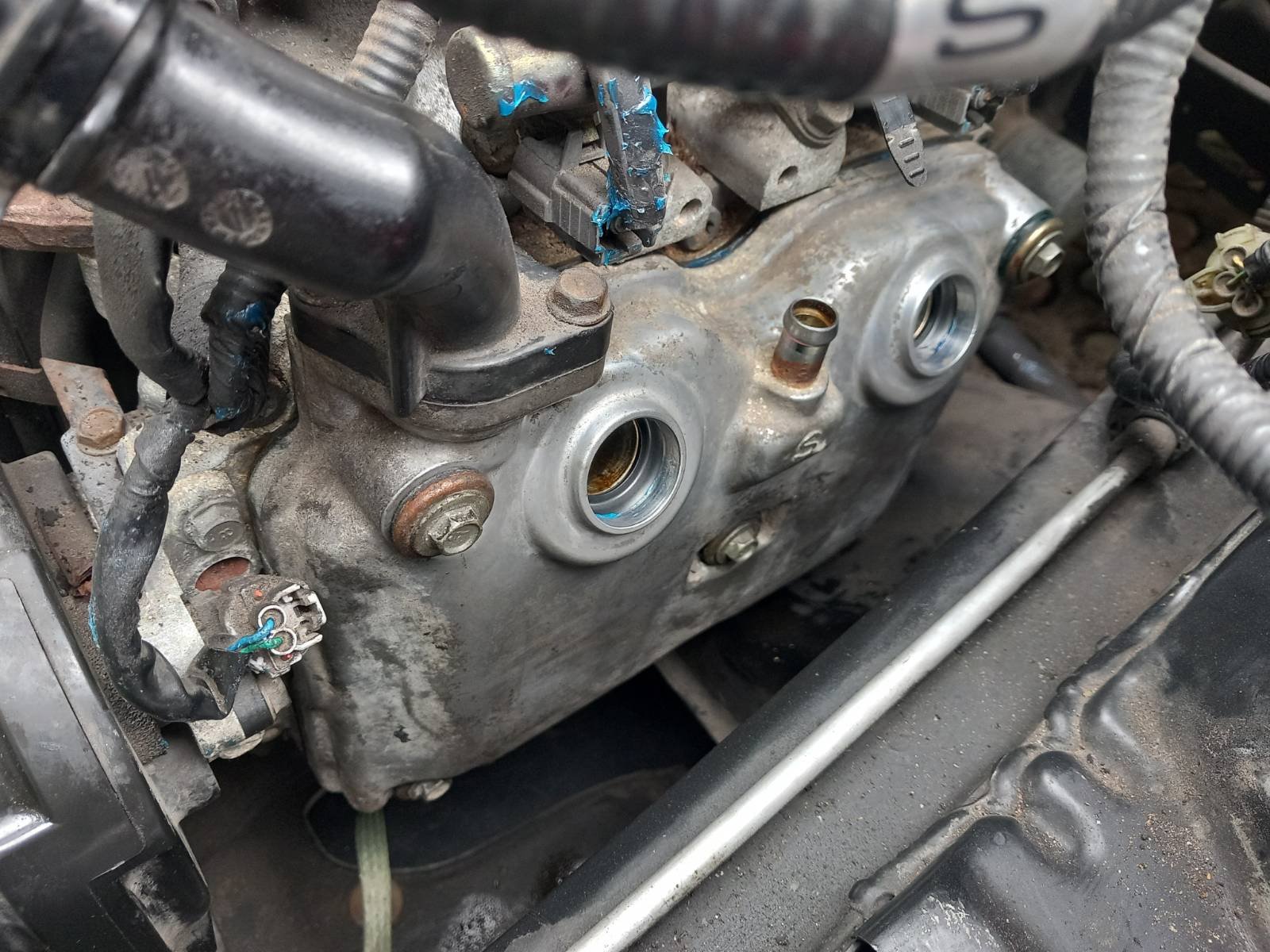

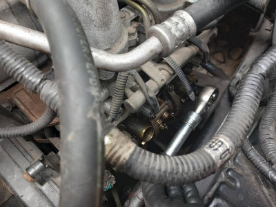

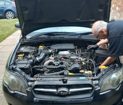

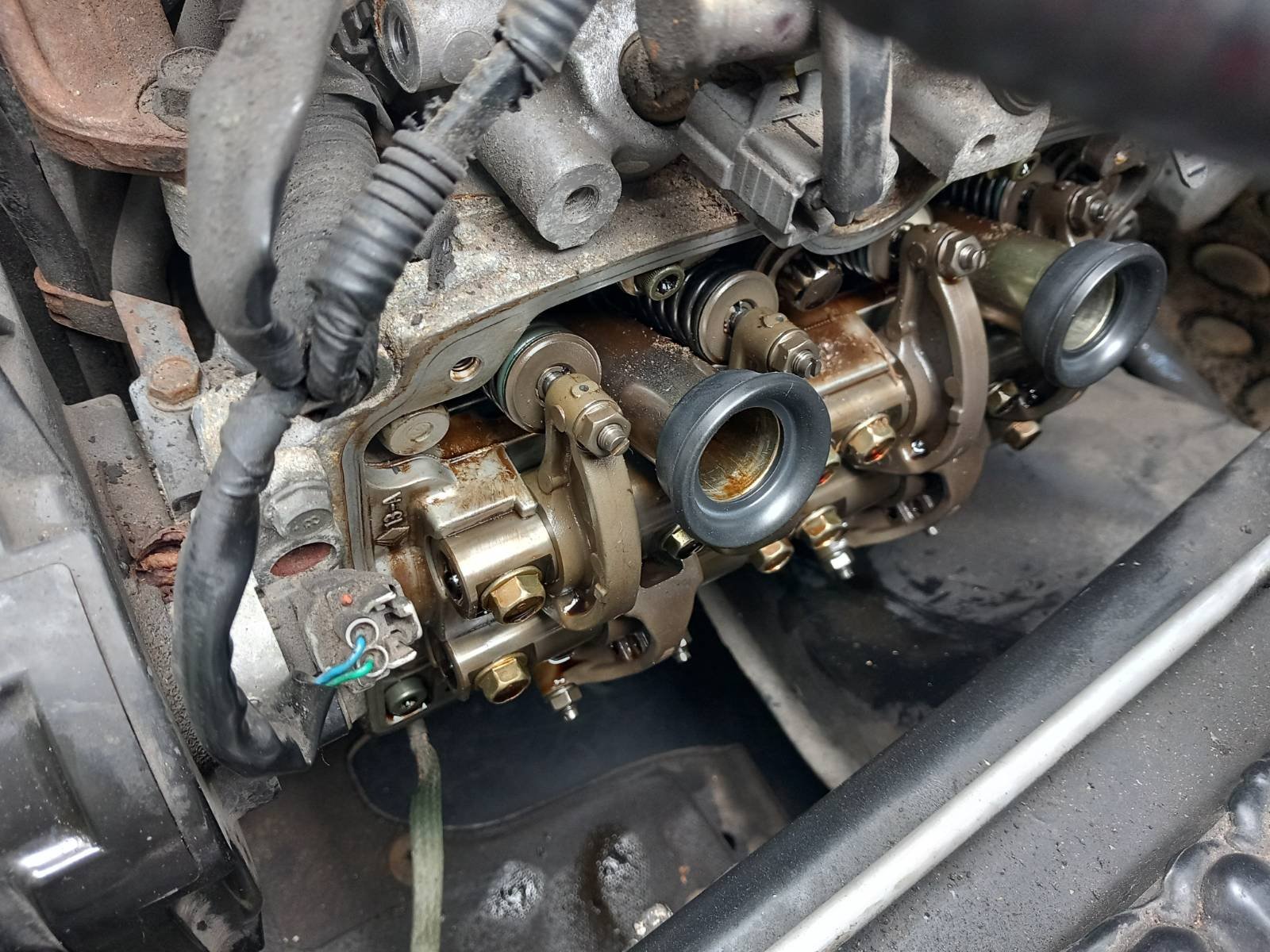

Finally all the parts had arrived to get the Subaru sorted! I rose at 6 this morning to play musical cars and get the C4 off the drive, get SWMBO's car out of the garage, move the Subaru onto the drive in repair position, uncover the MX3 and shunt it back into its normal position, which had been occupied by the Subaru since its demise, and then recover it. Park the C4 behind the MX3 in the Subaru's normal position and finally bring SWMBO's car back across the drive ready for her to go off to her volunteering job!!
Once that was completed I began laying out the tools and started work on the driver's side of the engine. To gain access I had to remove the components blocking the way consisting of the air intake chute, the air filter box and filter, the MAF housing and associated trunking, the plenum box (Jim told me that is what they are called
) which I have always just called the air feed/throttle box, three vacuum hoses from the plenum and the brake servo, the PCV valve and associated hoses and finally the injector cover. With that lot out of the way I was able to access the valve cover bolts and then, having taken off the HT leads, gently withdraw the valve cover.
Jim had arrived during the last part of that process but he was pretty physically limited due to his injury so he set about cleaning the valve cover while I pumped out the excess oil around the plugs using my new, James recommended, oil pump from Lidl which worked very well and enabled me to 'hoover up' the excess oil to prevent it running into the cylinders when I removed the plugs. The plug tube seals were then removed and found to be as hard as steel, no wonder they had been leaking oil into the plug tubes.
Quite pleased in a way, I ploughed on to remove the plugs which I had decided to replace along with the coil pack, even though they were only a few months old, due to their potential contamination! I then installed the new plugs, tube seals and the rubber gasket for the valve cover. I like blue Hylomar so I used it as an extra precaution around the tube seals and the gaskets. I swapped out the coil pack and with the cover and new coil pack installed it was the classic Haynes case of reversing the procedure above to get that side of the engine back to normal.
Then after a coffee break it was time to attack the other side where access was only blocked by the battery, the injector cover and one vacuum tube. Again access is tight and getting to the bottom bolts is tricky but doable. The pictures below, taken by Jim, show the process on this side which is the same basic job as the other side but easier to photograph. Having installed the new plugs, seals and gasket, the cover went back on and all the parts refitted. A quick tidy up of the tools around the engine bay and it was time to start it and run through the idle learning process necessary whenever you have disconnected the MAF. I got in the car, turned the key and heard the engine turning over, but no firing at all. In only 4 or 5 attempts the battery showed signs of failing so it needed to go on charge.
Time for lunch and a think!! We popped inside and washed up and headed to another of my favourite pubs, The Sibthorpe Arms in North Mymms, to consume an excellent lunch!! We both agreed that there had been no firing sounds at all so the components I had changed for brand new were Coil Pack, Spark Plugs, and HT leads. I had only disconnected two connectors, coil pack and MAF and both were firmly refitted. So we agreed highly unlikely to have 4 new faulty leads or 4 faulty plugs so the main suspect had to be the coil pack, or just possibly insufficient power in the battery. The plan was decided to change the coil pack back to the old one and try again!!
On returning home SWMBO had just arrived back to find her car still unable to get into the garage so Jim went in and engaged her in conversation while I swapped out the coil pack. 15 mins later it was time to try again so gingerly I sat in and turned the key - vroom vroom!! Instant life so I then went into the idle learning program while we cleared up the garage ready for re-occupation. Once the learning was complete I reversed the car out, and even in doing that I could feel the power back in the car, in fact far better than it had been for a considerable time without me really noticing it due to a very gradual decline!!.
After that, and Jim had headed home, I went for my usual run to Elstree to see how it would affect my ongoing "Which car to keep" dilemma. Within a few minutes my mind was made up about one thing - I'm keeping the Subaru
Now I just need to decide which will be my second car!!

Absolutely excellent Mick and a perfect write-up
It reflects the day absolutely perfectly and yes, the Sibthorpe Arm is highly recommended. The great food and friendly staff has rocketed that pub very high up on my favourites list!
I'm absolutely delighted the Subaru is now back on top form.
My apologies I was more or less useless and could only do light duties and talking; I hugely enjoyed my day out and Strawberry performed brilliantly both to and from yours
And thanks for taking my mind right off my current difficulties for a whole day
