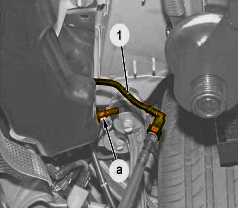

Remove the protector under the body (rear left hand side).
Uncouple the pipe (1) ( as "a").
Couple the additive container to the tube (1) using the adaptor and pipe (with tap) from the filling kit.

Thanks Marc and Wheeler. I’m really sorry, but I am total idiot
Does the photo above show the connection removed with the additive kit connected ? In which case both of your advice is the same ? I’m sure your both currently banging your heads against your computer thinking “ is this guy stupid”. The answer is yes
- x 6950
Re: Eolys?
Yes it does, Pipe (1) removed from (a) and shown connected to filler kit.
