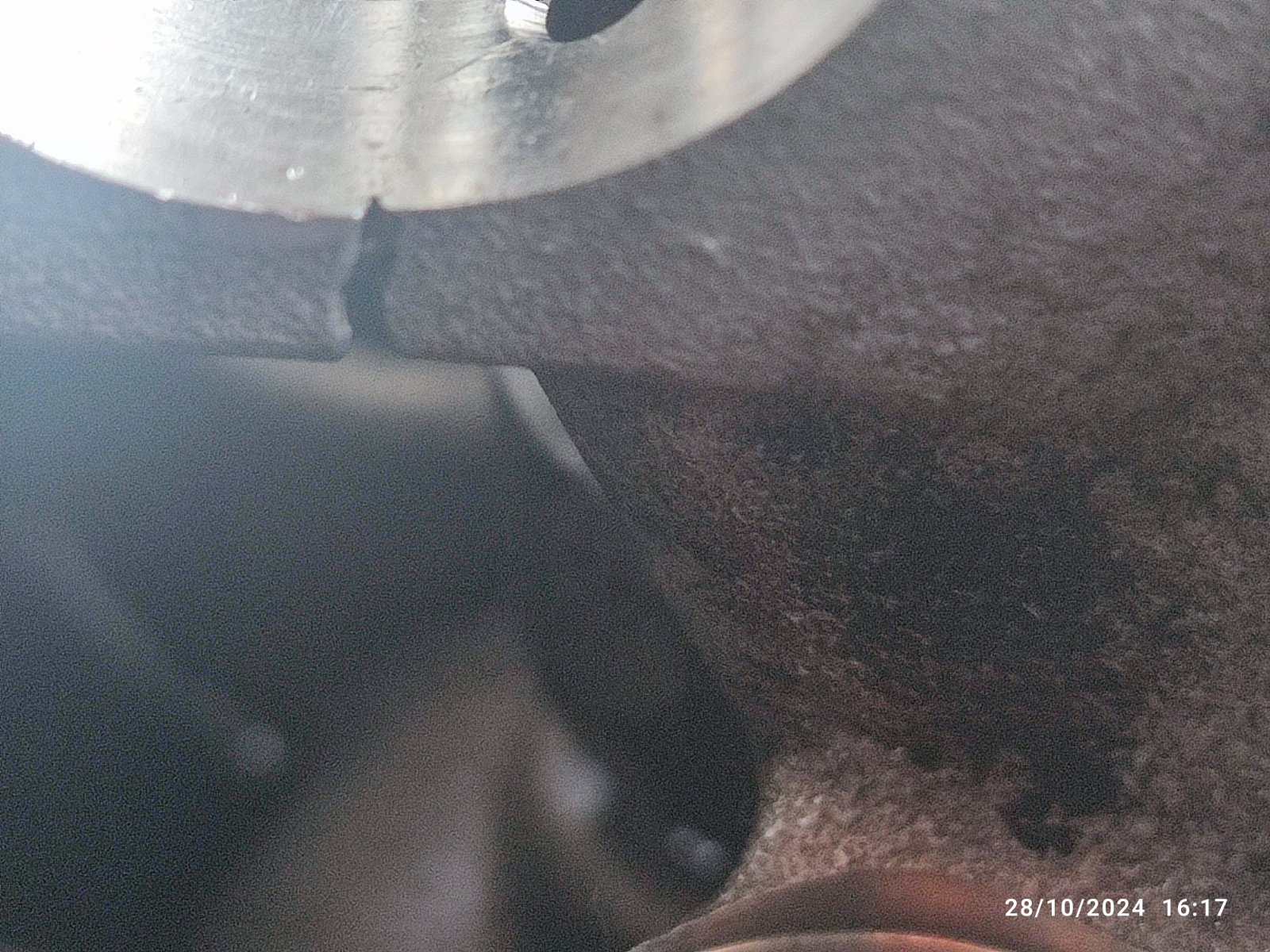

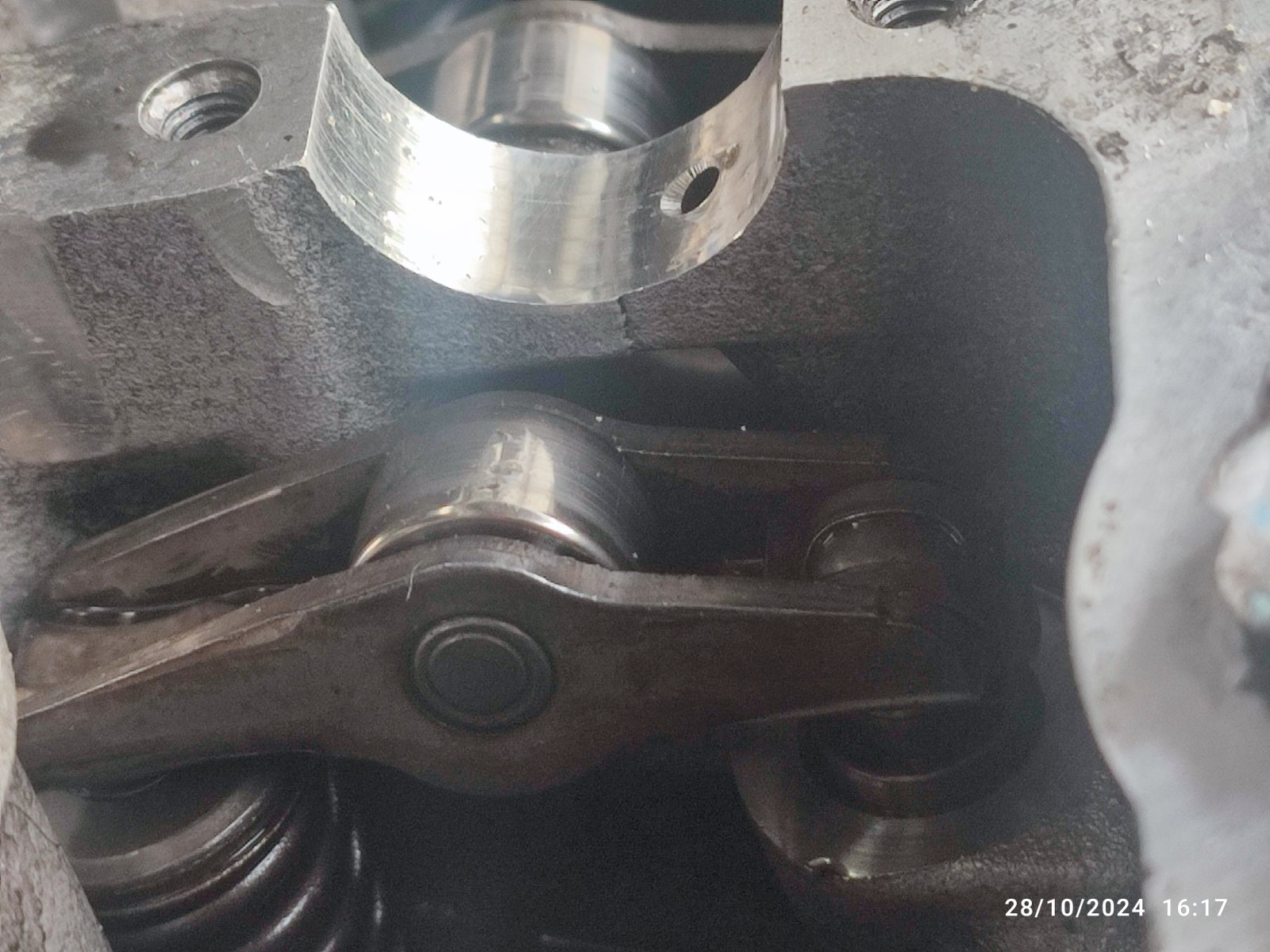

Just discovered this. I think I need a new head. More money, I'm sick of this car.what could have caused this. I don't know how I missed this.

Is it definitely a crack? First picture it looks as much a weird casting mark.
Can't see any sign of the crack on the camshaft bearing surface, I'm not sure if you can get some sort of dye that'd be drawn along a crack (capillary action) to confirm it?
How does the camshaft look in the corresponding position?

If you pull the rockers out the way, put the camshaft back (and bearing caps) = does it turn freely? (rockers out the way, no valve spring interaction to contend with.
I agree with your earlier thoughts that cam timing was unlikely to have been that far out (as to have valve/piston contact) - but try the valves either side of that bearing position= do both travel up and down their guides freely? (Thinking push down with screwdriver in the valve stem, let spring pull it back up again)

Hi Matt I had written a whole post in response to you but it didn't save. Cam looked ok but I will inspect further tomorrow. I will post pictures to get your opinion but I think they are good. I thought it was just a casting as well. I have a usb microscope it might show something.Cam looked fine but I will reinspect tomorrow felt very demoralised earlier so just walked away for today and decided research was now required. I will check for free rotation. Glad to see no evidence of damage due to timing and thanks for supporting my hypothesis. I will check valve travel as you have suggested to see if there is any binding. What are your thoughts on repairing that journal casting? I will enquire about the dye testing.

I'm not sure what could be done if it is a crack - welding oil sodden aluminium isn't going to be much fun and would likely distort the bearing surface. That'll be "line bored" with the other cam bearings so it's getting a bit complex.
If it is a crack, it's an odd one as if you think about it, the rockers are pushing the camshaft up (into bearing caps) not down: onto the head, so I'm not sure what'd instigate the crack in the first place.
Assuming cam runs freely, I'd be tempted to slap it together and see how it goes. Alternative of seeking out a second hand head or costly new one neither palatable really.
