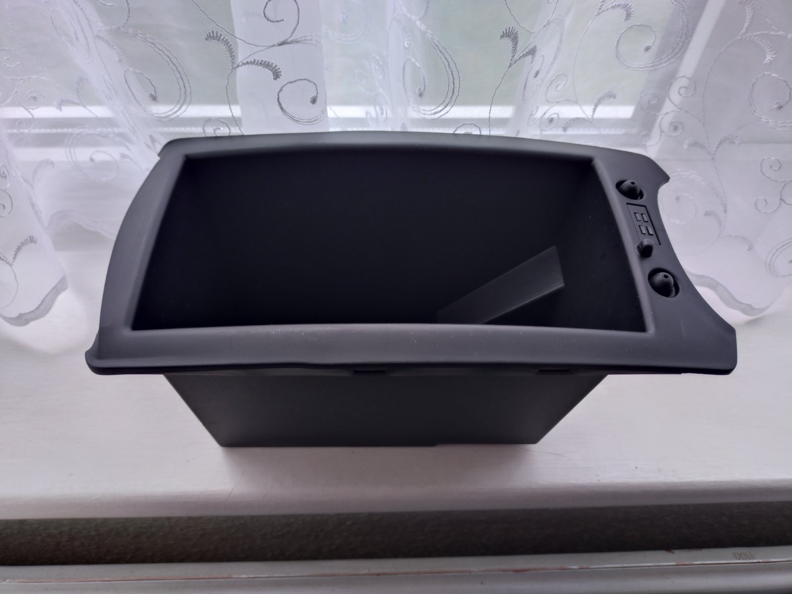

Well I am impressed, having got the part number from Marc on Thursday for the armrest box I found one on ebay priced at £18. I offered £15 or £20 if he could get it to me from the midlands by today!! Need I say more?

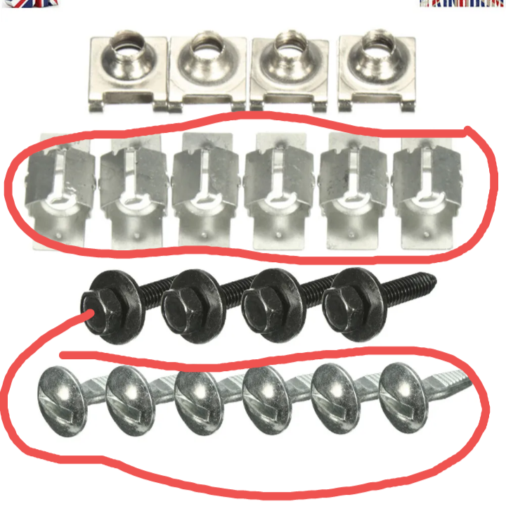

On that note: I hate these things! They always seem so half hearted and inspiring no confidence!
I'm actively going out of my way not to use them and find other means each time I come across them!
- Posts: 21060
- x 8085
Re: DIY Car Maintenance with function over finesse!!
I used them on the undercover as all the parts were brand new and once I got the hang of inserting the 'keeps' I found them very secure. Have to see what they are like to remove if I still have the car then!!

I agree with Matt, they would be a regular service item that would have to be replaced at every service, as they would go missing!
I ended uo converting the positions to accept self-tappers into a smalll plastic inserts.

Yes, guess if treated as single use them maybe just about ok.Sloppysod wrote: 28 Jul 2024, 10:33 I agree with Matt, they would be a regular service item that would have to be replaced at every service, as they would go missing!
I ended uo converting the positions to accept self-tappers into a smalll plastic inserts.![]()
I've gone for M6 rivet nuts (then M6 bolts and penny washers) as my go to alternate

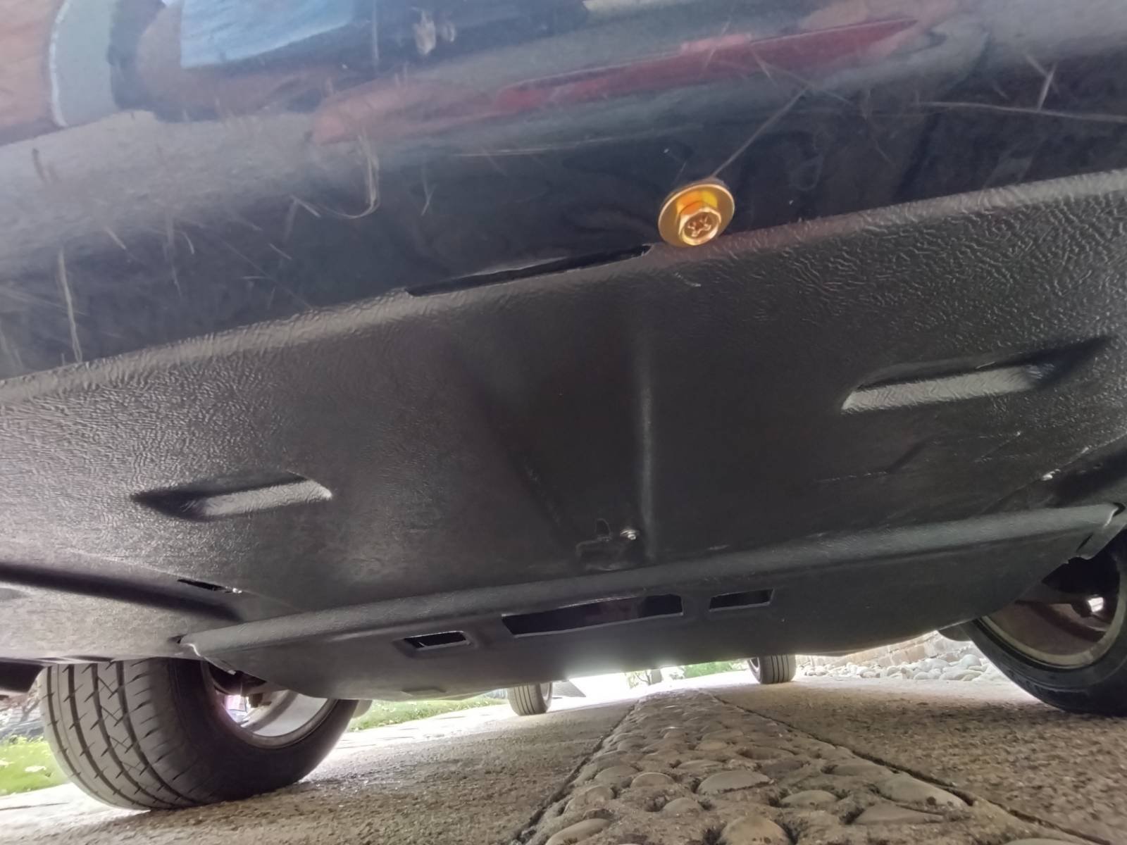

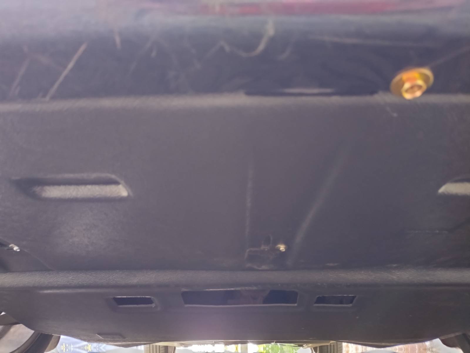

So having sorted the parking sensor yesterday I decided to tackle the undertray today. I'm afraid there are no pictures until the end because I simply forgot to take any!!
First job was to remove the two side pieces remaining from the original cover involving much twisting, cutting, unscrewing and yanking but eventually they both resigned and took the first part of their journey to the bin, I dumped them on the drive!!
Then it was a matter of holding up the new undercover to check fit and fixing points and I was impressed to find that it fitted perfectly with all the mounting holes lining up perfectly with their corresponding fixing points. Then came much frustration as I tried to hold it in place and secure a fixing to start from, but it proved unwieldy so it was out with the clamps. I have about 14 or so but this job only needed five to hold it securely so I could install the 12 mounting bolts/screws/pegs to complete the job. This is what the new super ground effect floor looks like now:
