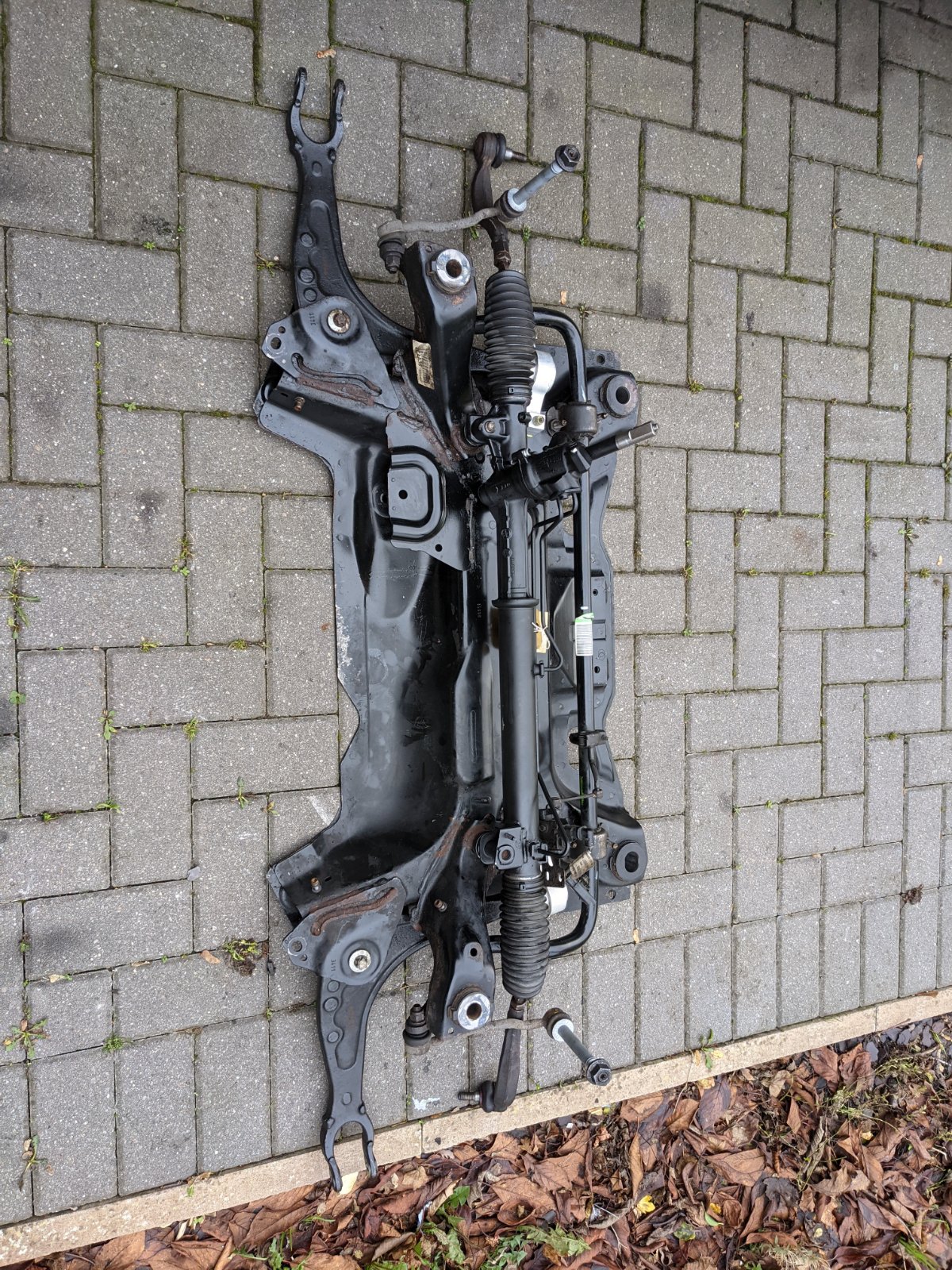

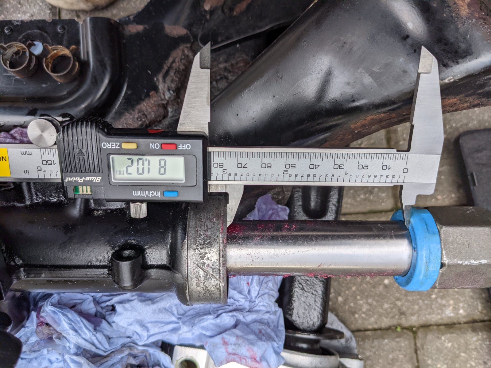

Hi all,
Just got a recondished rack from Lionautomotive this week.
Took the gaters off to see if spacers had been fitted for the 19’s and clocked the rack up to center 81mm, +- 1mm, each end.
When I spoke to them, I was really concerned about what oil they used when building the rack and for testing it.
They said it would be fine but, the oil coming out of the new rack is red…
Everything in me is saying not to fit it. Not even if I have to waste ££ of LDS oil to flush it…
Help...

If you are going to flush it Adam, obviously do it before fitting as you won't want to be contaminating the suspension system. I can almost guarantee they would not of been using LDS for testing given the price of it, so I would find something you can use to flush it through, dry it out as best you can and then fit it back on the car. When you've done that and bled the hydraulic system / Steering and left it for a week or so to circulate the oil, I'd consider draining the LDS and refilling it with fresh fluid.

hi Adam, I flushed mine, was easy, just have a bowl underneath! I don't think I replaced the fluid as such, just got rid of what was in there
I suspect they put normal PS fluid in and I wasn't taking chances.
also, before fitting :
I cut the thingy off, painted the new bare metal, painted and then greased the pinion shaft with heavy grease, then used part of a track rod gaiter from the old rack as a cover.
I had my tracking done yesterday, and popped under to look - all dry so far! (its been about a month now)
