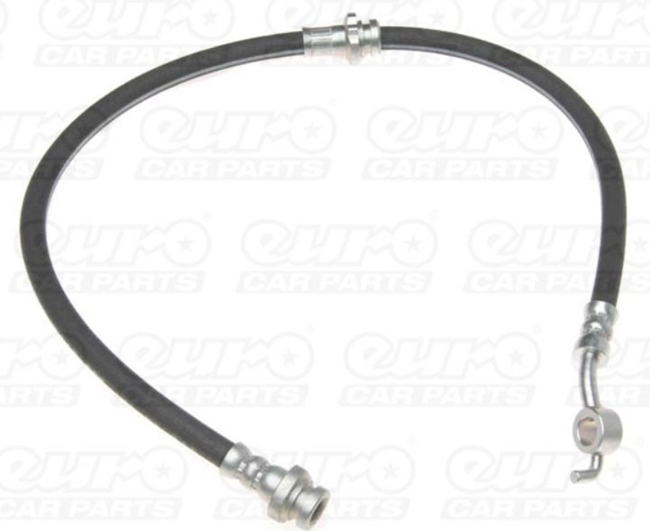

Doing some more shopping at carparts4less.
Flexible brake hose to sort the rusted ferrules. Micra's is like this at the front
£30 after discount at ECP, check every time but there is an Extra £6 discount if you order through Carparts4less
and you can collect it from ECP, which I have chosen to do this time to save wasting a day or 2 hanging around for delivery which would be free and which I would normally use.
So far I have had none of the woes of others sometimes expressed on here quite the opposite. I find they are unbeatable on price and well suited to the this BB motorist
They obviously both have a sale on all the time and both have discount codes to use to get the cheapest price.

Here's a Haynes "two spanner" degree of difficulty job bordering on the one spanner. Replacing a front brake flexible hose on a Micra.
Of course I don't want to have to put a post in this old chestnut of a thread, so I will be looking very closely at the condition of the item before I attempt any undoing.
Ever Sheared off a Bleed Nipple? https://www.frenchcarforum.co.uk/forum/ ... hp?t=53542
* The points at which the simple job could well ascend the degree of difficulty scale. Got the part yesterday, but gave the unions a fair drenching in GT85, without attempting any undoing, and put it off to another day.Ensure master cylinder is full

REgards NeilNewcastleFalcon wrote: 01 Aug 2022, 20:25 Flexible brake hose to sort the rusted ferrules. Micra's is like this at the front

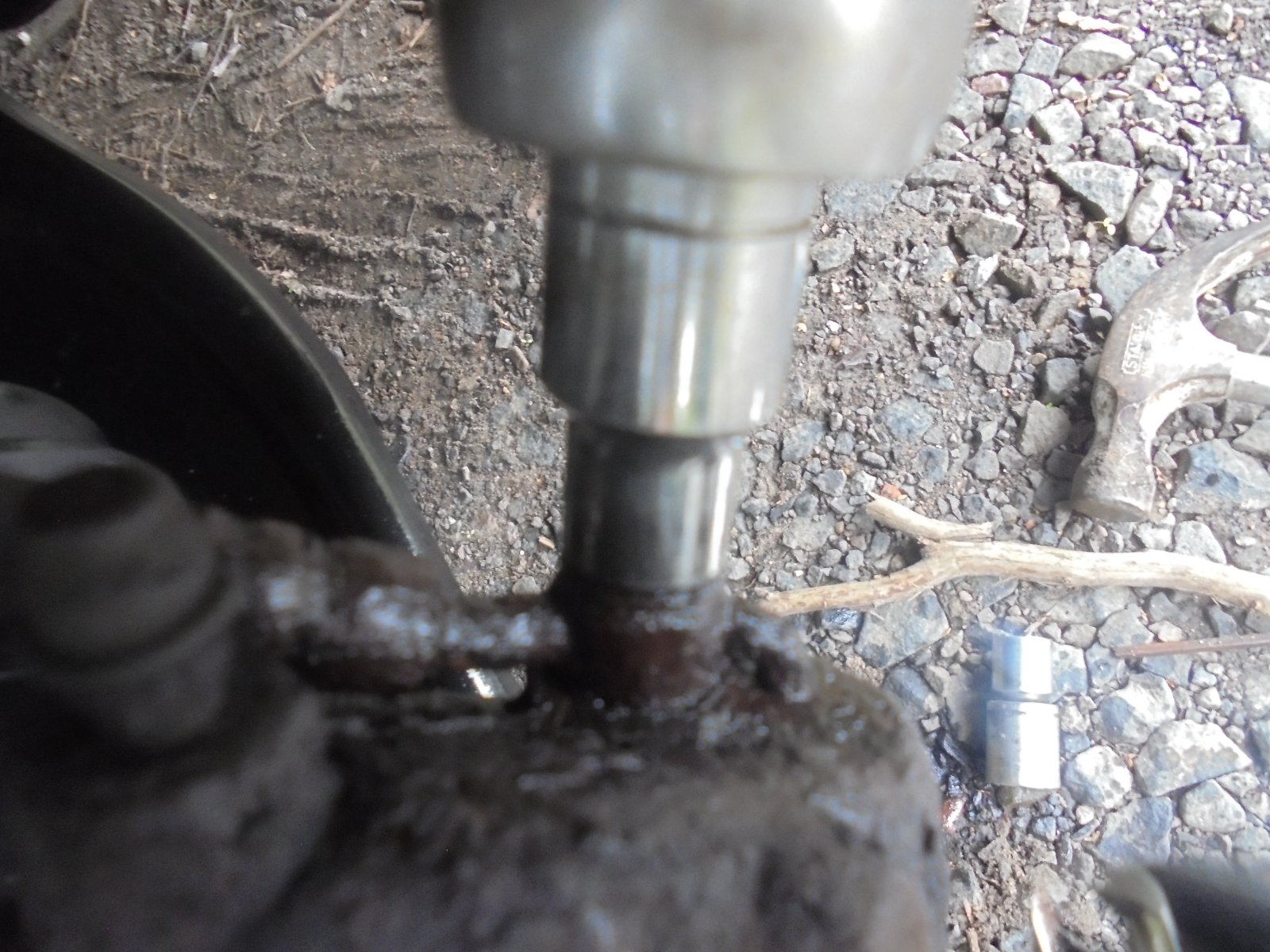

Optical illusion.
Curled up brake hoses in a packet look much shorter than the hose you need. Before opening up the packet, and maybe facing a bit of hassle returning it if it indeed was the wrong length, I measured it with a clothes line, on the car, and in the packet and it appears to be roughly right. Old favourites number 1,
hammer on an undersized 11mm socket to the 12mm bolt head for which a 12mm socket is too loose. Worked again... caliper end bolt slackened.
That's enough work for now, have a cup of tea. Motivation to get on and finish the job is a bit lacking, one step at a time, let the minor success have its moment to be enjoyed.
