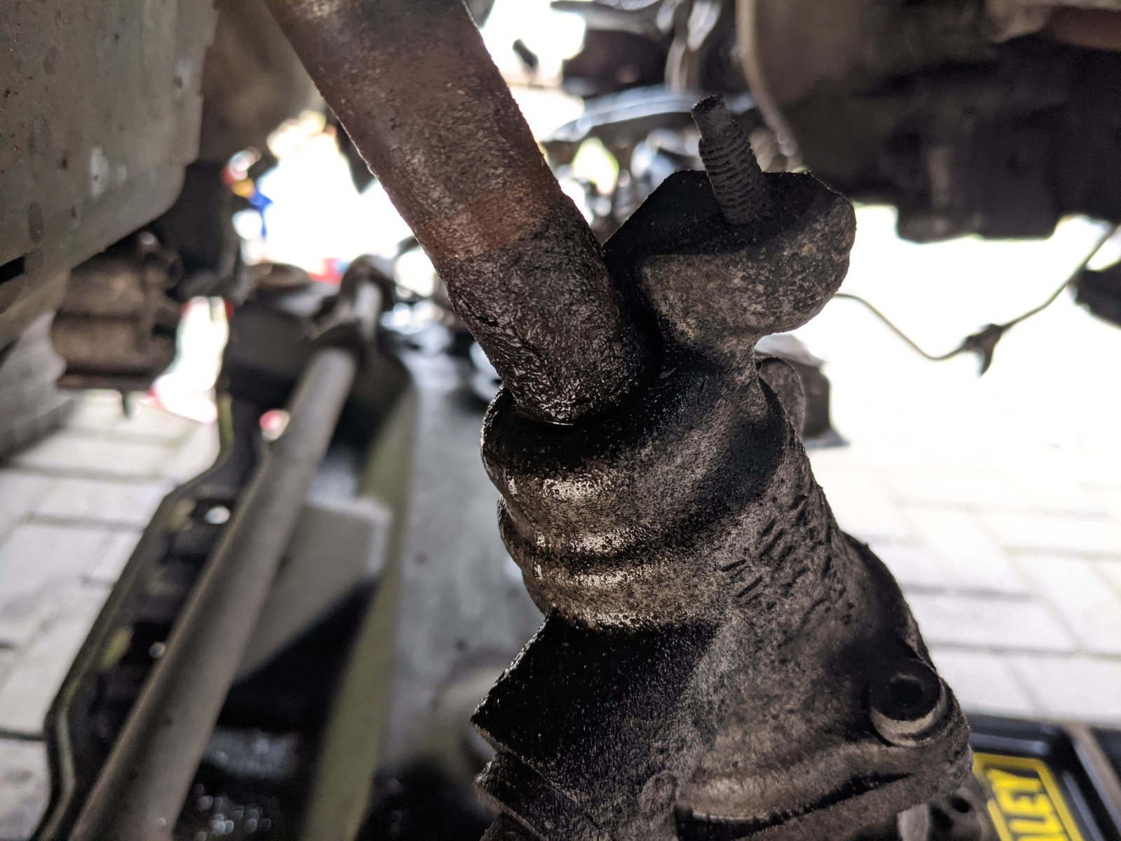

Just removed my rack.
How have the Viton orings held up?
I'm thinking I have two options.
1. Attempt a repair/modify of the pinion shaft and housing with a new seal.
2. Buy a refubished rack. (https://www.ebay.co.uk/itm/Citroen-C5-P ... 3458338664).
Adam.
Adam.
- x 6945
Re: C5 X7 Steering Rack - Again!
Well sorry to see that Adam, but it looks like yours won't be too far off going!
All I can tell you is I bought mine from Autosteer and it is doing fine. I can't help but feel nothing but anger towards PSA for this fiasco and if we were in the States, they would of had to have recalled all these and replaced them by now given the numbers of failures - it's just unheard of.

Hi Marc,
Yes It's a bit annoying after all the front suspension work I did earlier this year, £££.
Covid hit, didn't drive the car for 4 months. Hardly added any miles since.
Saw an oil mark on the road and thought I pinched the gearbox seal when I removed the passenger drive shaft. Nope wrong side… Jacked the car up and saw LDS oil all over the drivers side of the sub frame.
How have your Viton O-Ring’s been doing? I’m about to order some.

I completely lowered the subframe this afternoon with the anti roll bar removed also. Then I removed the rack from the sub frame all together. Removed most of the pipe fastening clips so that I could gently pull the rack paritaly out the driver side, (pipes still connected to the rank). Popped a bucket under the rack ready with plastic pipe blanks to immediately block the pipe ends.
The rack is now off the car, I blanked the holes and pressure washed it with the subframe as both were covered with oil and grime. It looks like it has been weeping for a long time.

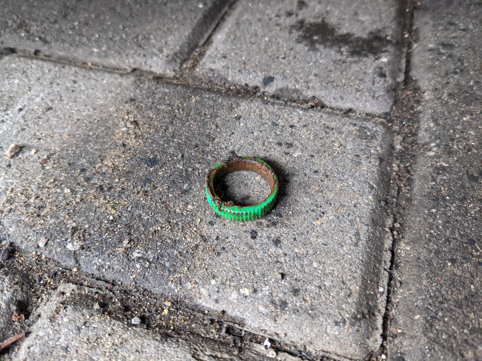

It’s not too much of a bad job and it is not fiderly. I dread to think if the turbo went, it’s right up in there... I just got really annoyed when I broke both of these stupid plastic nut clips for two of the main subframe bolts.
Adam.
