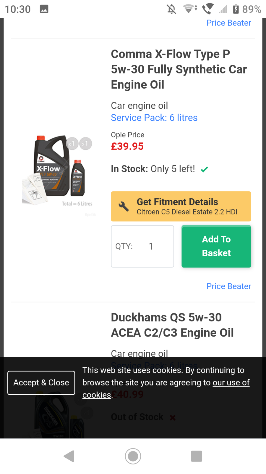

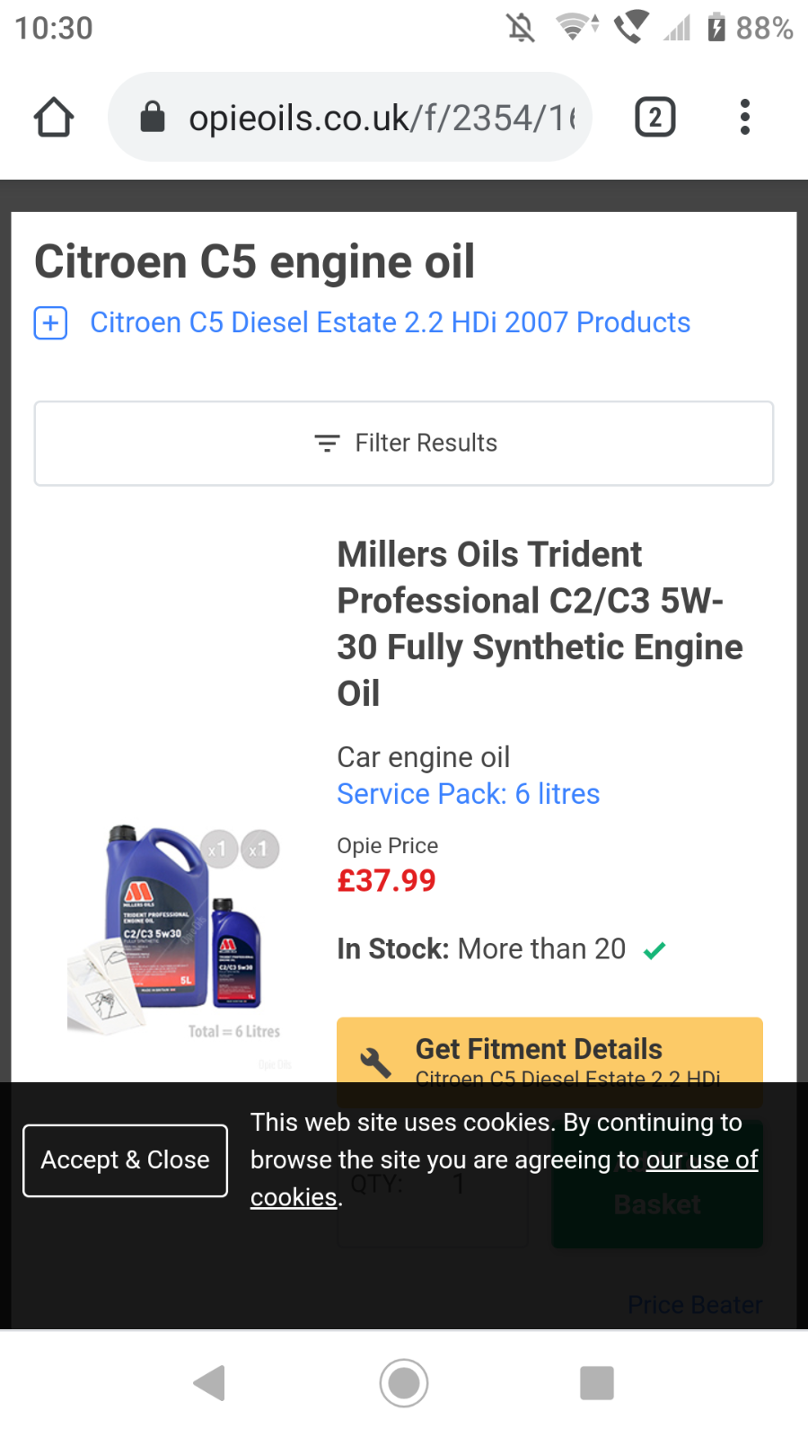

Re: My turn for a C5!
James a quick look on opie oils with your reg..
So fully synthetic 5w30.. Wasn't far off there.
