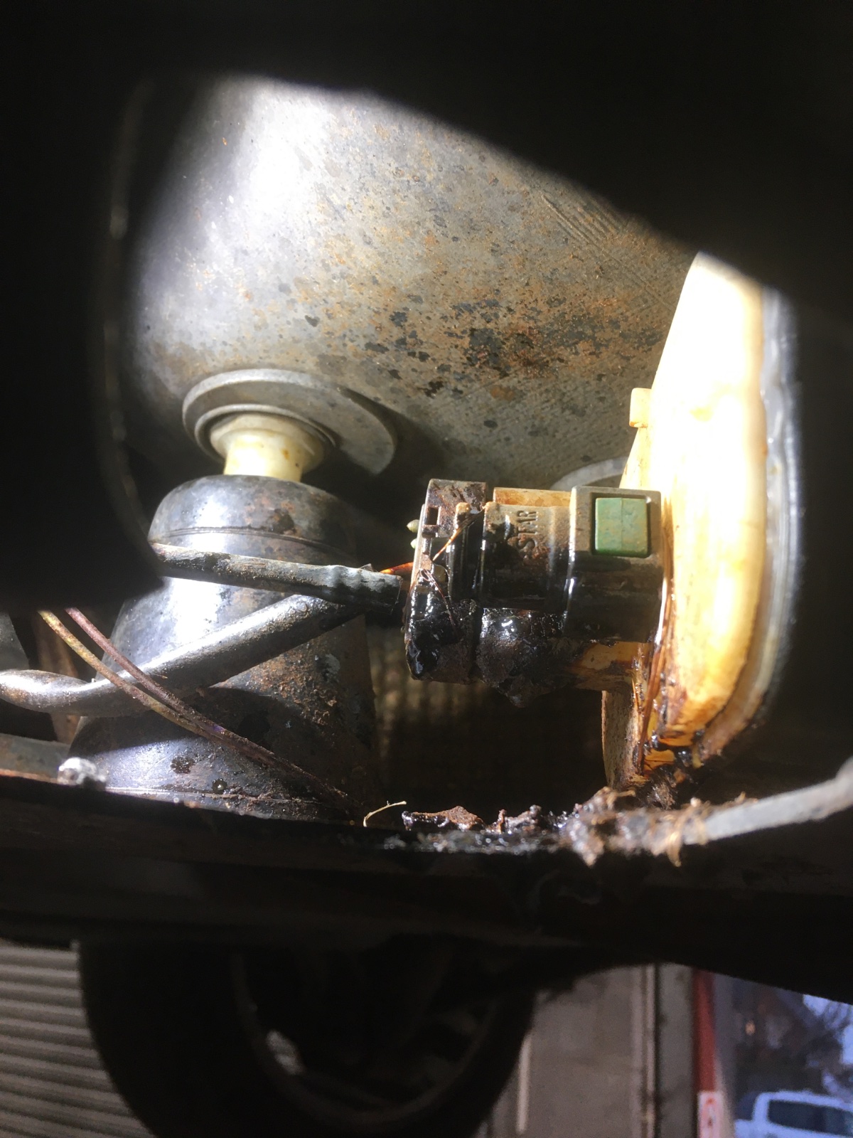

So I finally got u see the car and the connection is snapped at the hose. Trying to locate a part in breakers yards but I’m guessing it’s fat to small for a reliable repair, if anyone knows anyone breaking, it’s a 2009 2.0 hdi
Not sure how to attach an image here but it’s right where the pipe joins the connection with the green push buttons to remove.

Thank you myglaren, image attached, taken by myself with no copyright issues
I’m thinking of cleaning the pipe and connector with degreaser and then alcohol cleaner, and then supergluing the broken connector back in place, then when set, heavily reinforcing the surrounding area with JB water weld putty or similar ?

Only way to repair that is to cut it off and fit a new one. You can probably buy the bits, but it may be easier just to get someone who has a kit to fix it. Don't know where the other end is, you might be able to take it off? Otherwise splice a new bit in on the car, might be possible just to fit a new end if there is enough slack.
